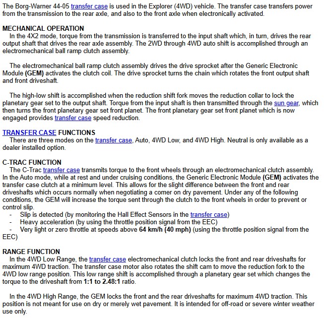

I’m curious now if the gen 2 Explorer had it at all. If it did, it would theoretically be possible to convert a 98+ Ranger to have it…
2nd gen V8 Explorers had 2WD or AWD. 2nd gen V6 Explorers were available as 2WD, A4WD, and maybe straight 4WD. To install the 2nd gen A4WD system on a similar Ranger would require the entire transfer case because it has a clutch that the normal 4wd does not have, It would also require the entire control because there was coding and/or sensors that did not exist in the Ranger. Even with all of that, you would be in uncharted territory.

Full time would have to have a center diff in the tcase. Mere moral part time tcase is chain drive.
Wasn't arguing anything about a fulltime AWD case, just stating the drive modes offered. The BW4406 found in the V8 Explorer (as well as both my and lil_Blue_Ford's Rangers) use a viscous coupling in the transfer case to allow for speed for slipage between front and rear end. The BW4405 found in the A4WD system uses a clutch instead of the viscous coupling.
"In the 4X2 mode, torque from the transmission is transferred to the input shaft which, in turn, drives the rear output shaft that drives the rear axle assembly. The 2WD through 4WD auto shift is accomplished through an electromechanical ball ramp clutch assembly.
The electromechanical ball ramp clutch assembly drives the drive sprocket after the Generic Electronic Module (GEM) activates the clutch coil. The drive sprocket turns the chain which rotates the front output shaft and front driveshaft."
About what I figured. Uncharted territory and a bunch of work, but potentially possible. I’m not worried about it for my green Ranger because it’s staying a lowered AWD and I don’t see a need for low range on a street toy. But may be an option for someone wanting to keep low range and still be able to get maximum traction.
