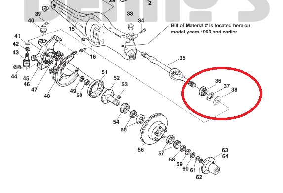

Can anyone provide a part number for the three items circled? Items 36, 37 & 38. Any reference to a RockAuto, Advanced, Autozone, etc... would be helpful.
I took my shafts out and nothing but the steel ring of the seal on one side and the other side looks like a rubber seal tore into two rings and there is a plastic disc about 1/8" thick with a slightly raised portion on each side, just a couple thousandths thick. Not exactly sure what I need based upon those findings.

We are on parallel paths. I'm at that same juncture.
36 — (2) Slinger
37 — (2) Oil Seal
38 — (2) Spacer – Wheel Bearing Spindle
But no numbers. I can guess at the seal from what's available at Rock, but IDK for sure.

Edit: The more I look at the Spicer parts list and understanding their BOM. The listed numbers below are for '92 nd older, most likely Dana 28. It looks like the Dana 35 may only have an oil seal item 37 p/n 50492. Maybe the parts that fell off mine are a destroyed 50492?
Spicer 50492 Drive Axle Shaft Seal
I found these Spicer p/n's
Item 36 link
Item 36 - Drive Axle Shaft Oil Slinger
Item 37 link
Item 37 - Drive Axle Shaft Seal
Item 38 link
Item 38 - Steer Axle Wheel Bearing Spacer
Here is the Assembly w/p/n's.
Ford Model 35/194 IFS Parts Listing
