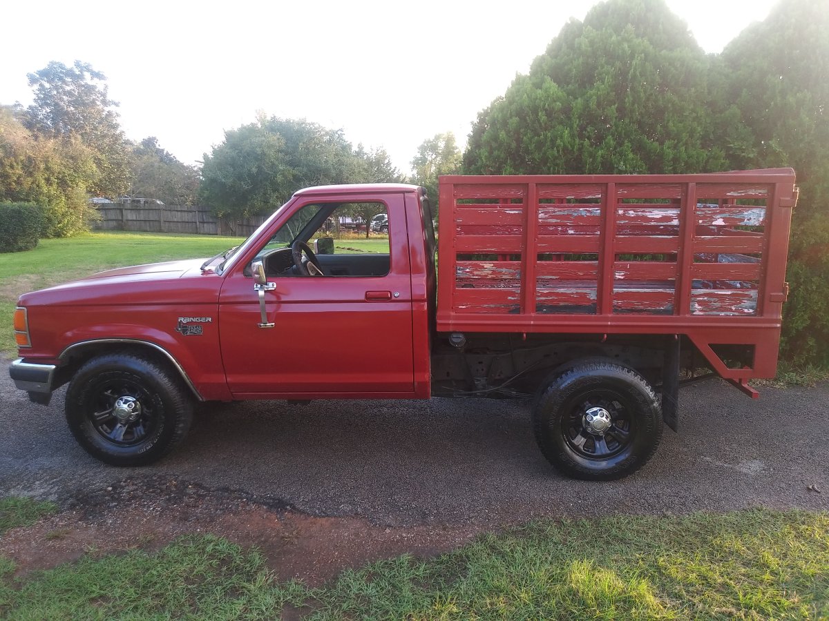

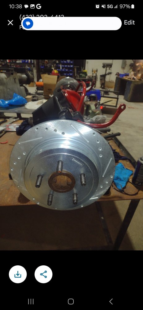

I have put an 8.8 out of a 02 Sport Trac with rear disc under my 92 ranger reg. cab 2wd. It has 411 gears and I installed a new Ford Trac Loc LS. I'm preparing to slap in a 240hp 325 torque carburetor crate with an AOD..wish me luck...lol
