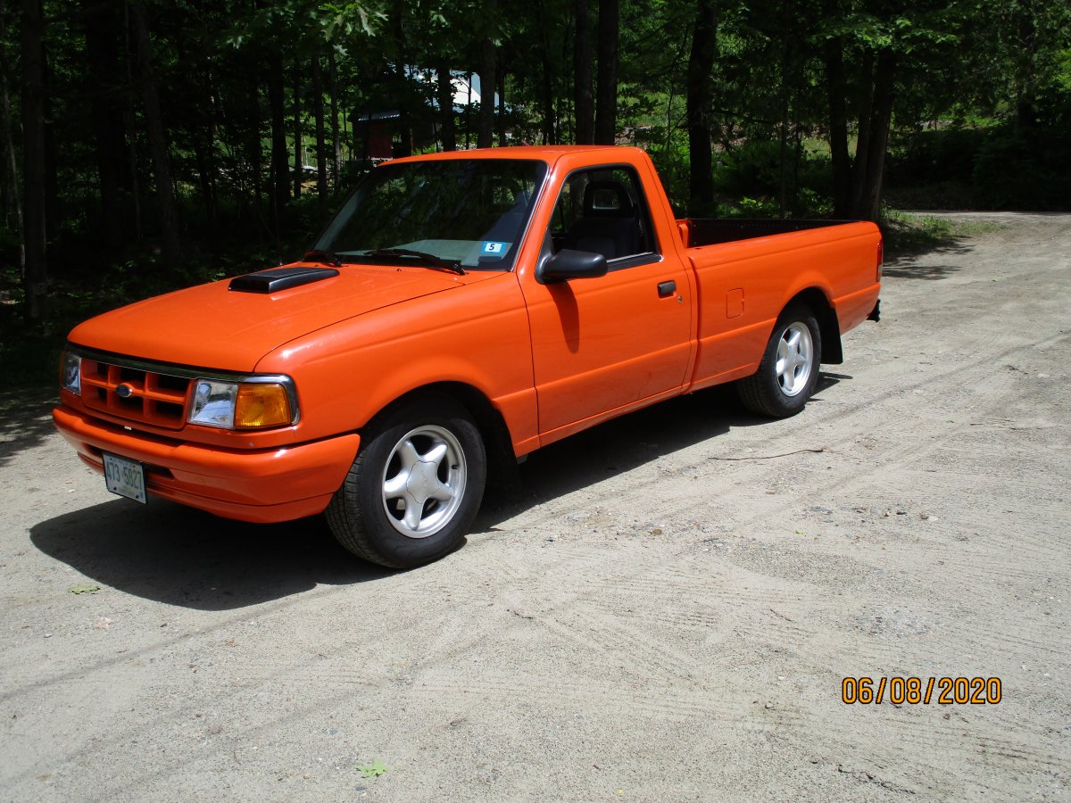

94-5 Mustang wheels with 235/65r16's. Truck is lowered.

I have 01 mustang 16x8 "cobra" wheels on my 97 2wd with 245 50 on all 4. Fits fine with no rubbing.
