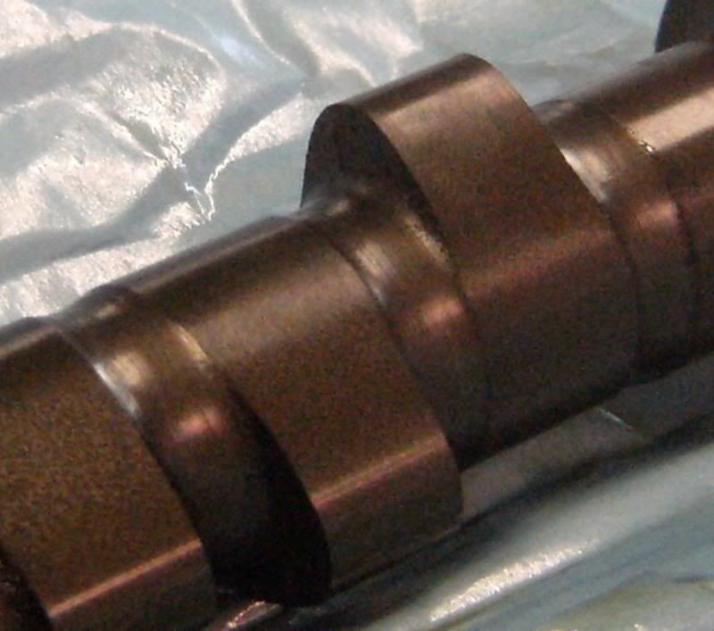

anyway, here are some pics of the shaft that was reground.
http://i109.photobucket.com/albums/n69/ru_ready_4_r_n_r/reground.jpg
http://i109.photobucket.com/albums/n69/ru_ready_4_r_n_r/regroundprofile.jpg
http://i109.photobucket.com/albums/n69/ru_ready_4_r_n_r/regroundcu.jpg

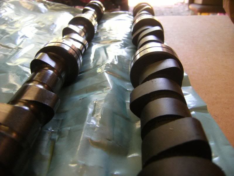

now here is a pic comparing my ground cam with a fresh brand new out of the box later model 2.8 (the same cam that you guys are running)
http://i109.photobucket.com/albums/n69/ru_ready_4_r_n_r/regroundcomparisons.jpg
I was scrolling through CL the other day and I come across this ad saying for sale, brand new: timing gears, HV oil pump, cam, lifters, fel-pro gasket set. the price was great, so I phoned the fellow. he had these in basement sitting for 8 years, sold the truck eons ago and forgot he had the parts. I will be using the gears, oil pump, maybe the lifters. I have no use for the camshaft. I will be talking to the guy at the cam place where I had the shaft ground to see if I can use the lifters with the shaft. if not I won't be using them either. I will be selling the cam, now here is where it can get very interesting for you guys if you are building up a 2.8 for your truck. I can sell you the new cam and I can take it to the shop for you and you can tell them what type of custom grind you want on your new custom shaft. I am just throwing this idea out there for you guys to think about.

Hit a small snag on this motor build. The standard main bearing size is hard to find. Cleavite doesn't make them any more, Mogul stock is hard to locate. So I have 0.020 US going into the crank and the crank is at the shop getting ground down... arrhg small set back that will cost me a few days on the build. I am not sure if the later year main bearings are still around in standard, or if it is just the older cranks that are discontinued. just wanted to toss this out there. Placed in the reground cam, she went in nice like a tight fitted glove. can't wait now to get the crank back and stuff in the pistons.
