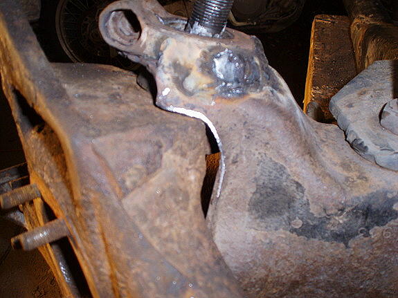

has anyone seen any fatigue in this area? especially if not welded like so:

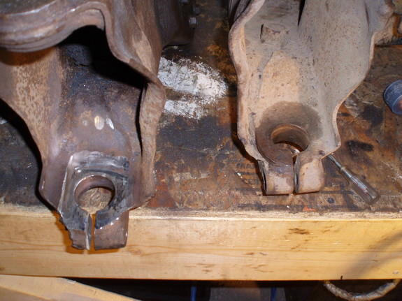

(also taken from tech library)
I believe the adjustable bushings might be the same. Could be wrong though
That cut is nessessary to get a decent clearance for the upper ball joint boot. Squashing it more than needed will wear it out, or pinch the boot, and will result in a failed ball joint. The welding of the upper ball joint bushing mount is mediocure at best from ford. There are just 2 welds about 1" long on each side. I added extra plate around this area and welded the block on all 3 sides and also welded where it was cut on the opposite side. One other thing to note was that the slot in the block was made wider on mine. The F150 bushing is a fraction smaller than the RBV one and this just helps get a good clamp on the bushing. The bushings are not the same. The D44 uses a taper on the upper ball joint. D35 is a straight pin with a snap ring.

hey joel, got any close up pics of the brace/welding specifically around that upper ball joint?

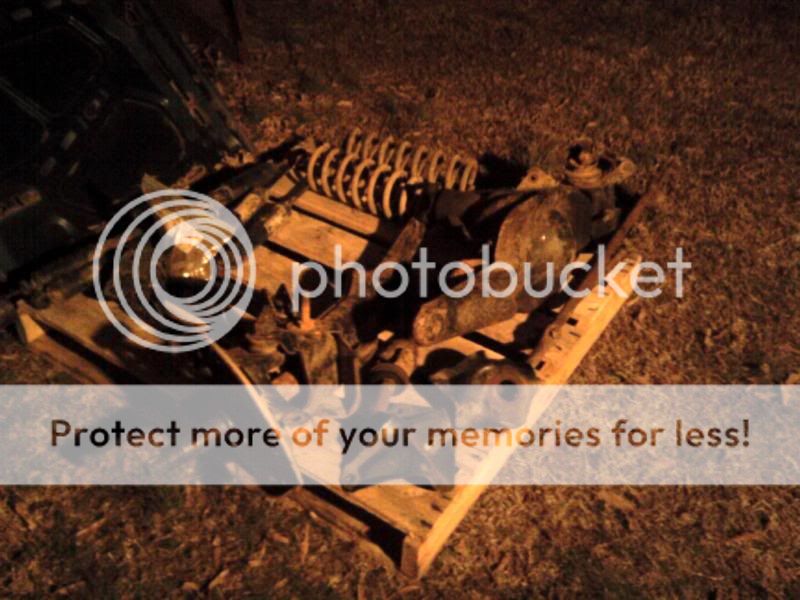

got most of the parts i need, a bunch that i don't. thats ok, everything on this pallet was free.
anyone other than todd done 35/44 hybrid?
its got some weird coil seat thing that has what looks like a tab for a second shock in front of the beam.
