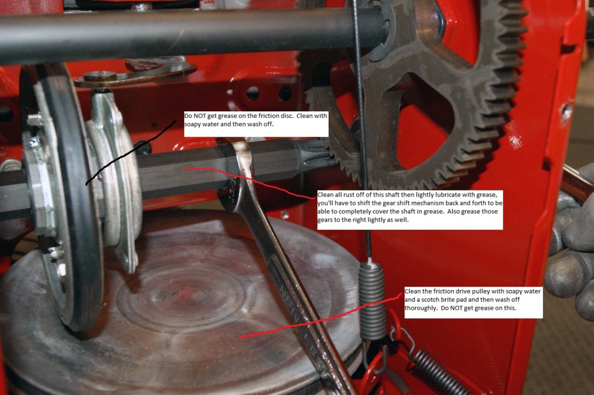

You'll need to get the cover off the bottom of the machine where the pulley and shaft system is. Clean all the rust off the sliding shaft where the rubber drive disc is then apply a very light film of grease, you don't want it flying around under there getting on the drive pulley and drive disc otherwise you'll completely lose the self-propel portion. While you are under there after you get that shaft cleaned up and greased, take a scotch brite pad and some soapy water and clean off the drive pulley (the large silver one that the drive disc makes contact with).
Attached picture with lubrication points and cleaning points. Hope that helps.
Link to video example of lubrication points as well as wheel removal and lubricating axle shafts.
about 3:50 minutes to about 14:00 minutes for reference.

I sprayed white grease all over under it now it barely moves.
Im gonna get some brake cleaner and rags and clean everything back up good. It should be fine. It still moves a little bit.
It does shift good now though :)
