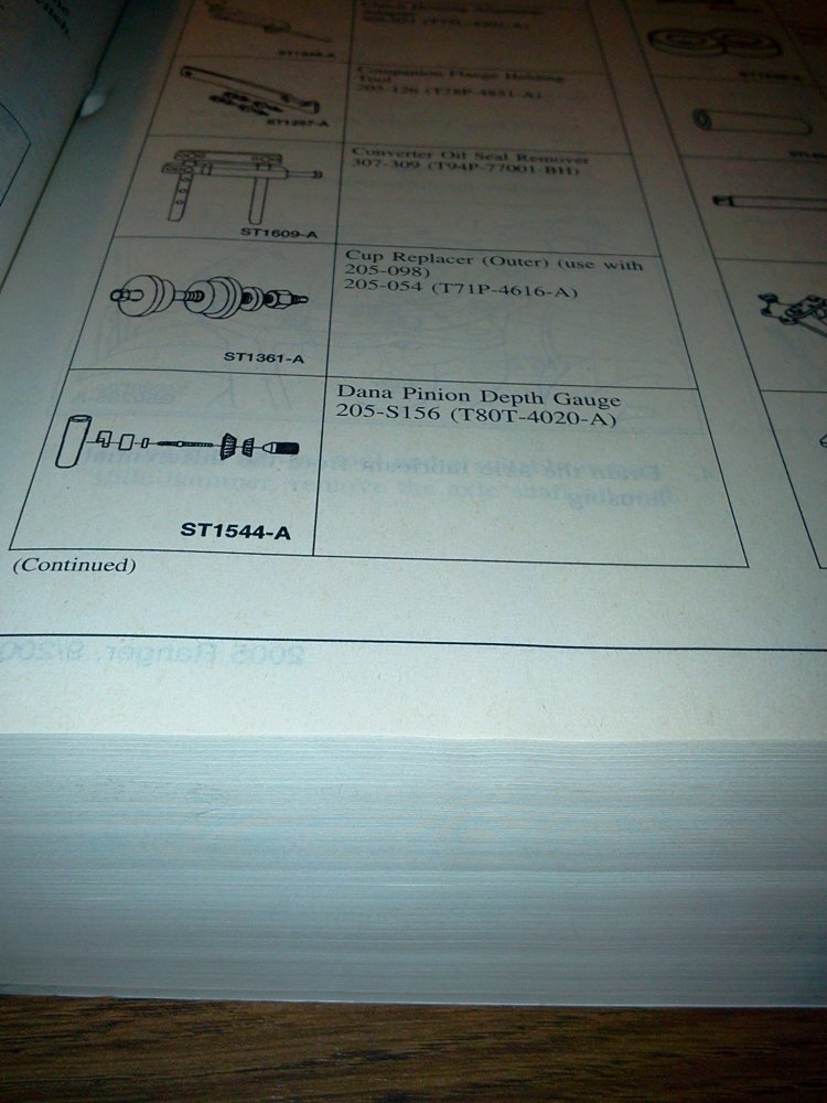

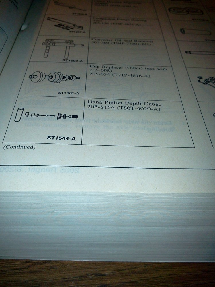

going thru the manual getting ready for my 2000 front diff setup.
looks like I need a precision tube that bridges the bearing saddles then a gage setup that sets a specific
height from the inner pinion bearing. then work with the gap as compared to the +/- mark on the pinion gear.
anybody have the height gauge? I could probably make one on the mill if I had the dimensions.
T80T-4020A for the gage blocks, D80T-4020-F49 for the tube.

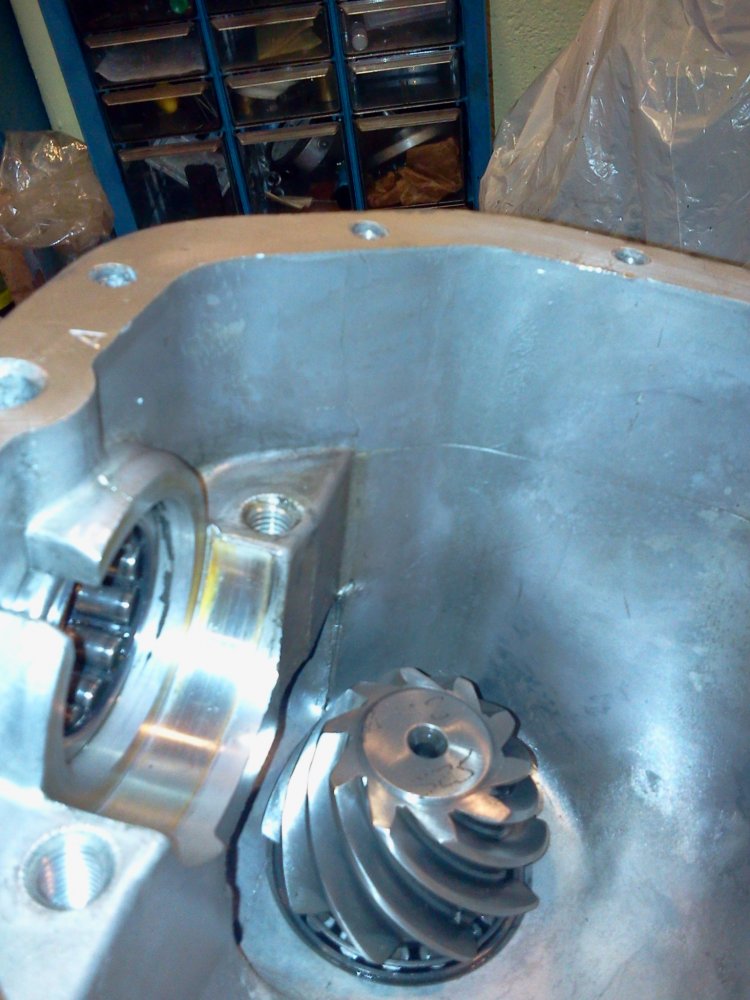

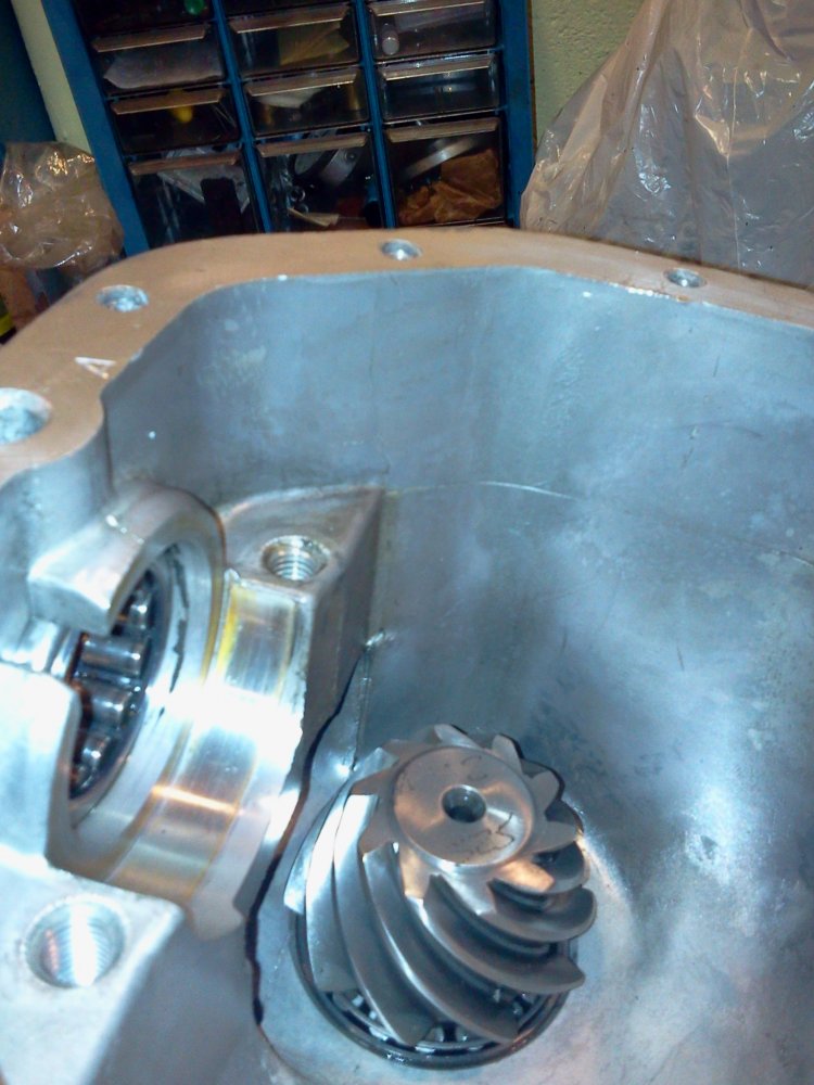

the D35 IFS/SLA is different. you don't measure from the center of the bearing to the pinion.
instead you measure form the bottom of the bearing saddle to a gage block that's installed in place of the pinion.
that is supposed to be a specified distance, then you look at the pinion gear where a + or - value is stamped then calculate the shim required.
the end of the pinion isn't flat, you cannot get a repeatable reading on it.
plus, the bearing saddles are not machined flat, can't indicate off them either.
EDIT: added the pic. you can see -2 etched on the pinion. you can also see the only machined area around the bearing is the bore, that's why
you lay a gage tool across the bearing surfaces and measure from the bottom/hidden side of it to a gage block that replaces the pinion.

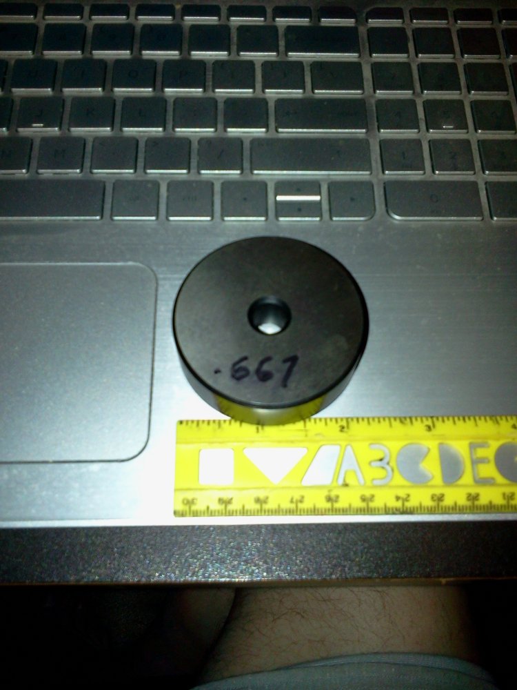

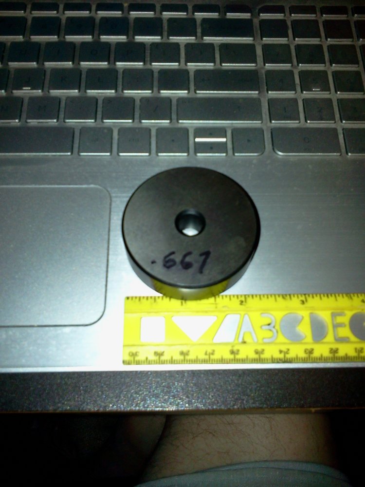

got some more info, and a new to me depth gauge disk. part # T90T-4020-B mfg by OTC
the L shaped piece is the same for 8.8, 7.5, and 35/194 front axles. it is 1.7"
the disk is different for each axle, 8.8 = 1.884", 7.5 = 0.894" and the front d35/104 = 0.6672"
I found all the specs in my 2005 manual except for the d35 disk. just received it today, thanks Ebay
I'll be using it in a few days/weeks to set up a front diff.
for those who want to make a tool, the combined height is 2.367"

Have a pic?
I’ve had good luck using a setup bearing in the pinion and just doing musical shins until I get it where I want it.
looks like a plain 'ol thick spacer of sorts. I plan on fabricating the L tool and a setup bearing..
