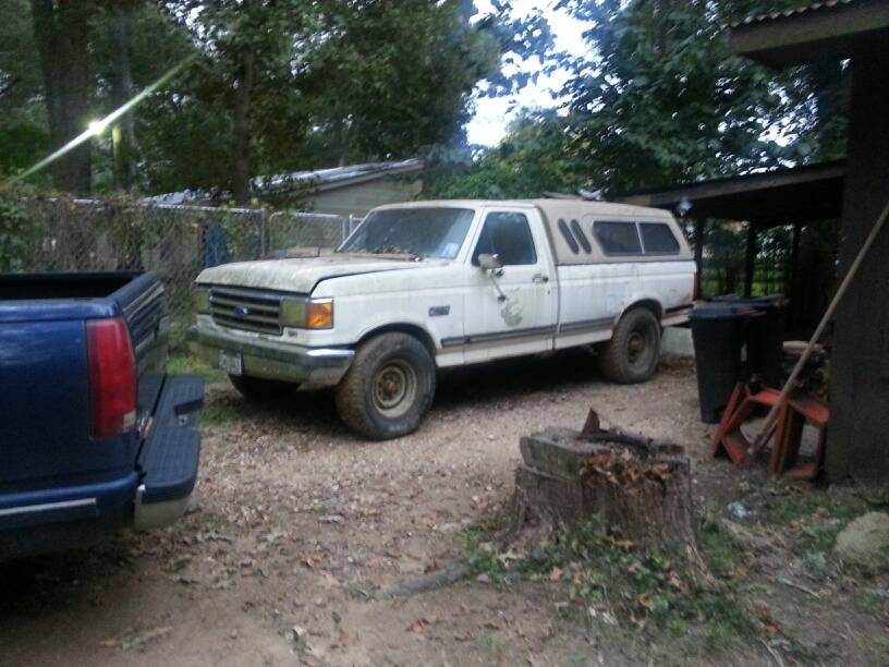

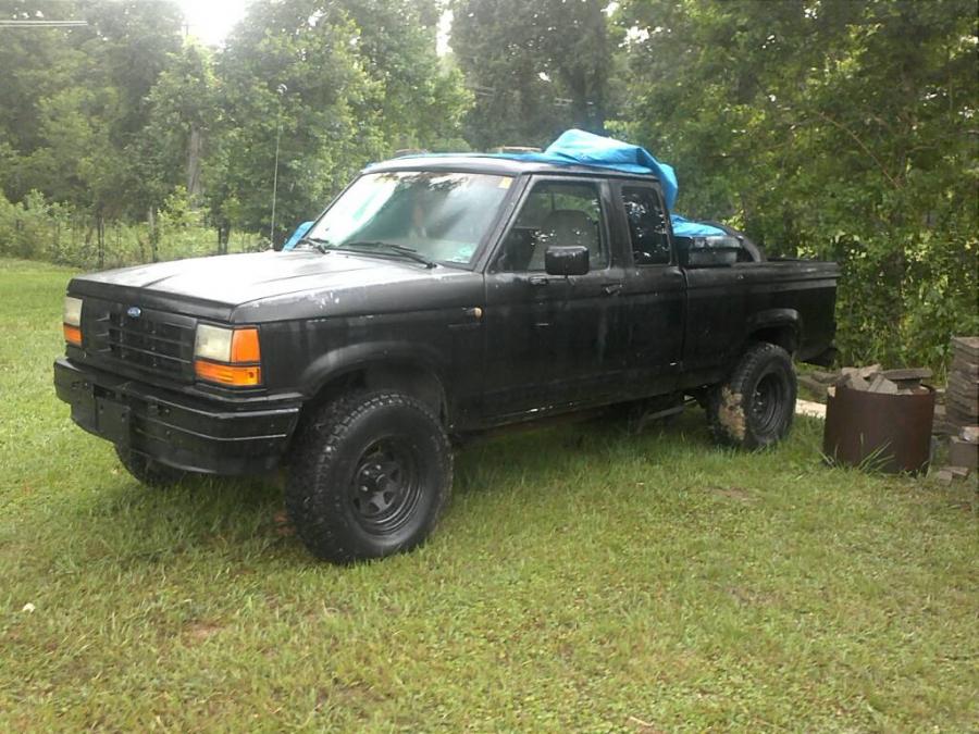

What have you done to your truck to make it weigh 6k? That is crazy. I'm using tapatalk on my phone right now, so I can't see if you have it in your signature.
Sent from my SAMSUNG-SGH-I747 using Tapatalk
The Ranger uploadfromtaptalk1398999396468.jpg The donor truck for motor and rear end.uploadfromtaptalk1398999475824.jpg

the laws of incremental-ism and unintended consequences happened to it.:shok:
:icon_surprised:
:icon_rofl:
seriously.....i mean that........you know.....mo powuh.......need moooo powuh........put in the powuhz......and snap-crackle-fawking-pop.....:D
it started out bone stock with a capper, running boards....and a big tall blue bug gaurd.....you probably never seen such a ridiculous bug gaurd:D
and it ended up like this.
i will actually be updating this link as i have some new pics from maintenance that were requested about the frame mods.
http://www.therangerstation.com/forums/showthread.php?t=35931
does that help you understand the weight issue?
