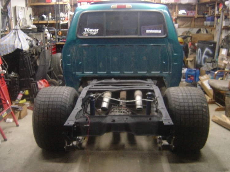

Clvfrk.
You move the mounts and springs to inside of the frame rails instead of the outside of the frame rail, thereby opening up space for wider tires and wheels.
Clvfrk did this. Explorer style. So yes....use an explorer spring and hardware setup. Cake.
His truck is wicked. Ls swap. Very well executed.
I do love that truck, but at that point I'd just go 4 link or 2 link ladder bars and coils. :dunno:
