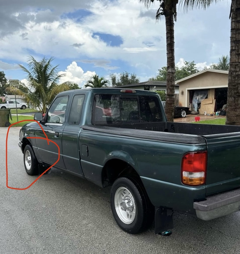

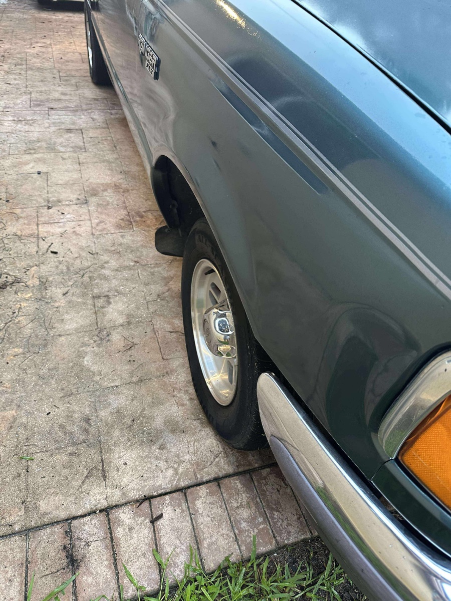

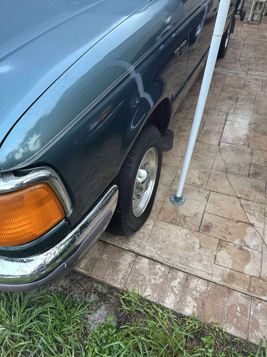

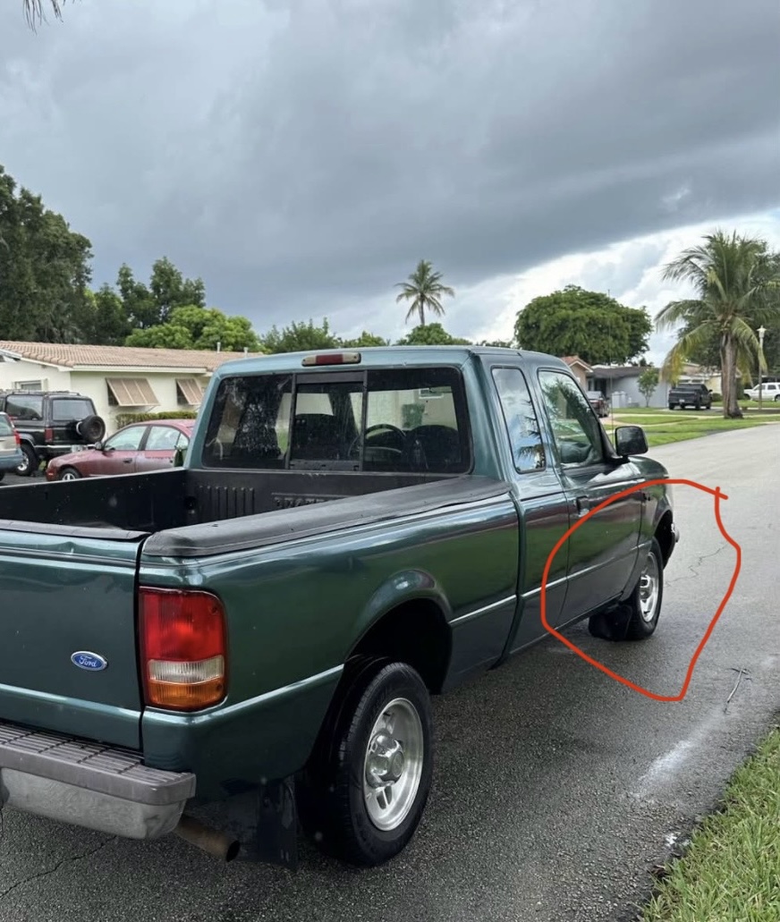

Hi all, new to the forum but am in the ranger for a 2wd ranger for daily driving and maybe building into a fun little trail runner. I found this ext cab in green with the exact set up I want but I noticed something odd about the body and how the front sits in relation to the front wheel offset? What could be causing this?

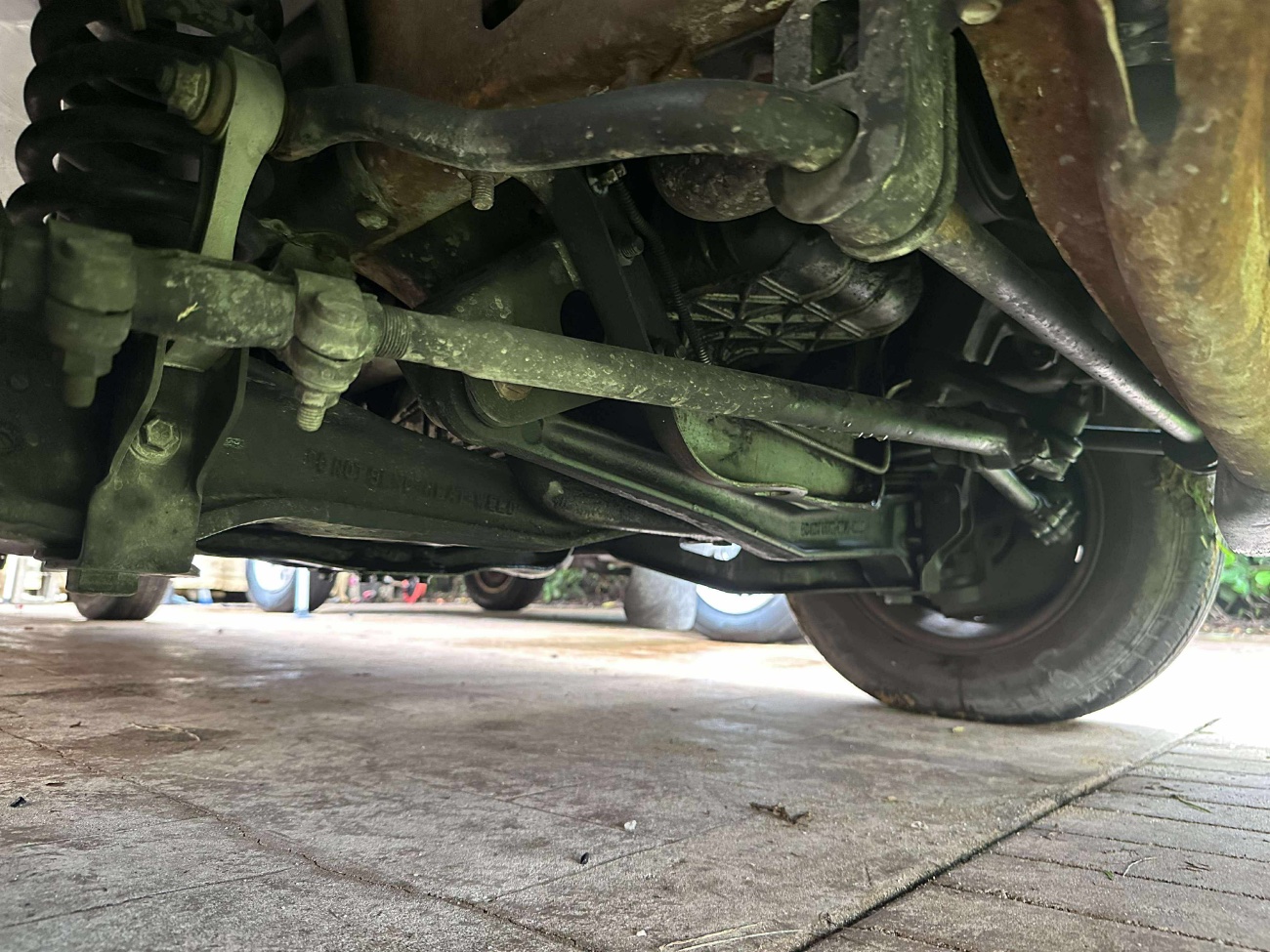

Is the front clip misaligned? Bad beam bushings? The only other thing I can think is the front of the truck might be tweaked from an accident but the current owner doesn’t have any info on that and says truck tracks straight? The radius arm bushings visually look okay and I can’t tell on beam bushings. It looks like the passenger side tire is inboard at least 2 inches more than the driver side and is just throwing me for a loop, I’m driving a couple hours to check it out on Saturday so any input would be great!
I attached more images in the attachments section of the underside of the truck and some photos from the front

Take measurements to be sure. Visual cues can be misleading. Photo angles make it hard to tell, really. And when measuring, make sure the wheels are pointed exactly straight ahead. A little bit of turn to the wheels can make it look that way.
With that said, i know my front is slightly offset to one side. Maybe about as much as seen on those pictures. It doesn't affect alignment or driveability in any way and doesn't bother me.

looks ok to me.....is it eating tires?
There's also some slop in the body mount bolt holes. Not sure if there's enough to cause this much difference, but it's something else to think about.
I'll go against the grain and say that the PS wheel&tire does absolutely look stuffed further underneath the truck.. seems like by an inch or two at least.. using the mudflap as my POR.

I'm gonna guess cab/bed mounts. I know mine is crooked. About that far off. The cab lines up with the bed, but the whole thing is on the frame at an angle.
Thats crazy looking
Yeah I ended up passing on the truck, I did some digging and found it had a salvage/rebuilt title and I didn’t want to drive 3 hours to ge there and find out the front clip was still tweaked. Going to keep looking!
