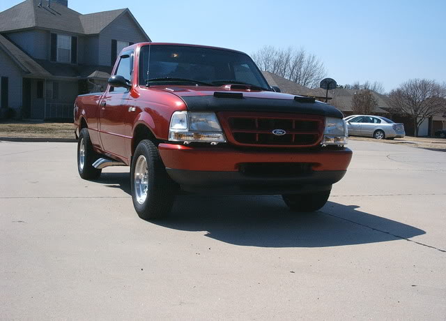

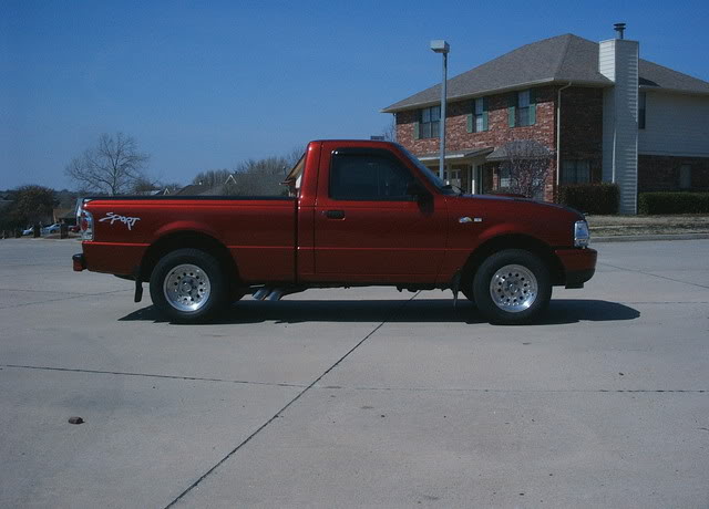

On the 2.9, that may be. Didn't affect the mileage of my 3.0 one wit. Still get around 18 to 20 on the highway. 16 around town. But hey, I drive it like I stole it. Always chirping the tires at stops. Always hammer down around my favorite set of curves. Have the larger Hellwig anti-sway bars on it, both ends. Rebuilt the front end last July. Handles like a slot car. Love throwing it around a set of curves. Frankly, some people try staying on my bumper and have a difficult time of it. Except on bikes of course. It's not lowered, never will be. Don't like skateboards. Still handles extremely nice with the big sway bars. Rides a bit on the rough side though. Big tips are gone, just two straight outs now.
