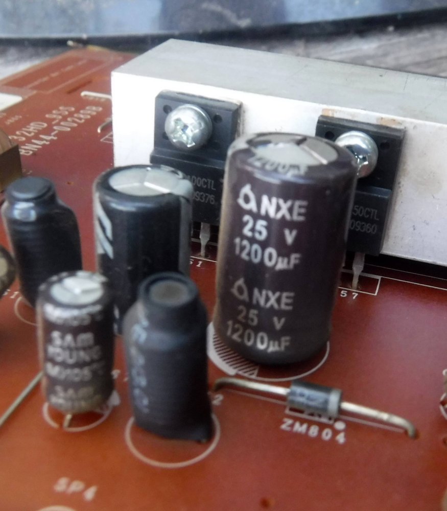

I took the TV apart I'd like to fix but I'm not sure if it's possible. if I could get the parts I would be glad to do it.
This one I can get, it is right beside the one I changed last time although it's a bit larger and not in the assortment I bought then, but they show it on Amazon and I hope it's available.

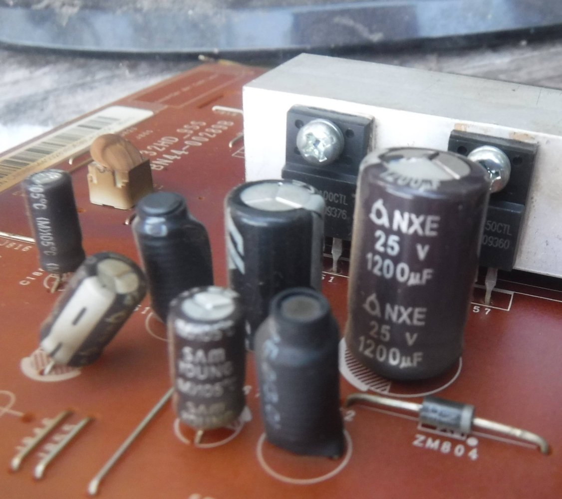

There's another thing there I'm not sure what it is, although I recalled it being rather distorted the first time too, it isn;t looking good either and I don't have any clue what is is or what it's for
It's in the same area as the others are

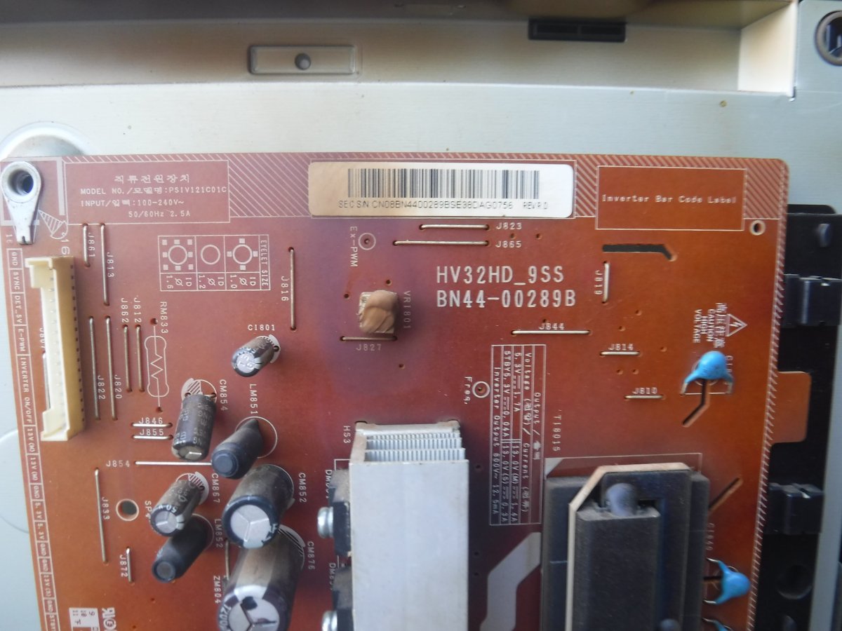

what is under the brown stuff that is popping off? it actually looks like a socket that someone put some goo in
I have only looked at it, haven't poked around on it. The photo by itself you can see a heat ring around and above it
VR = variable resistor. Yeah, it got hot.
