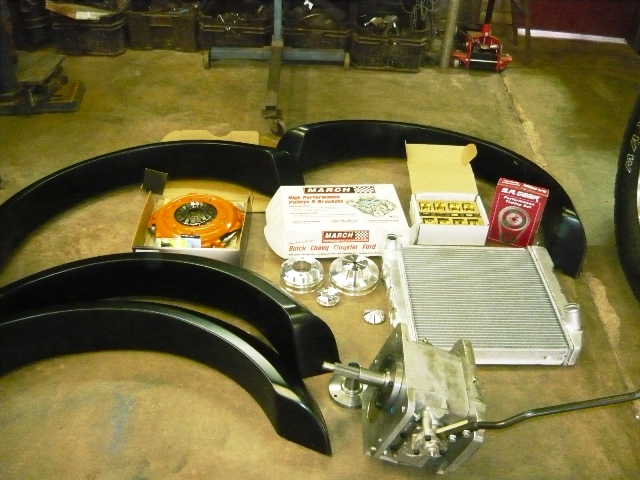

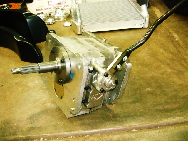

It is from Advance Adapters. My nerves were shot, waited three months for its arrival from the States.
http://www.advanceadapters.com/tech-vault/ranger-overdrive/
Pic below the most joy full day of the build when long awaited parcel from the States arrived.

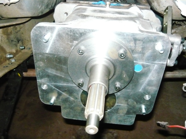

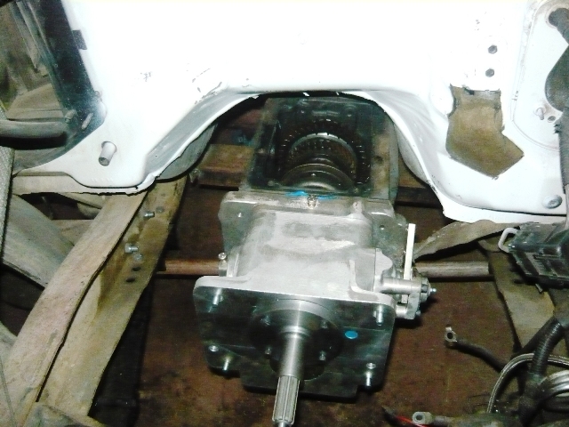

Installing the overdrive.

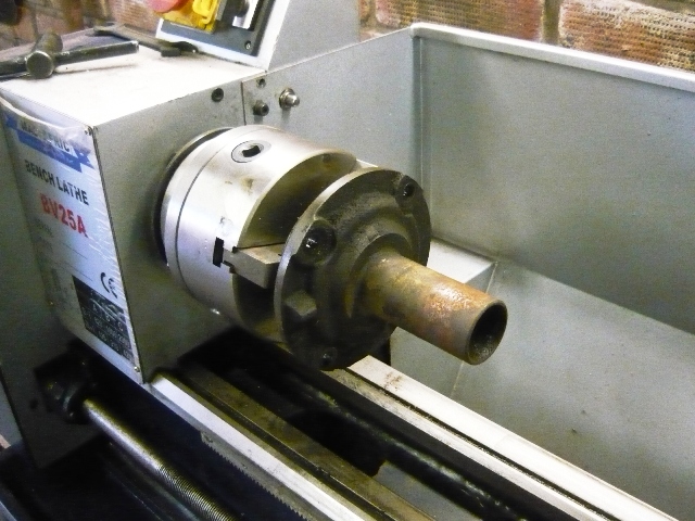

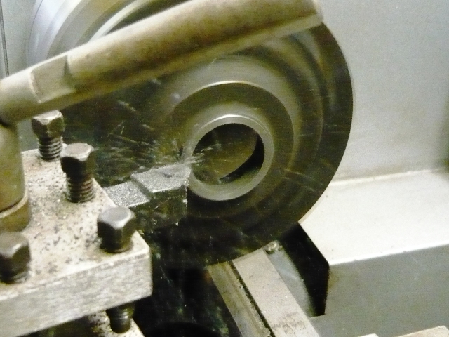

Some slight modifications have to be made on the NP 435 input bearing housing.
Shortened mine on the lathe.
See I dropped a pic it bolts to the front of the NP435.

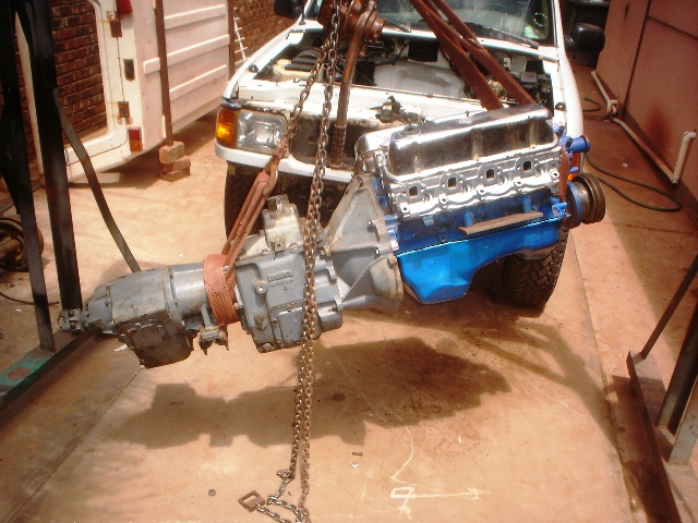

To make sure the engine fit I use an worn out 302 with no internals other than the crank as a dummy. Use the 4.0l mountings.
The dummy going in.

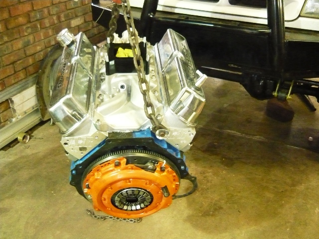

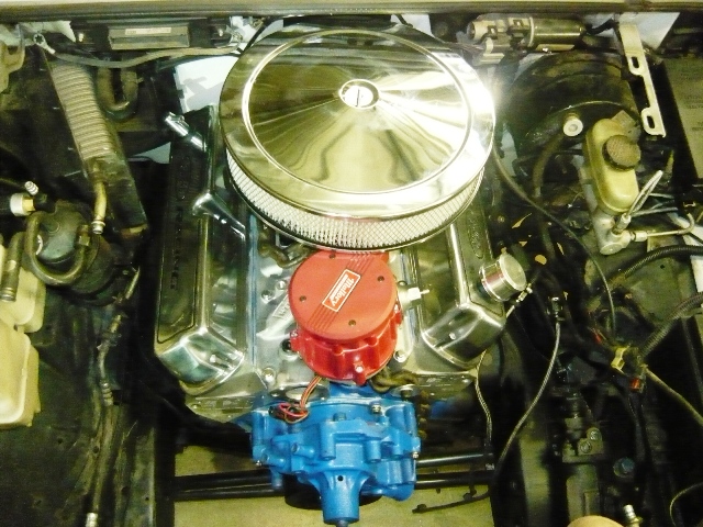

347 Installed. Made use of a Center Force clutch hope it will last.

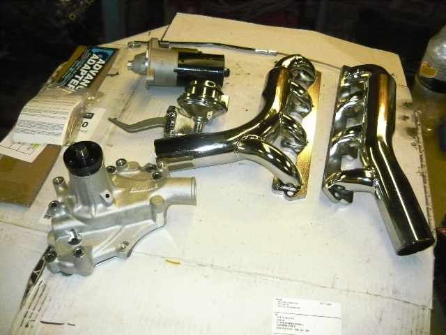

Advanced Adapters Headers ready to do duty.
What do you guys think of them ?

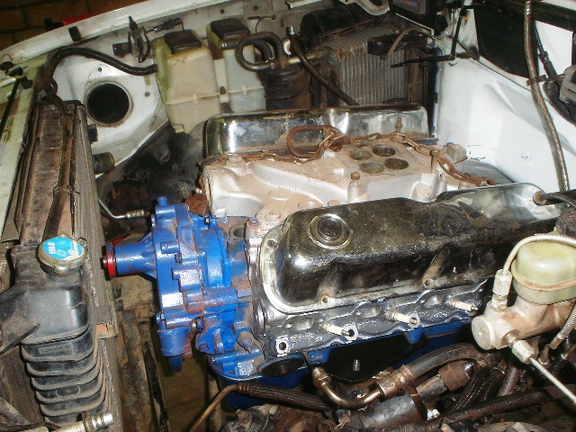

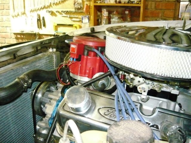

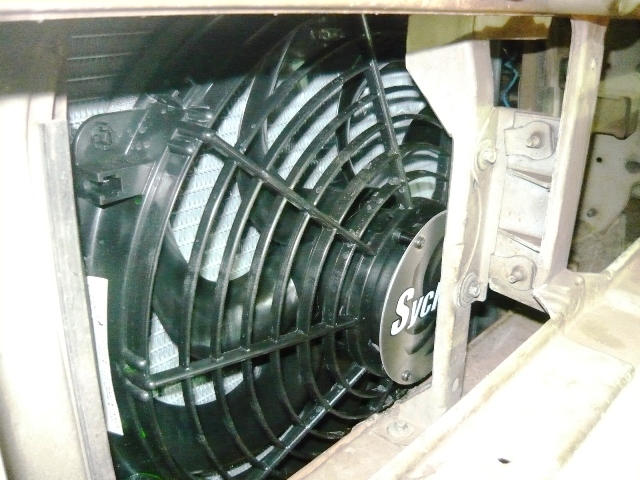

Fitted an alu radiator wit a Cyclone fan to keep things cool. Made use of a blower set up. Some small mods to fit the fan

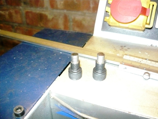

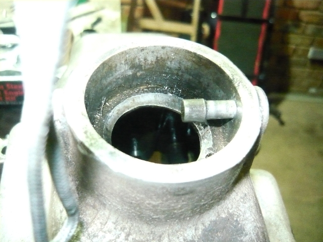

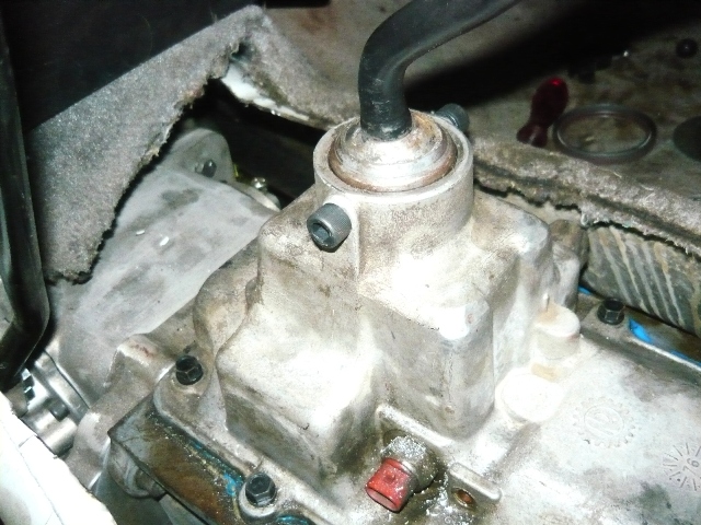

My NP435 shifter mod. The gearlever pins and retainer where worn out.
Decided to do my own mod by replacing the pins with cap screws.
Turned the screw ends down on the lathe and threaded the housing.

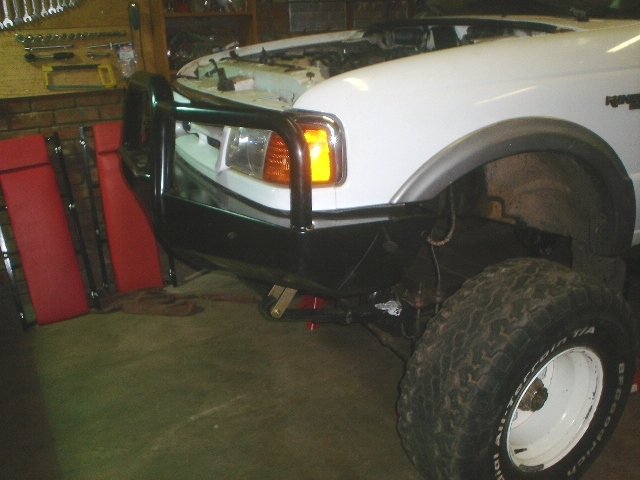

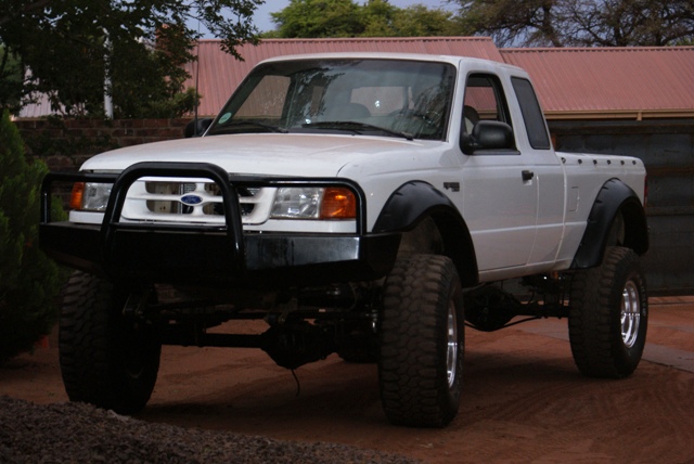

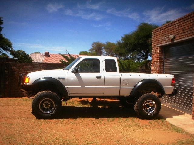

With the Dana diff`s and 35`s the tires were 4" outside the fenders. By South African law tires are not allowed to be outside the fenders. To keep the cops calm I ordered a set of Bushwacker flares. The Ranger runs on Maxxis Bighorns 35 x 16 shot on a set of Mickey Thompson Classic 2`s.

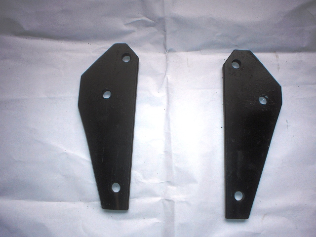

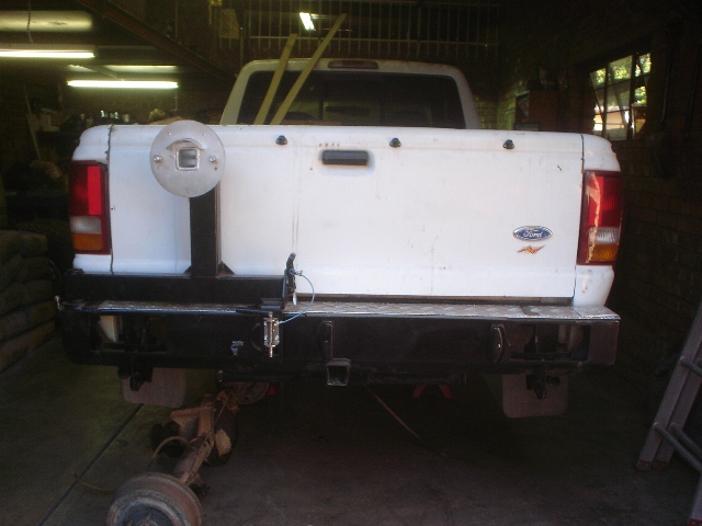

A friend phoned me when I just started with the project asking if I do not know
about someone who was looking for a complete set of bumpers for a Nissan
Patrol 4x4. The price was a give away. Bought the set and thought I can make a
quick buck at the time.
Well it was mounted to the Ranger.
Narrowed the rear and made the front fit on the Ranger:D
