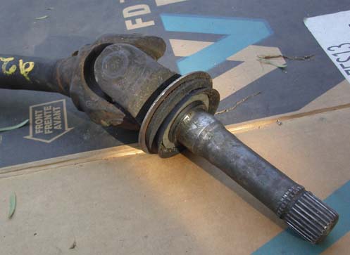

Has anyone ever thought to simply try putting the D44 seals onto the D35 shaft if they're so much better??? They are... after all, the same exact thing. (The D35 even had the same seals up until '93 or so).:icon_idea:
are the other two seals the same? the wheel bearing seal, and spindle seal? im pretty sure my axle shaft seal is the tightest seal on my d35, the water gets in the wheel bearing seal the easiest.
just looked up a 76 f150 d44, wheel bearing seal is timken 4250, same as i just got, outer wheel bearing is timken set37, same as inner/outer on my 35.. but the inner is set45 on the d44..
the axle shaft seal is this one for the d44
d35
the spindle bearing for the d44 are smaller/different. heres the seals
d44:
d35
so why don't the d44 guys constantly complain about water? i dont know ANYTHING about d60s, but how different can the seal setups really be?
those must be pics of the later style stub seals for the 35.theres a smaller seal that goes inside the seal in the second d44 picture that you slide onto the stub shaft with a plastic thrust washer.and the first d44 picture looks like it might be the seal in the axle tube not the knuckle.not sure on that though.

For reasons unknown, my '94 D35 has the D44-type seals (spindle seals have the angled lip like compleckz's 3rd pic down, and uses the hard plastic spacer and small V-groove seal around the shaft. IIRC, there was no seal actually INSIDE the spindle).
My buddy's '93 Ranger had seals like compleckz's 2nd pic, and had the seal pressed inside the spindle (they were all tore up & disintegrated pretty bad, too, where mine are still 100% perfect).
Shafts I've picked up at junkyards:
'91 & '92 Explorer shafts: same seals as mine (D44-type)
'96 Ranger: D35 seals like my buddy's.
The D44 on my Ranger ('92 Bronco axle) has the exact same seals as my D35 (and I've had water get into it once also). I've dealt with these same seals on a '79 D44, so it's nothing to do with TTB either.

The problem is very simply the fact the hub cavity is NOT VENTED!!. When you submerge hot hubs (heat from brakes) into cold water, the vacuum caused by the sudden cooling draws the water in right past any seals. If a vent could be rigged up and the line ran up high, this problem of water intrusion would almost be guaranteed to disappear.
D35 shaft with D44 seals?
attachment.php

My 91 has that seal Junkie

but thanks for setting me straight on the seal issue, i REALLY think a huge part of my problem was the CRAP wheel bearing seals i had been using..
i know someone local who has an eb d44 in his ranger, and says he has no water issues like he used to in his d35, so thats what i was basing my info off of.. and until recently, i wasnt even interested in a sas into my truck, which would explain why i never saw water complaints.
It would seem correct in that '93 was the switchover year, although I still don't know why mine has the "old" seals.
