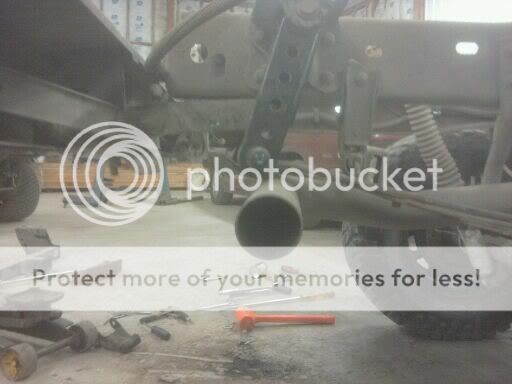

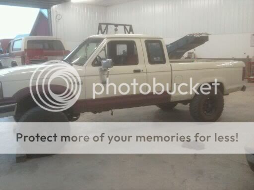

New belltech 6400 shackles. Leveled the rear out perfectly.
Before.

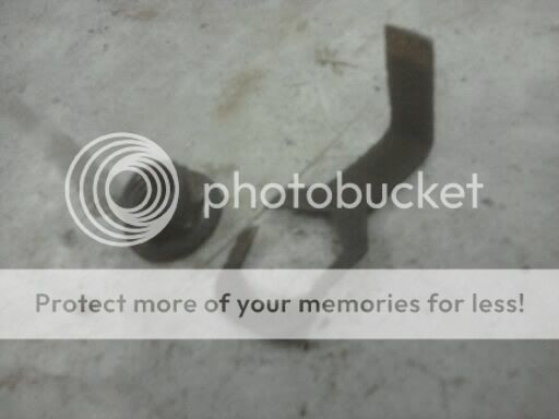

Had to take the bed off because i broke a clip off a bolt from the top of the hanger.
My only concern is how close the shackle is to my exhaust pipe. I bounced on the bumper and it never touched, ill flex it out and see tomorrow if it is going to touch.
