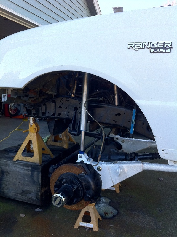

im running a set of fox 2.0 14'' travel air shocks that i picked up brand new for $300 bucks and havent had any issues. factory the 14'' shock come with 5weight oil and 325cc in them. i added a shim, swapped out the 5w with 10w and am running 400cc's to slow them down and work really well:thefinger:
heres a shot

Air shocks are safe from what I've researched but the safe thing to do is run a good swaybar with quick disconnects if it's a dd and weekend warrior. I run swayaway coilovers and leave the swaybar hooked up on the street.
