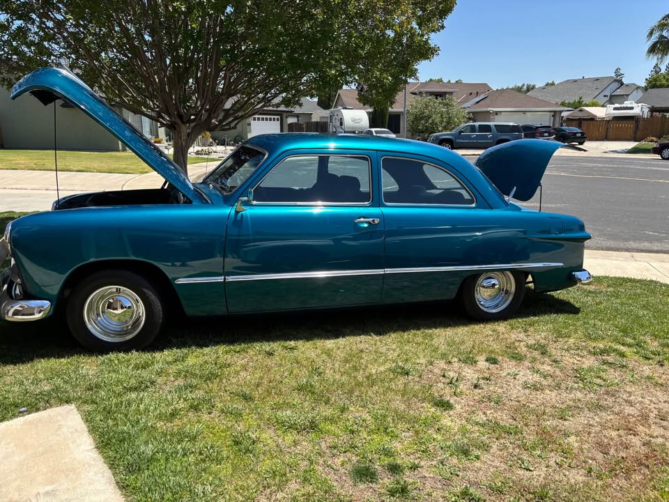

I have a 1988 Ford Ranger 2.9 L V6 that was mounted in a 1949 Ford Tudor Sedan. Th AC was never connected and the suction hose from the condenser to the accumulator is missing. I ordered a set of hoses and the compressor discharge hose looks good but the low pressure suction hose does not have the correct fittings. I've done a lot of searching and cannot find a hose that would work. Any ideas would be appreciated as well as a photo of the condenser connections.

Here's what the line looks like from the condensor to the accumulator.
Air conditioning condensor suction hose
Thanks! That looks correct.
I looked up a 1988 Ford Ranger with a 2.9 on rockauto and that is what came up. They have the other lines also.
