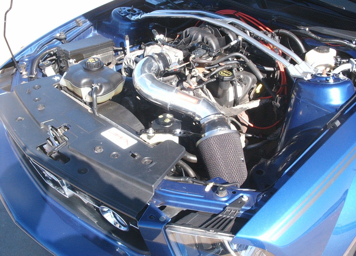

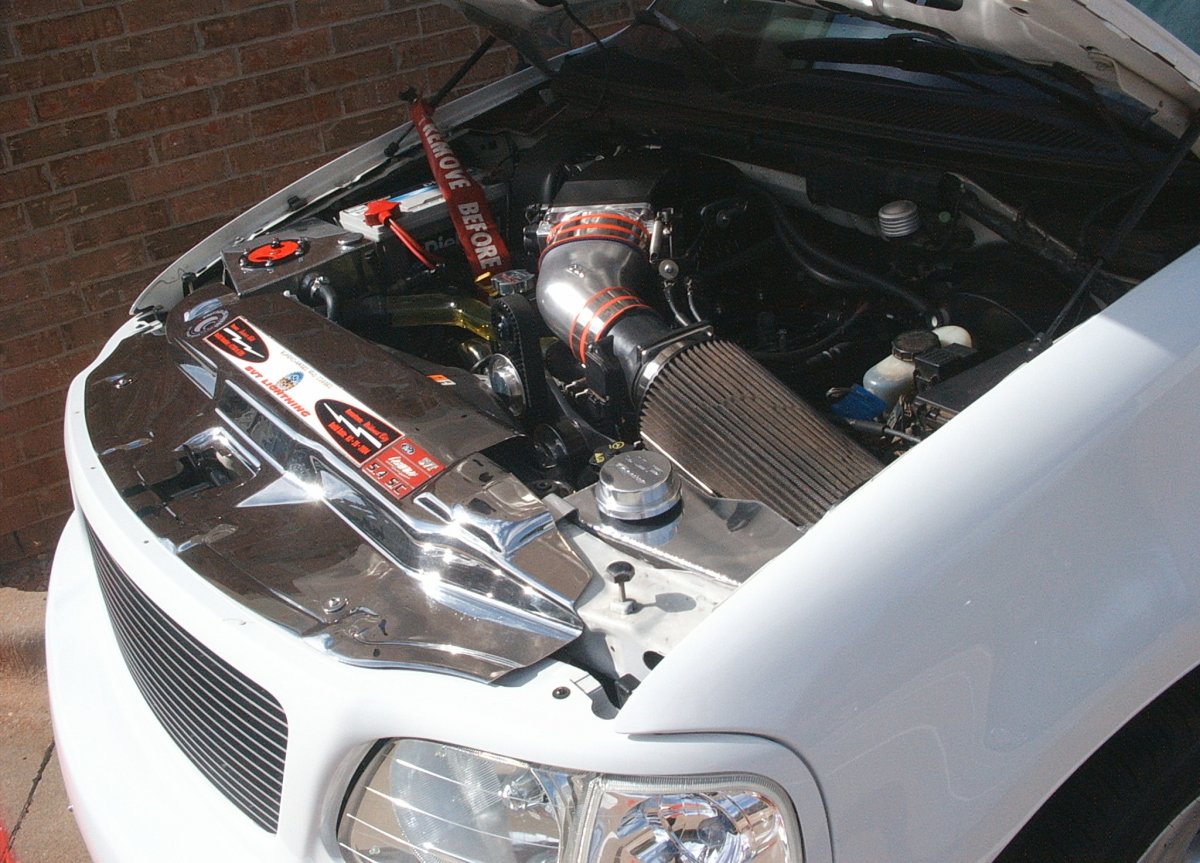

Here goes the CAI argument again. Same with the colder thermostat argument. I'm not going to get involved in any pissing contest here. First thing I do, any vehicle I buy, change the intake to a CAI and add hoses to route cold outside air to the vicinity of the air filter. Some CAI kits, such as the WeaponR on my Mustang, actually come with them these days. It also came with a very nice velocity stack that mounts in the grill that the hose attaches to. And the end of the filter, open as it is, has a fitting that the hose can attach to if there is room. I bought the Mustang on November 15th last year and ordered the intake as soon as I got home. I've always done it, always will. The Ranger has had a MAC intake on it for 20 years, never taken the MAF off to clean it. Not one truck that is featured on LightningRodder.com has the stock filter and airbox. Everyone there readily admits that in dyno tests, it's just not adequate if you really want to make power. On my Lightning, the filter is 12 inches long, 7.5 at the MAF and 5.5 at the end, which is also open and points directly at the fender opening. The only guys that still have stock boxes are those are want to keep their Lightning bone stock and they are few and far between. I drove my Lightning down to Lawton one fine day, a 100 mile drive. Opened the hood when I got to my destination, filter was cold. Not even warm. It was January.

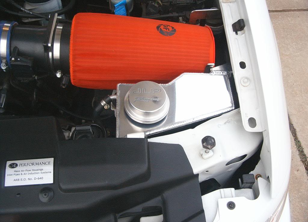

There are fixes for that too. They are called Pre-Filters. Easily obtained, K & N makes them to fit the entire range of filters they sell. Use one of them, you don't need to remove the filter and clean / oil it near as often. Take the pre-filter off, run water through it from the inside, let it dry, put it back on. Can even get in different colors.
AFE, Air Flow Engineering also offers a large selection of them in various colors. This one is supposedly red, but looks more orange to my eyes.

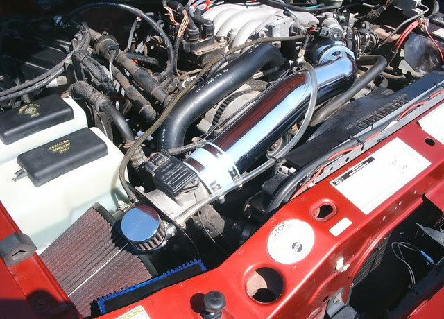

My Ranger is a 3.0 and I threw the stock box and filter in the trash 20 years ago. I don't have any of those pre-filters any more. The Ranger never had one, only the Lightning and it was more of a style thing than anything else. As I said, the Ranger, I've never removed the MAF to clean it. And the truck doesn't burn any appreciable amount of oil in a 3000 mile change. It has a very small nuisance leak that accounts for the oil I have to replace. It's getting near 170,000 miles. Soon, real soon.

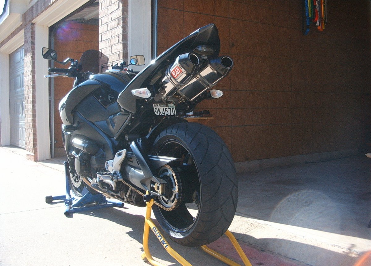

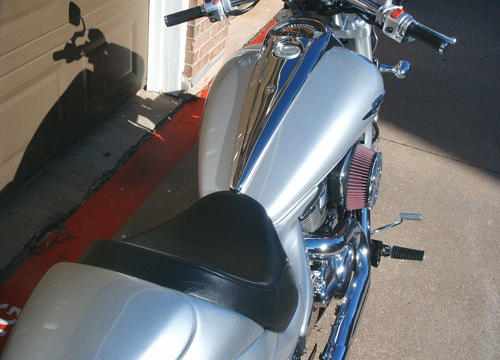

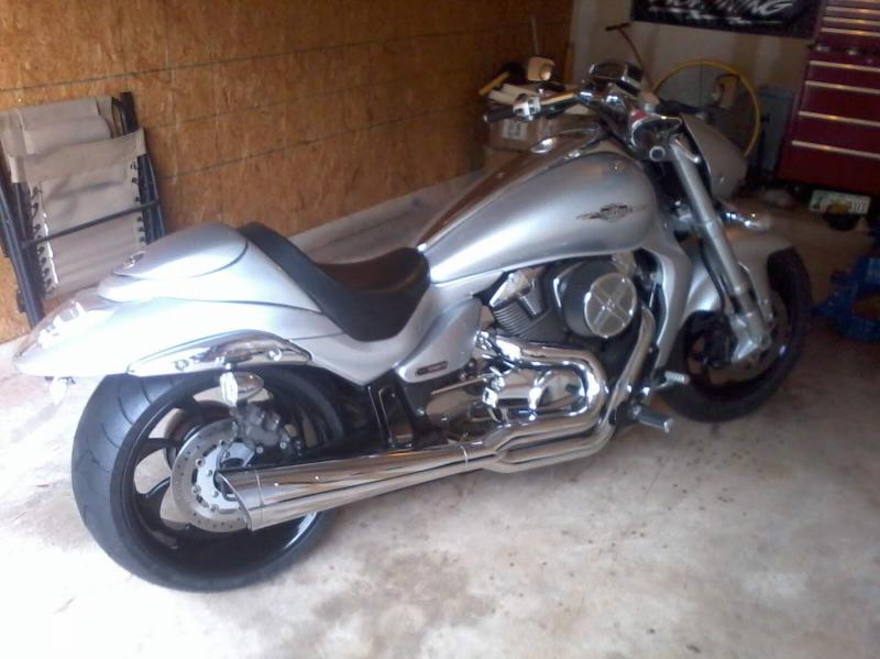

And this motorcycle has had two giant K & N filters, one per side, hanging off it's side for 14 years. Various versions, Never had a single issue with it. Airbox under the tank has never been removed in 40,000 miles and 14 years. My B-King has a modified airbox for ram air and a K&N drop in filter in the stock box. Can't alter it due to the ram air set up, which is not stock.
