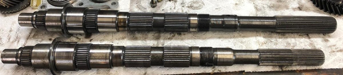

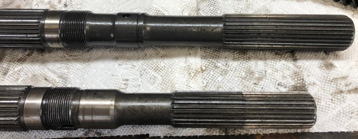

These pictures are in honor of the guy on reddit last week who wanted a better understanding of the difference between output shafts. 2wd is on top, considerably longer, and ~1/4" thicker at the splines (28 vs. 25):

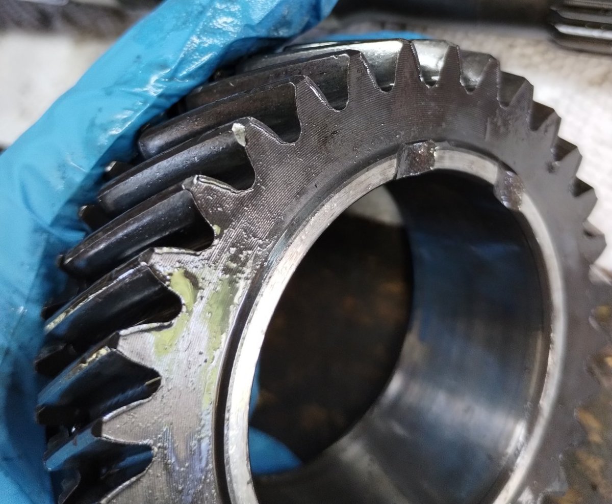

Single chip on this gear, IIRC 2nd:

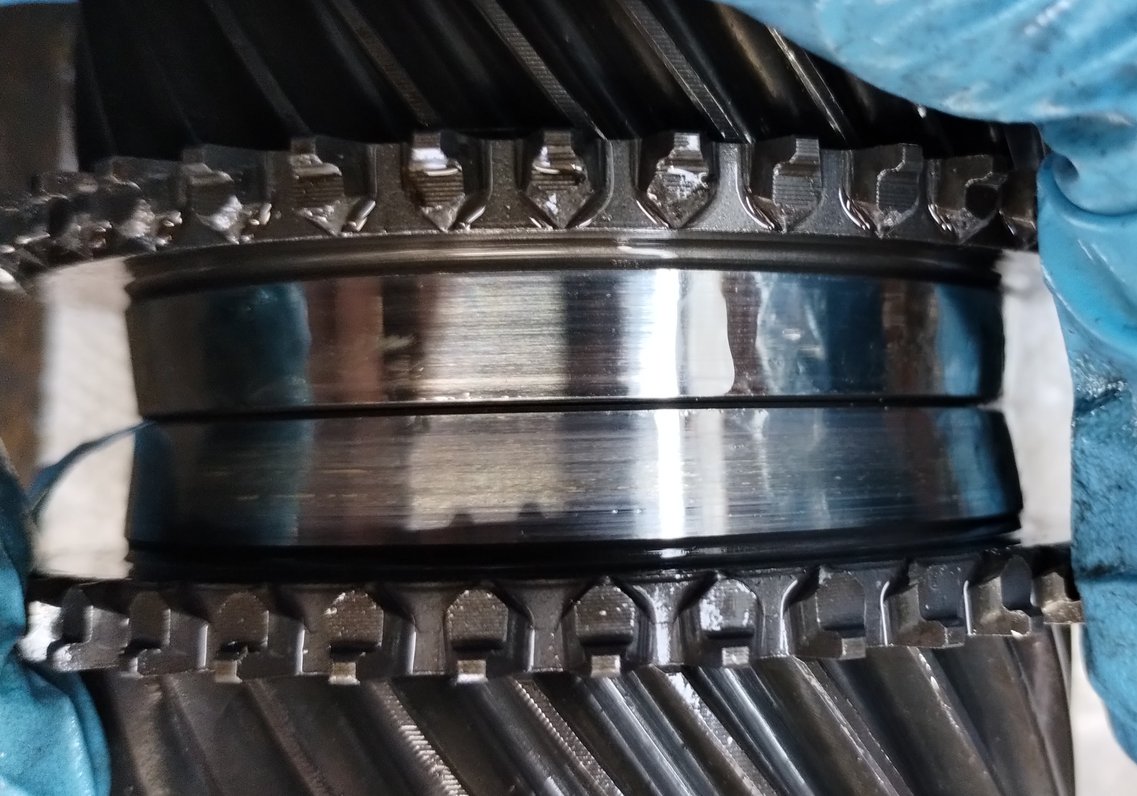

Noticeably worn dog teeth on this gear, IIRC 3rd ('95 vs. '97):

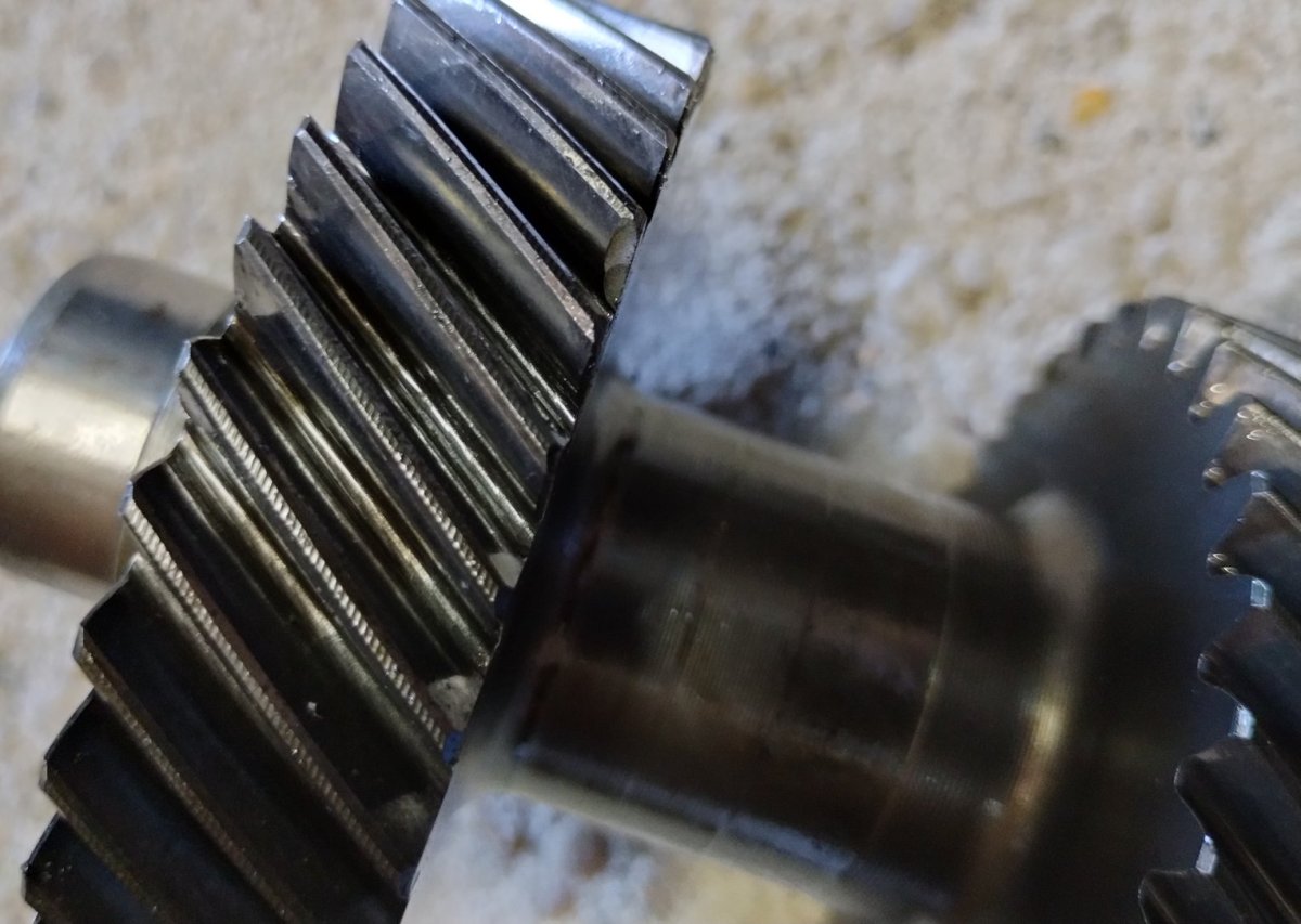

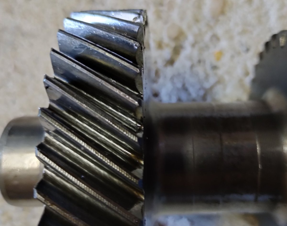

And finally, extensive chipping of the counter input gear:
It's extremely tempting to blame the noise on that last one, right? Except that I beat the absolute piss out of the counter right there in order to remove the locktited shafts from the '95 for the final time. I'm fairly confident most of that damage happened right then, but I guess I'll never know for sure.
