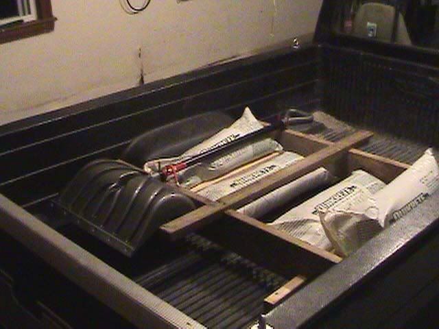

That's true, but for about $10-20 worth of 2x4s you can just build a box that fits around the wheel wells to secure your 200#

Back end only kicks out in hard turns (coming out of a parking lot for example), and when I intentionally make the back end kick out. Yes, it takes a lot longer for the back end to track straight but it's also more consistent. The amount of counter-steer and throttle needed to get the Ranger straight again was almost always the same, and to be honest it's kind of fun since it's so controlled. Before I did the sandbag/box thing the truck would either immediately track straight or do a 180 (this was with a bed full of snow one winter and a fiberglass camper shell the other). As far as weight goes it has a 50lb bed cover, 2 70lb sandbags and the box is made out of pretty thick wood (2x8 or 2x10, I can't remember) so it's at least 10lbs (My guess would be around 30lbs). So close to 200lbs.
As for the snow idea, I only did it one winter and I noticed rust at the bottom of the tailgate (on the inside). I feel that sandbags is the way to go as long as you have it secured and placed correctly in the bed (over the axle or in front of it).

For me, I dug out the rack that I built out of some scrap 2x4 and just threw the three bags of tube sand in it. Gets me around just as well.
