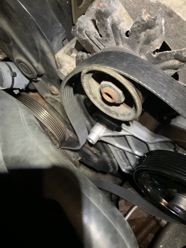

Ok I got the right belt (60in) but I’m missing this stupid pulley. “Belt tensioner pulley”, that’s it no? Also yes the drive belt is placed wrong on the photo, that’s before I realized there was something missing..

That's just an idler pulley. Dayco 89003 should work. It's a smooth non-grooved pulley with flanges. Ford used that exact pulley on a number of engines. Ford part number should be E8TZ6B217A
If I recall correctly, that pulley has a bore diameter of 17mm, but it's bolted in place by a smaller bolt which means you need a spacer of some sort. I used a bronze bushing to solve this on my old 2.3
Edit -- looking at your bracket, I believe that stud that the pulley bolts to will fit in the bore of the pulley so you won't need a spacer
