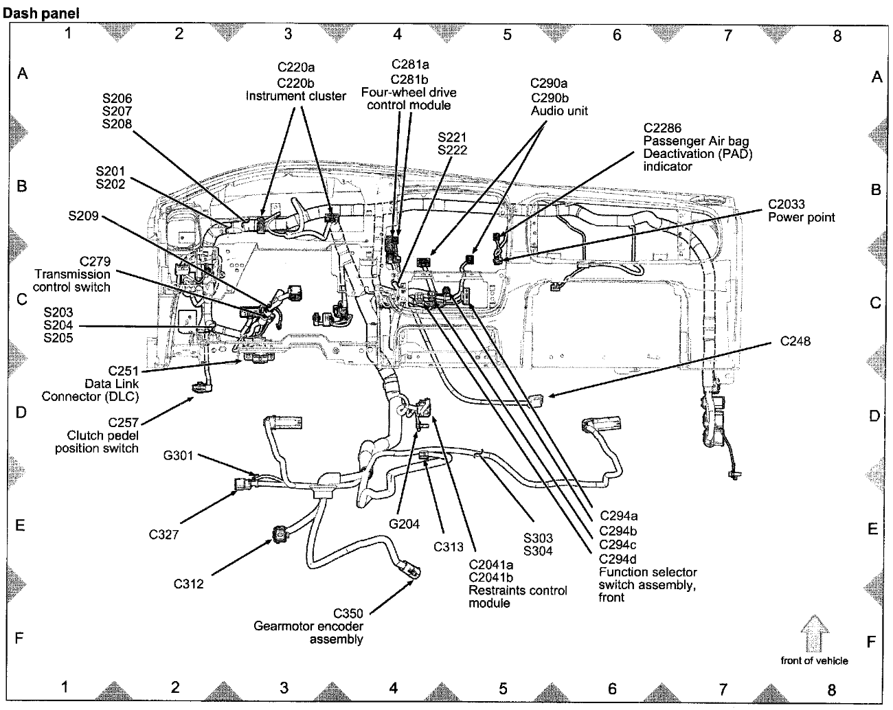

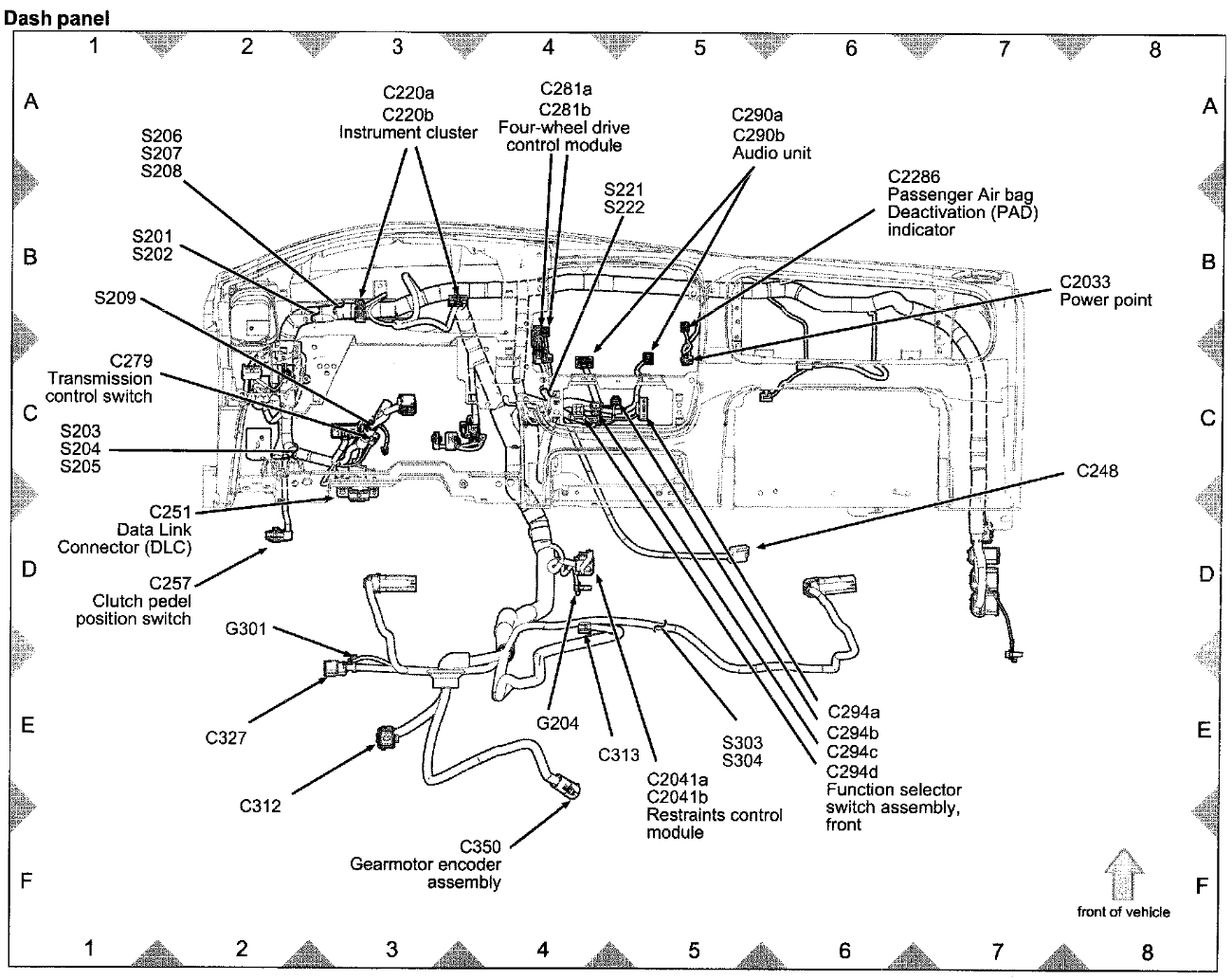

I want to add LED light up under the dash for courtesy lights as well as add one for the glove box. I'm trying to find the wire I need to tie into that becomes hot when the doors are opened and the dome light comes on. The glovebox light I can just tie in to any 12v source. I just can't find anywhere to tell me which wire I need to tie into for the courtesy light. I'm thinking about adding them under the seats as well. I want them to come on when the door is open and off when closed.
The wire you are looking for is green with a blue stripe. You can find it under the driver's seat area at connector C327.

The wire you are looking for is green with a blue stripe. You can find it under the driver's seat area at connector C327.View attachment 136781
Thank you! I did end up finding it but I appreciate your reply non-the-less. I looked for a harness around the glove box but I couldn't find anything. I'm just going to tie into the radios 12v constant and use a little limit switch.
