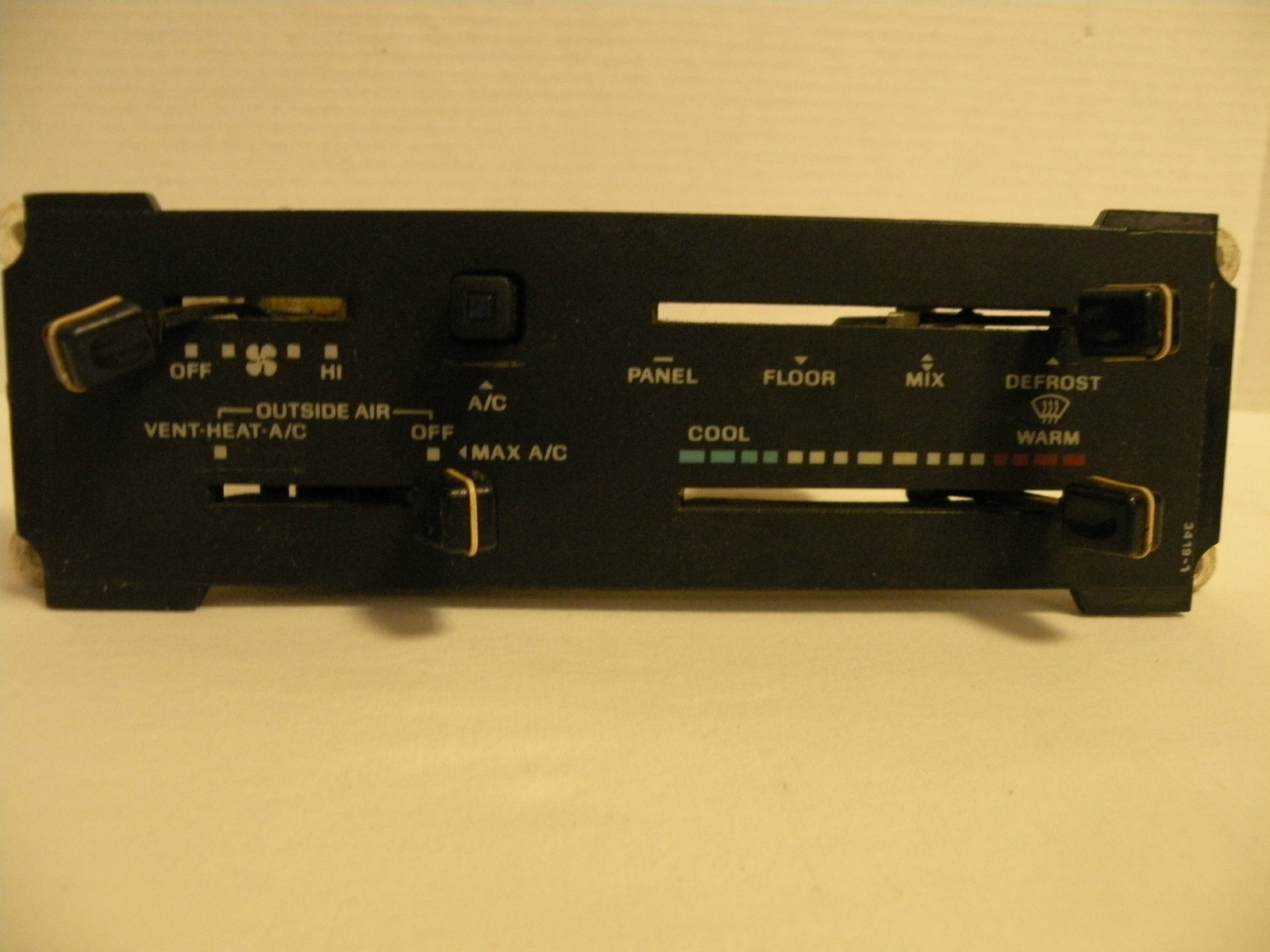

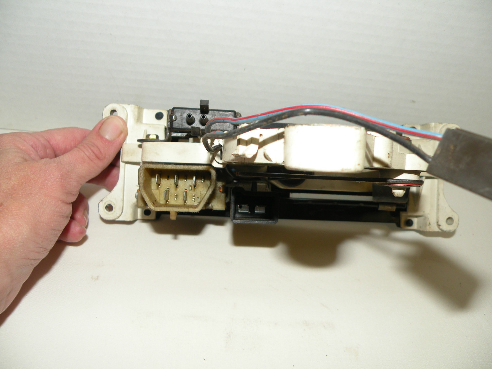

From what I'm seeing on Ebay, the heater and A/C control seems to just have a push switch that's only a two wire connection. Seems simple enough to make my own harness. I'm guessing that I could incorporate the high pressure switch and the original compressor connector into a hand built harness that kicks the compressor on using a relay. I know this wouldn't include a Wide Open Throttle cutout but I don't see that being a huge hazard or problem myself. Just push the switch to cycle the compressor off. Does anyone have any thoughts or experience with this? Any hazards to be aware of?

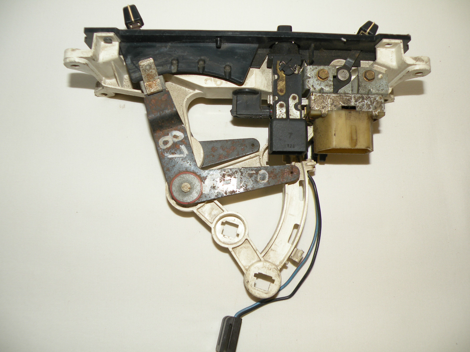

Here's a picture of the dash control which shows the back of the A/C switch showing two prongs for the connector, so it seems simple enough..

IIRC the wiring for the dash button is tied into the dash harness, it is just one single pin gray connector that comes out with the wiring going to the blower motor stuff. There is a harness that plugs into that and goes the switches and compressor, all in the engine bay and fairly easy to extract.
