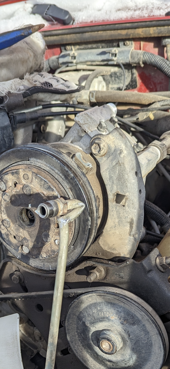

Honestly I have no idea what is wrong. The compressor is missing a hose, but I haven't been able to find much about how it is supposed to be set-up. The lady I bought it from doesn't remember what would was wrong before I got it.

Well, that's a 2.9 engine, so it won't work. Those have a different compressor and the mounts for it are not really adaptable in any reasonable way.
That does not look like an air conditioning hose though. That looks to me like an automatic transmission cooler line that would normally go into the radiator... there should be two of those that come out of the passenger side of the transmission and both go into the driver's side of the radiator. If that one is not an extra that was pinched off and abandoned, you need to address that right away - the transmission needs to cycle fluid through either the radiator or a separate transmission cooler or both.
Sorry that is an old picture. Yes, that hose in the for front is the transmission cooler line when I hit a deer. This was taken as I was fixing the truck and that has since been fixed. At the back of the compressor there are two locations for a hose to connect. I can get a better picture tonight when I get off. I know it is also unplugged, but I am nervous to plug it in and cause damage with that other line not hooked up.
Haha, OK, that makes sense.
You can hook a hose back up to where the missing one is if you wanted to and it won't hurt anything. Automotive AC has to have refrigerant pressure on the low side in order for the compressor to turn on... if it just has air at atmospheric pressure in the system, it won't do anything.
Since it's been open for an unknown period of time, I would plan on replacing everything. It has probably ingested some amount of dirt and moisture. The condenser and evap core are the only exceptions to that... you maybe could flush them if they're both in really good shape...but honestly this stuff is frustrating enough to work on that it's worth just starting with new parts.
Technically the compressor could be drained and reused too but not knowing if it even worked in the first place would make me think hard about just buying a new one.

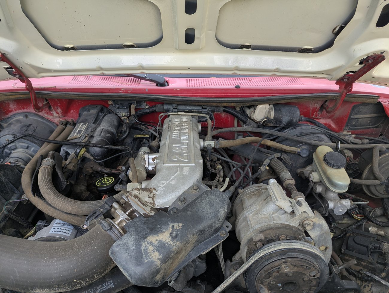

So after a very busy month, I finally got around to taking a look at it. Who knew hosting a reunion and weddings out of town every weekend in a month would make you not want to do much else lol. So here is the updated look at the engine bay. So the missing hose is the top on on the compressor, but I cannot figure out where the other end is supposed to go. Also it is R12 and I suspect it wouldn't have any left in the system, so I probably should just convert to R134A. How much of that can I do myself? I know that a shop has to drain the old stuff out, but what else would I be able to do? I don't have any ac tools to speak of, but can wrench fairly decently.
