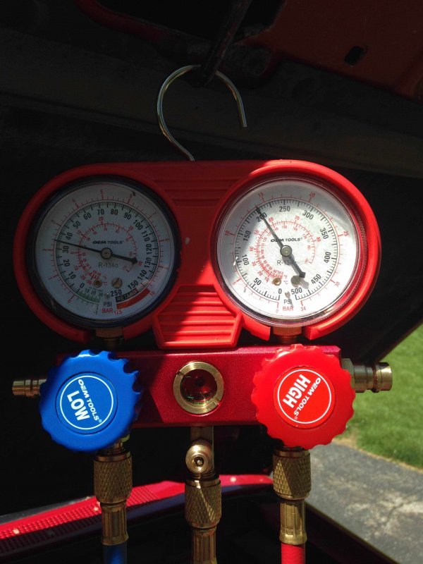

After posting last night, when I went back out to check on the vacuum I was messing with the low pressure hose disconnect's fit on the Low Pressure Valve and the vacuum instantly dropped from -28Hg to -10Hg and stayed there. So I'm not sure what the problem is, but I no longer trust the integrity of the gauges or vacuum. I packed up the gauge set and vacuum and returned them to Autozone. I'm going to try a different set of loaner tools from another place, though I suspect they all carry the same Harbor Freight quality loaner tools. Maybe I can find one that has been a little less abused, and maybe that will make it easier to pinpoint the problem.
If you disturb any thing when it'st under a vacuum it'll quickly jump up, from what you're saying, I would have put a holding charge in
This was like I put my hand on the the disconnect and moved my hand a little to make sure it was well-seated and then it jumped. And then I could never get it to pull more than -10Hg. I returned that gauge set and vacuum pump and got different ones that look to be in a little better condition. Maybe, hopefully, that will make a difference. I did get some more refrigerant so I will try to put in a holding charge if I get the gauge set to where I'm satisfied it's connecting well and working properly. The truck is down at the moment regardless while I'm waiting for a rear parking brake cable to arrive so I can finish the rear brake shoes/drums. Thanks for all the advice.

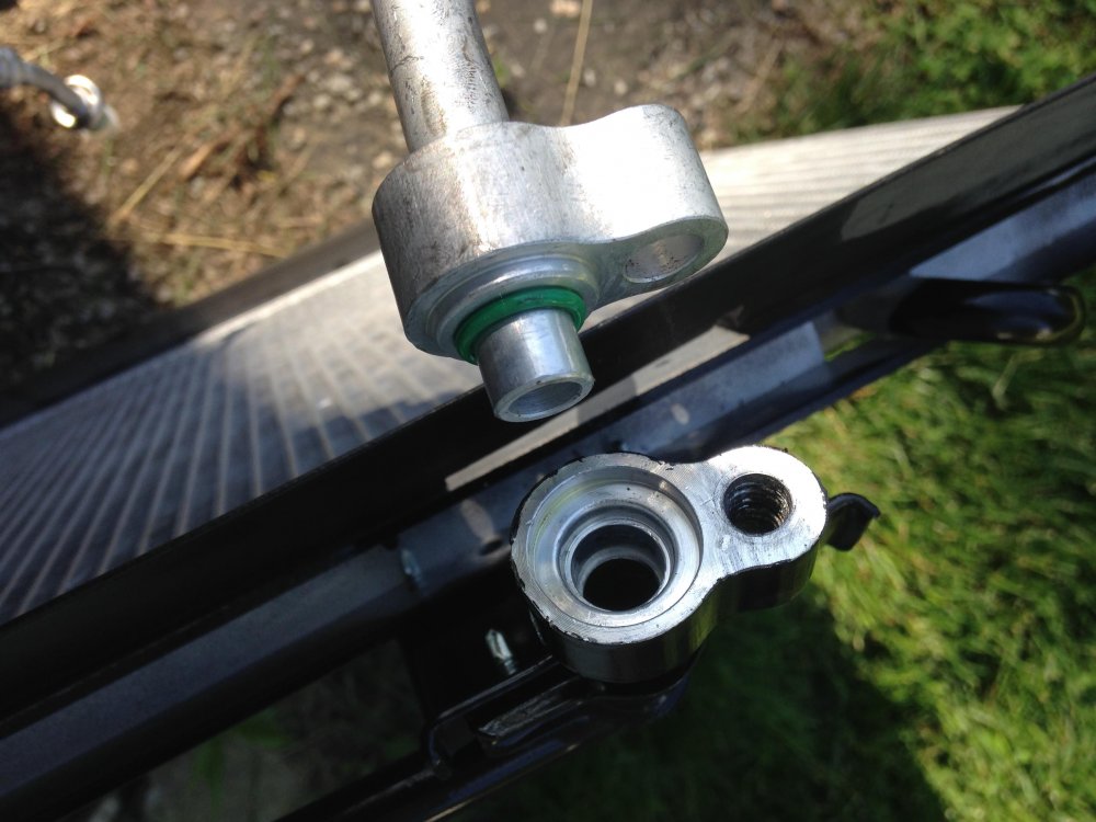

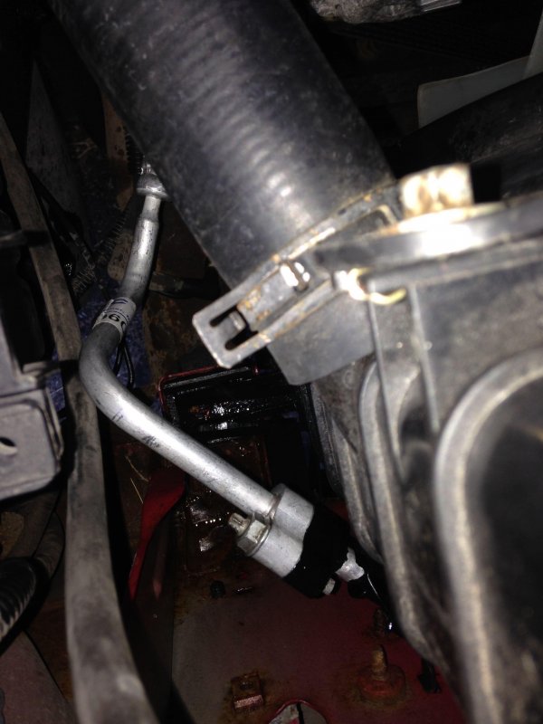

Found a leak where the low pressure line connects to the Condensor. Actually saw the oil spraying out between the joint where the connection is made. This is a metal-to-metal connection with the line having a short tube and O-ring, but the connection design seems unnecessarily tenuous. I removed both and there doesn't appear to be any damage. It's just that there's very, very little snugness in the connection with a single o-ring fitting into a bevel on the condensor. Anyone have any suggestions here? Has anyone ever tried using two o-rings on this particular connection? Or is there a thicker than normal o-ring I could use? Other ideas?
The low pressure line is the silver one and the condensor connection is painted black.

Pressure switches I believe use a standard r134 acme 3/8 thread and a larger o-ring. I can't tell by the picture is this the line coming off the compressor into the condenser? or from the condenser into the evaporator? I'm thinking it's probably the high pressure switch which are pretty cheap to get as a replacement, even hose set was/is under $100,. if you look you will notice that it also has a depressor for the Schrader valve that is on the hose, the high pressure switch has to have pressure against it otherwise the system won't run and you would have to jump it out.
This is the condensor to evaporator hose. The other connection seemed to be fine- at least it wasn't blowing oil. All the parts are new (from Rock Auto) but none of them are motorcraft. You can see the little indented area that receives the o-ring. But either it's too large or the o-ring is too small because the two parts bolt together without compressing the o-ring at all.
27758
Edit: I did put on a second o-ring to see how it felt and that seemed a lot better. The two metal flanges still easily pressed together. But using two o-rings seems a little dicey. Maybe though a fatter single o-ring would work.
I never saw a connection like that one but it is all about the o-ring, get right one and you should be okay, I think it's called a captive o-ring. that is also the orifice line isn't it? maybe they just gave it the wrong o-ring! Sillier things have happened.

I tried to locate a fatter o-ring both online and at a couple auto parts stores with no luck. Thought I'd look through the bag of o-rings I ordered along with the parts (didn't realize they all would come with o-rings already) and didn't see any that looked fatter. As I was putting them away though I did notice a fatter one. I presume it was possibly one that was included with the condensor that got mixed in with the others. When I was preparing parts to install I just threw all the o-rings in with the package I had ordered, not thinking they might be specialized (other than the obvious different sizes). Here's a photo showing the difference. I have 20 or so of the narrow o-rings of this size but only one fat one. Why the manufacturer makes this fitting different is beyond me.
