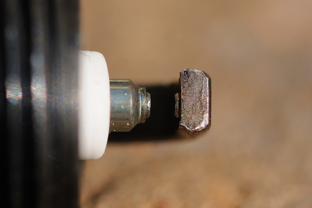

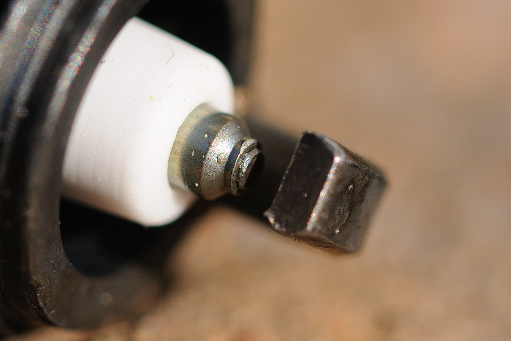

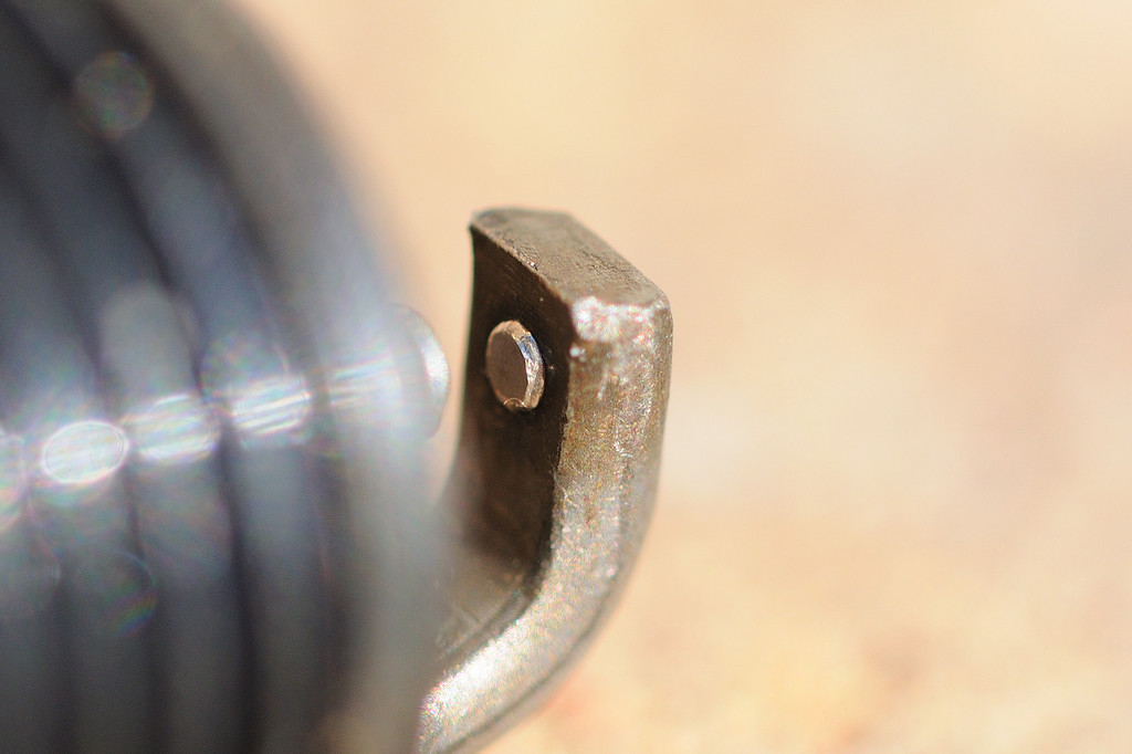

A word of caution about gapping these plugs. On the double platinum's, there are platinum beads on the center electrode, as well as the outer electrode:
Make sure you use the "wire" type of spark plug gauge, NOT the "circular" type of gauge.
When using the "wire" type of gauge, DO NOT use force to insert it in the gap, the platinum
beads can be easily damaged. To adjust the gap, bend the outer electrode close to the
spark plug threads.
Use one of these type of gap gauges:

Could I be having a problem with my Autolites because I used a circular gapper?
The plugs look fine, I don't think Sea Foam has ruined anything and when I first start her up the truck stutters all over the fuggin place, after warms up its a bit better but touchy.
well if the ring gapper messed up the upper tip and causes the trk to arc at an angle one on side of the plug to the other throwing your timing off yes that could be a problem. but for the most part ring gappers space the plug too far and damage the upper electrode, thats why you always use a wire gage to prevent this.
The difference in the coil discharge time will be usecs, worse case, which will not be seen in timing at all. Mis-fire, however, is a possibility.
