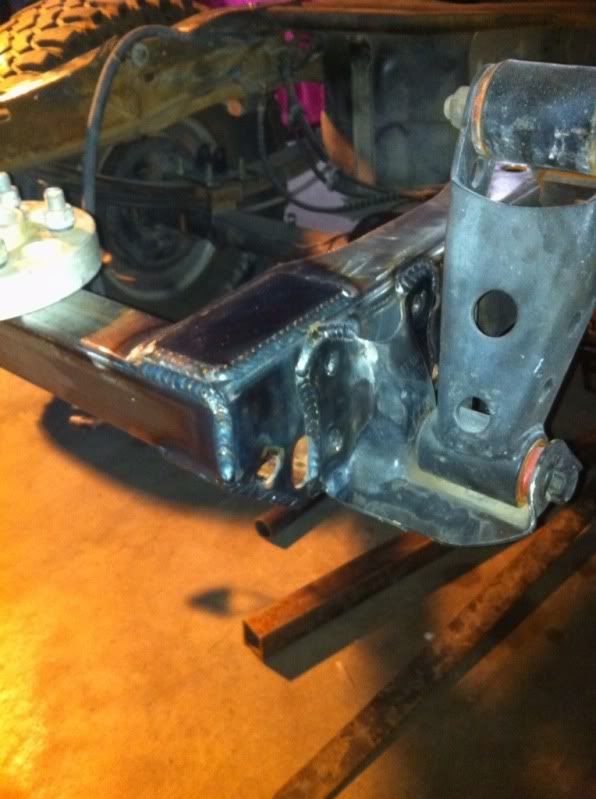

Well as far as the TTB's go. I took a stock D35 housing. I made a verticle cut straight down the beam about 3-4" in from ball joints. I extended there 7".. I made a makeshift jig for this.
Then I built a jig.. To hold the ball joints and beam pivot. (You can use a stock spindle for the ball joint end). I cut the lower ball joint out of the beam.. I then took the beam pivot point and moved it up 5.5" on the jig. The lower BJ was had a gap from where it originally was.. This is what corrected the camber alignment for the "lift". This is how I built 5.5" of lift into the beams..
From there I started laying plate everywhere to reinforce them...
The axles are not done yet.. I got qouted $550 for a set of 7" longer axle shafts... I think I am just going to sleeve two axles together to make one long axle shaft.. (Its been done time and time again) Plus I don't do the whole rock crawling stuff so I shouldn't have a issue.
