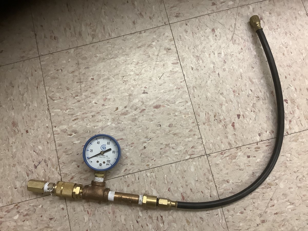

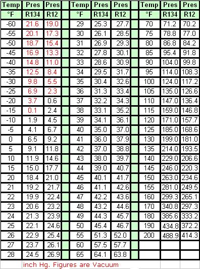

Could not read that link. I do not have permission. Can you tell me what the upper and lower pressure settings should be? I am going to look for the leak with this setup.
depends on temperature
also so called refrigerant replacements are often just propane and are not a good idea
You know it would be nice to know the following specifications. Cut in and cut out pressure at standard temps say 80 DEG F. Also capacity in lbs of R12 refrigerant on this 1989 3 liter FORD RANGER XLT.... anyone have an estimate?
