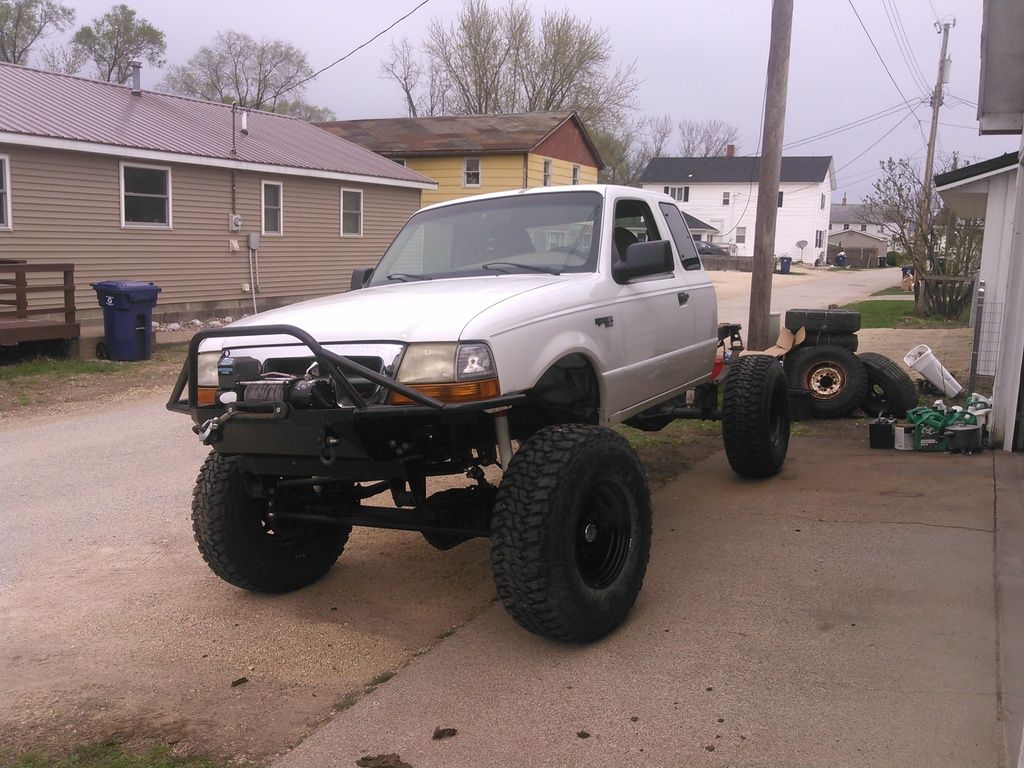

Just got back from a 11 hour round trip and brought this home
Thats awesome.
Looks like a 44 & 9" under there already. Care to share particulars?
:icon_thumby:
I'll have more pics later but the details are 94 ranger body on 75 half ton frame, 289 v8 4 speed 205 case, 44 front 9in rear. Still needs paint and front bumper and a few little things but I couldn't pass it up
Haven't done much with her yet, only drove around town a little. Their's quiet a few things I want to do but that will be a while and I won't to get my other one on the road before I do any thing much too this one. Plus being in the dog house with the wife over does not help ether!

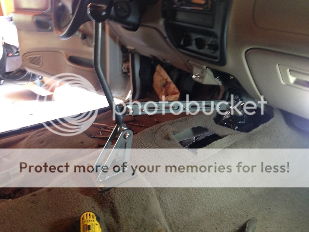

Installed the gear banger I got a while back, still need paint yet but I'm able to shift.
Also took my hydraulic clutch off to bleed it again, got some more air out and going to let it sit over night hanging up. Wasn't pushing the fork far enought to disingage clutch so I'm hoping it was just that. If everything goes good I might be able to drive her out of the garage tomarrow.

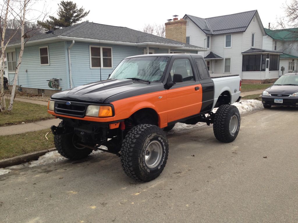

First time in almost 2 year she drove out of the garage under her own power

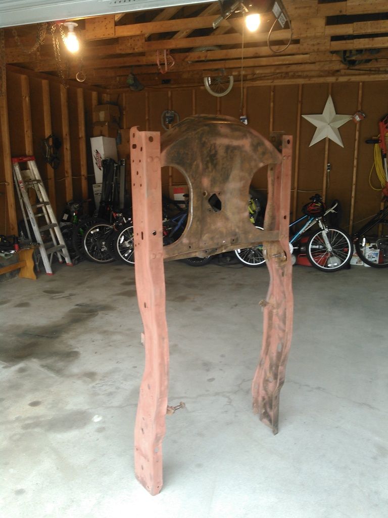

Cleaned up and primered the replacement rear frame section today

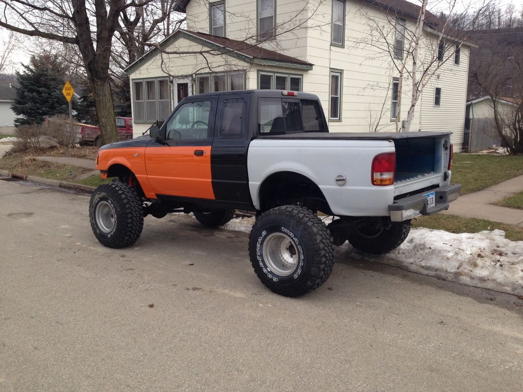

Also got the front bumper back on

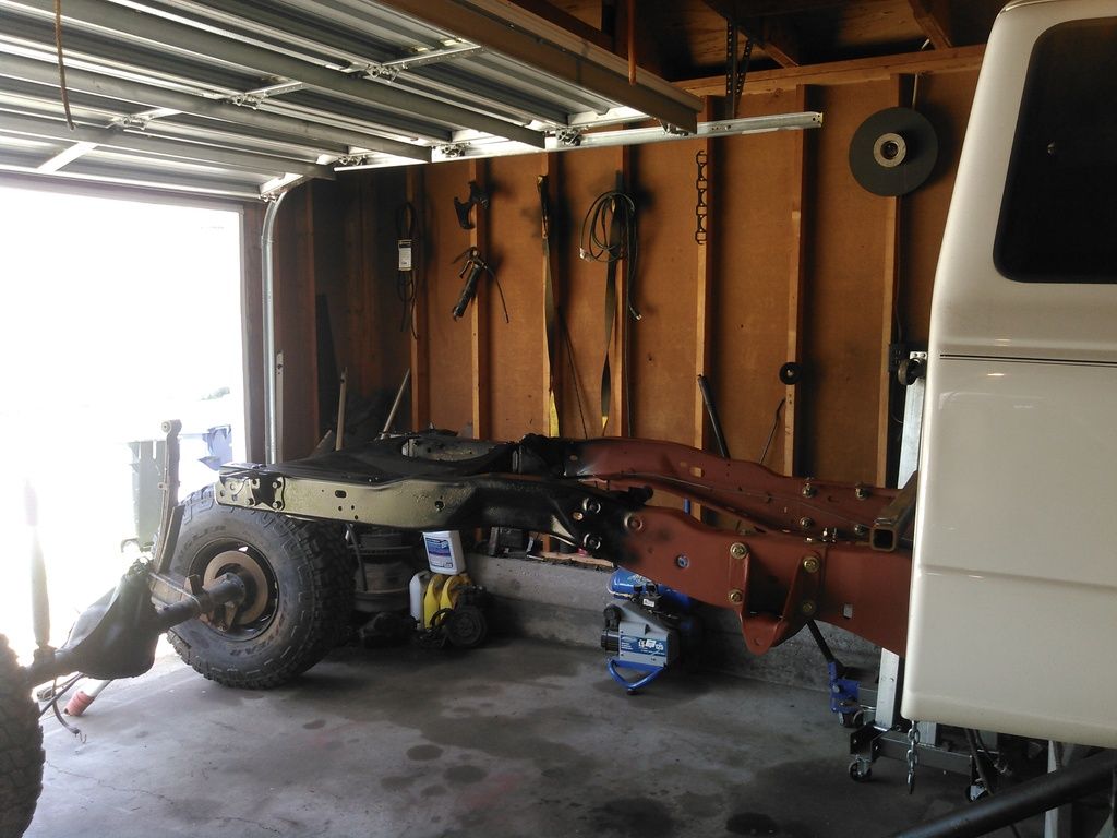

Got the new frame section in today, still going to add a couple more cross supports to stiffen it up and hopefully not bend again
Got the frame together and the suspension all on
