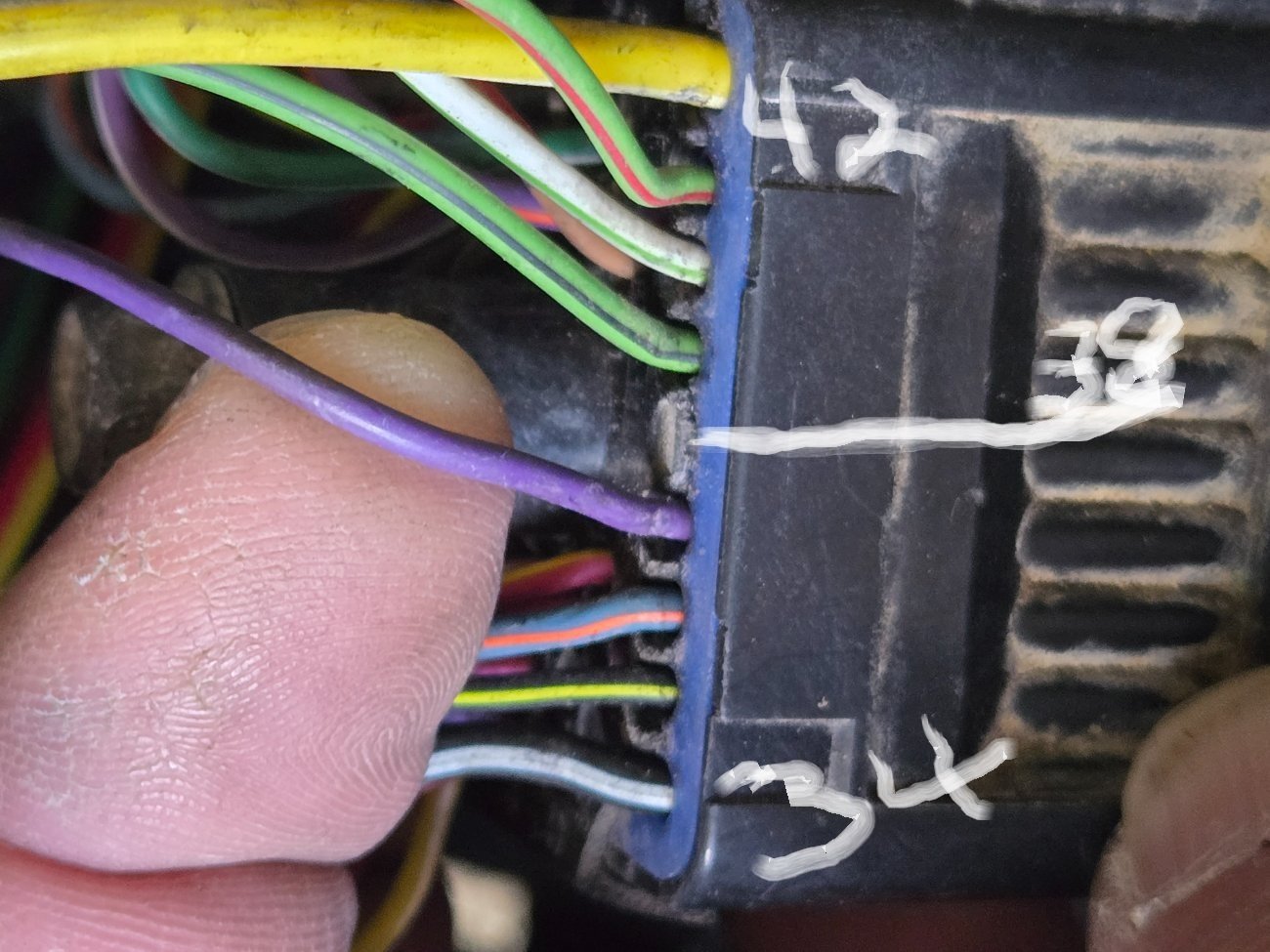

Junglejoe 5+ Year Member Joined Mar 9, 2016 Messages 501 Points 601 City Columbia Missouri Vehicle Year 2006 Transmission Automatic Today at 5:22 AM #1 Swapping a 2000 exorwr.into.my 99.ranger with the 2.5... Only wire I can't find info on is pin 38 in the 42 pin plug... anyone know what this is?? Attachments 20260219_163147.jpg 198.7 KB · Views: 2

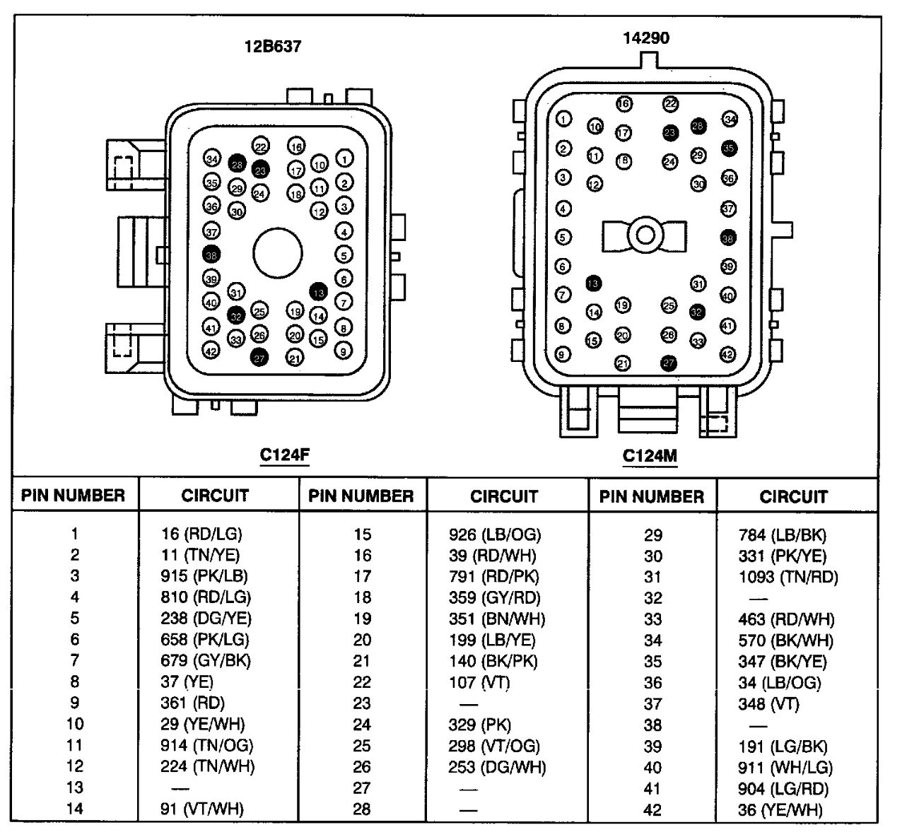

franklin2 5+ Year Member Joined Dec 24, 2019 Messages 4,983 Points 601 City Virginia Vehicle Year 1984 Transmission Manual 54 minutes ago #2 Not used? This is the 99 2.5 plug
