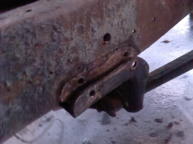

Then it was time to start removing the front axle.
Starting with the radius arm mounts. A couple of the bolts came off without too much trouble. The rest called for the grinder to come out and play.
'99 EB Explorer Official Build Thread

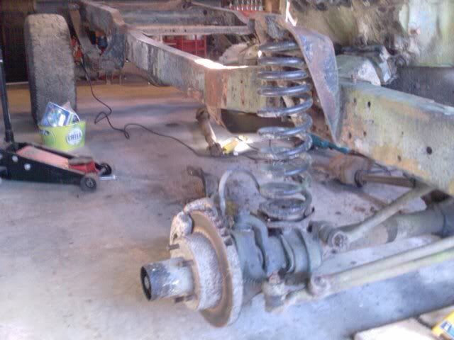

A couple shots of the axle sagging

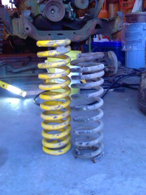

Here's the stock coil sitting beside the lift coils that came with this thing
I may be selling those. Not sure yet. I've been told that Cherokee coils are a much better ride for a small truck.

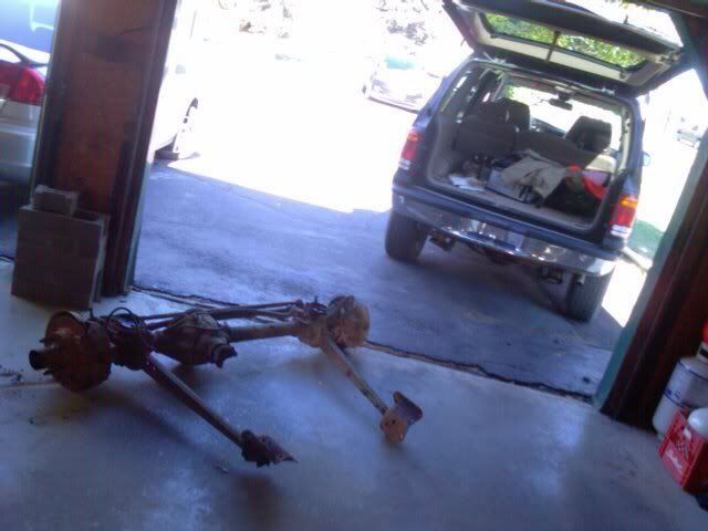

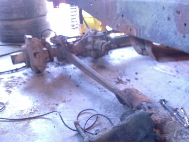

Started with pulling the axle out from under the frame. I used my tow strap and pulled it out with Stealth!
And here's the frame...axle-less

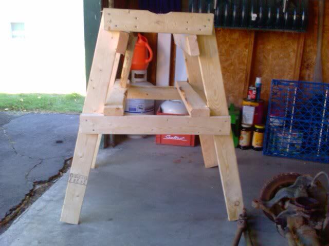

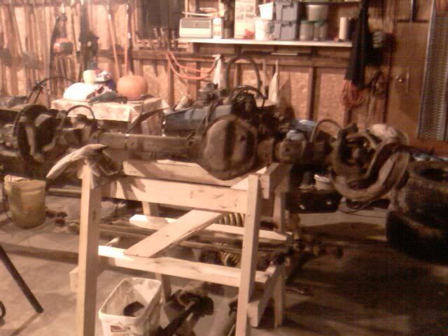

Then it was time to build the stand I plan on using to do most of the rebuild on
That took me all of 15 minutes to throw together.
From there, I had to pull off the steering and radius arms to lighten the load to lift that sucker on the stand. Sorry, no picks of the work, but here she is on her new home...

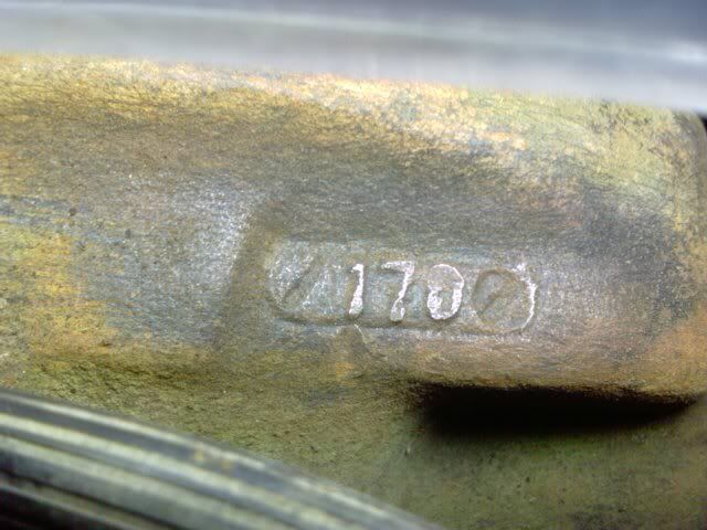

After some fun with a REALLY big wire wheel...I found a few numbers on it.
This one is on the backside of the differential to the right of the pinion.
This tag is bolted to the front of the diff by the diff cover bolts
If you're facing the diff cover, this is on the axle housing just to the right
This one is in the webbing just in front of the first number I posted
And this one is on the top of the diff towards the rear. Just behind the brake line splitter
So that's how it sits for now. Next will be the removal of the engine/transmission and rear axle.
