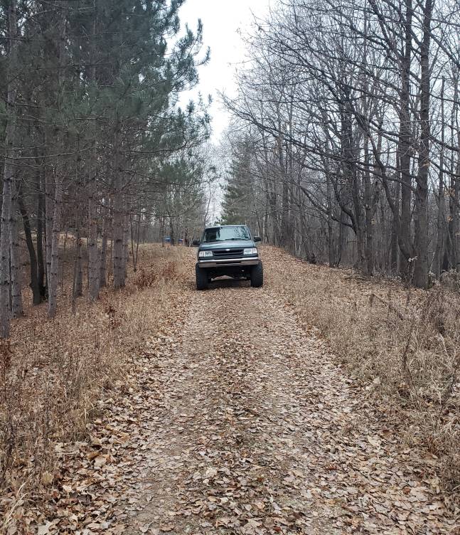

No more build updates yet, but I had the truck out to do some trail work in the woods.
I am considering some motor work while I have the cab off. The 4.0 runs great, but it has 205,000+ miles on it and I'll have access to everything with the cab off. Any suggestions?

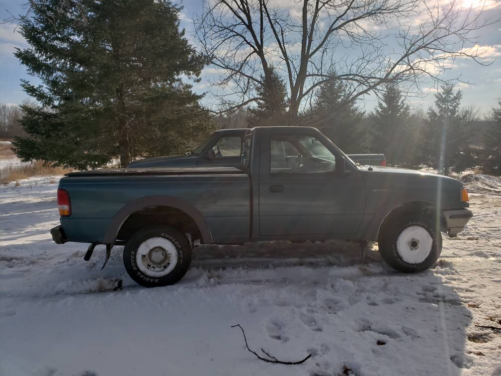

No progress, more projects. Picked up a '97 3.0 manual with manual transfer case. Plan to swap gears into my 4.0 trans, along with the manual transfer case, after having both rebuilt.
Had to make sure the transfer case worked properly by having some fun in the snow drifts...
