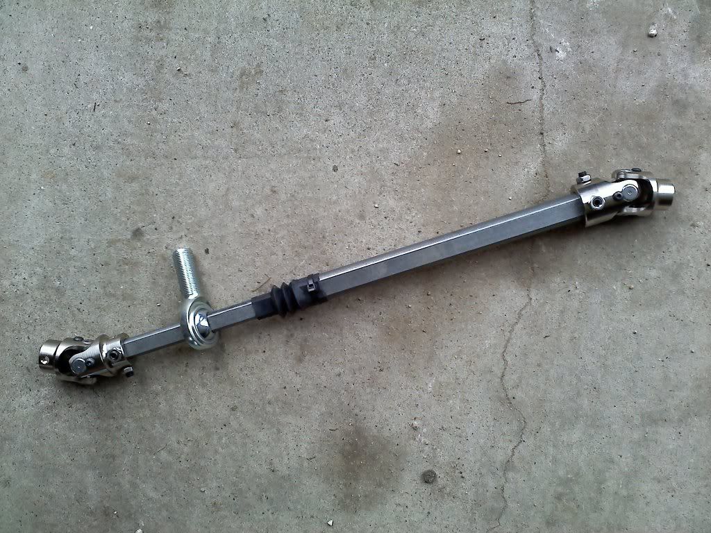

What did you use to go from the steering colum to the gear box?
Made a custom steering shaft,
Here are the joints and shaft I got, think they were around $200 got everything from jegs.
FR1716
Is the u-joint i used on the cab side. Its a
3/4 x 3/4 DD
FR1781
Is the u-joint that i used on the toyota steering box side. It is 1" DD x 11/16-36 spline
Part #450024 is the 24" telescopic shaft. one side is
3/4 DD and the other side is 1" DD. I did have to trim the shaft a little.
FR1810
Is the support bearing that i used to support the shaft.

Pic is upside down the support is next to the cab,
So where did you hook up that support did you mount it on the fire wall somewhere?
Just made a mount from the frame
Oh okay, thanks for all the information on how to do that swap
