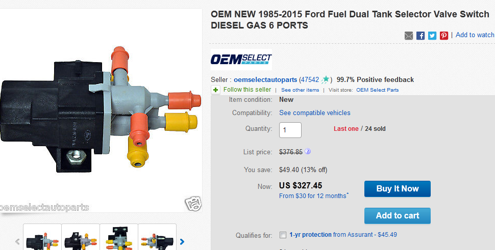

Does this truck have dual tanks by chance?
I bring this up because I've had the electric tank valve take a shit and not switch over. Also had a bud experience his crapping out in between tanks and causing fuel starvation issues/fuel return goofyness.
Just a thought! Hope you are making progress man! :beer:
