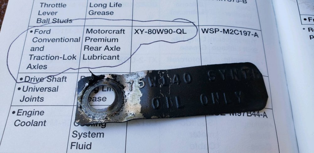

I planned on changing my differential fluid today. Manual said I needed 80w90 oil. So that's what I prepared to use. Took the cover off the diff and the tag clearly states 75w140 synthetic only. I'll put the 75w140 in it. But it seems like Ford should have known what to write in the manual.
Sheesh!
Running updates, PO swapped the axle, who knows why it is wrong.
The 8.8 did change from 80-90 to 75-140 around that year.
Must gave been running updates. I don't think either PO had any interest in doing mechanical work of any kind. I received a big envelope of receipts for everything that was every done. tire rotations, oil changes, replace faulty CD changer, tires, brakes, etc. They paid someone to do everything. This was just a frustrating afternoon. I made one trip to Advance to buy oil and friction modifier to go in the diff fluid I already had. Another trip to return friction modifier and buy the right diff fluid. Then a third trip when I found out I didn't have the right disconnect tool to replace the fuel filter. One of those trips wasn't my fault.

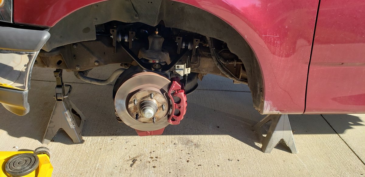

Finally tackling my bad ball joints on this truck. Several projects all in one. I also have a Belltech drop spindle lowering kit to install. So today's progress;
  • Front left corner is finished - new lower ball joint, new upper control arm, new shock
  • Because my new wheels have a lot of open space, painted rear brake drums to match body color, also painted front caliper and part of the steering knuckle that is exposed

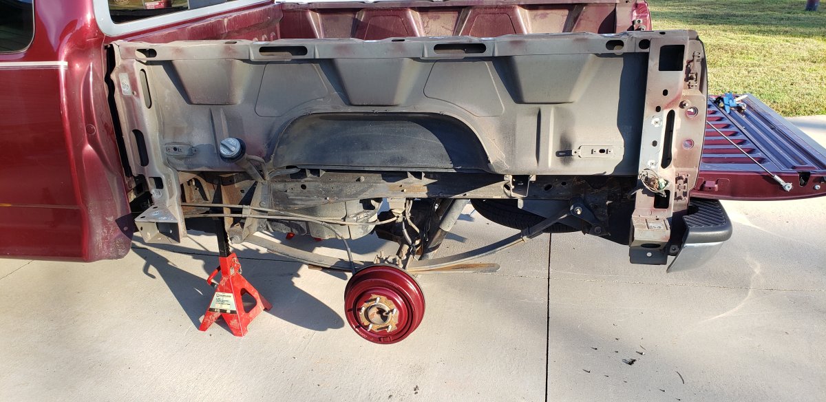

  • Removed fiberglass bed sides to give access for replacing front leaf spring hangars, shackles and the rest of the spring and shock work to be done on the rear.

Thanks. It's not a show truck. But it's pretty good. Finished the front today. Then I started the rear. Everybody says that to remove factory rivets like the ones holding the leaf spring brackets on, you just take a cutoff wheel and slot the heads of the rivets. Then use the air chisel to pop the pieces off. Then just use the air hammer or a hammer and punch to push the rivets through.
That's the biggest load of bull ever excreted. That's a good way to remove the heads of the rivets. But it ends there. These things act like they're welded in. I then had To drill them. I just drilled most of the way through, leaving something for a punch to push on. Besides, there was a fuel tank and fuel lines back there. Had to drill the 9/16" rivets with a 1/2" bit before they would budge.
Anyway. Got the driver side leaf spring bracket installed and rehung the spring with it's new shackle before my hunger headache and darkness convinced me to quit for the night. Still have to fight with 4 more rivets after the rain stops tomorrow.

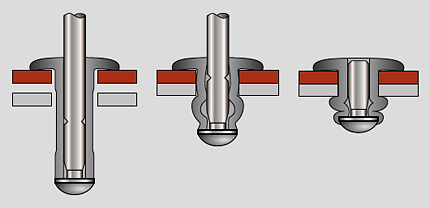

A properly installed rivet also swells to fill the hole to make sure everything is tight and there is no wiggle room. That is why they are preferred over bolts for OEM's.
This shows a pop rivet but the expansion principle is similar:
Really Ford? You want me to lift the bed in order to access the top nuts on the shocks?!? Are you kidding me???
Well I did it with the bed in place. No easy feat there. I'm convinced that Ford has an entire department of at least 500 engineers whose entire purpose is to make things more difficult for mechanics. The "Make Stuff Harder To Do" department.
Anyway, all I have left is to put the bed sides back on, put the rear wheels back on and have the alignment checked. Finished picture tomorrow.

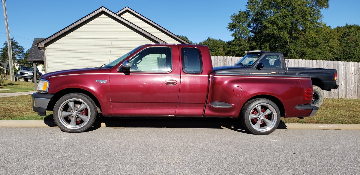

In my opinion, it looks much better lowered with the wheels tucked into the wheel openings like this.
