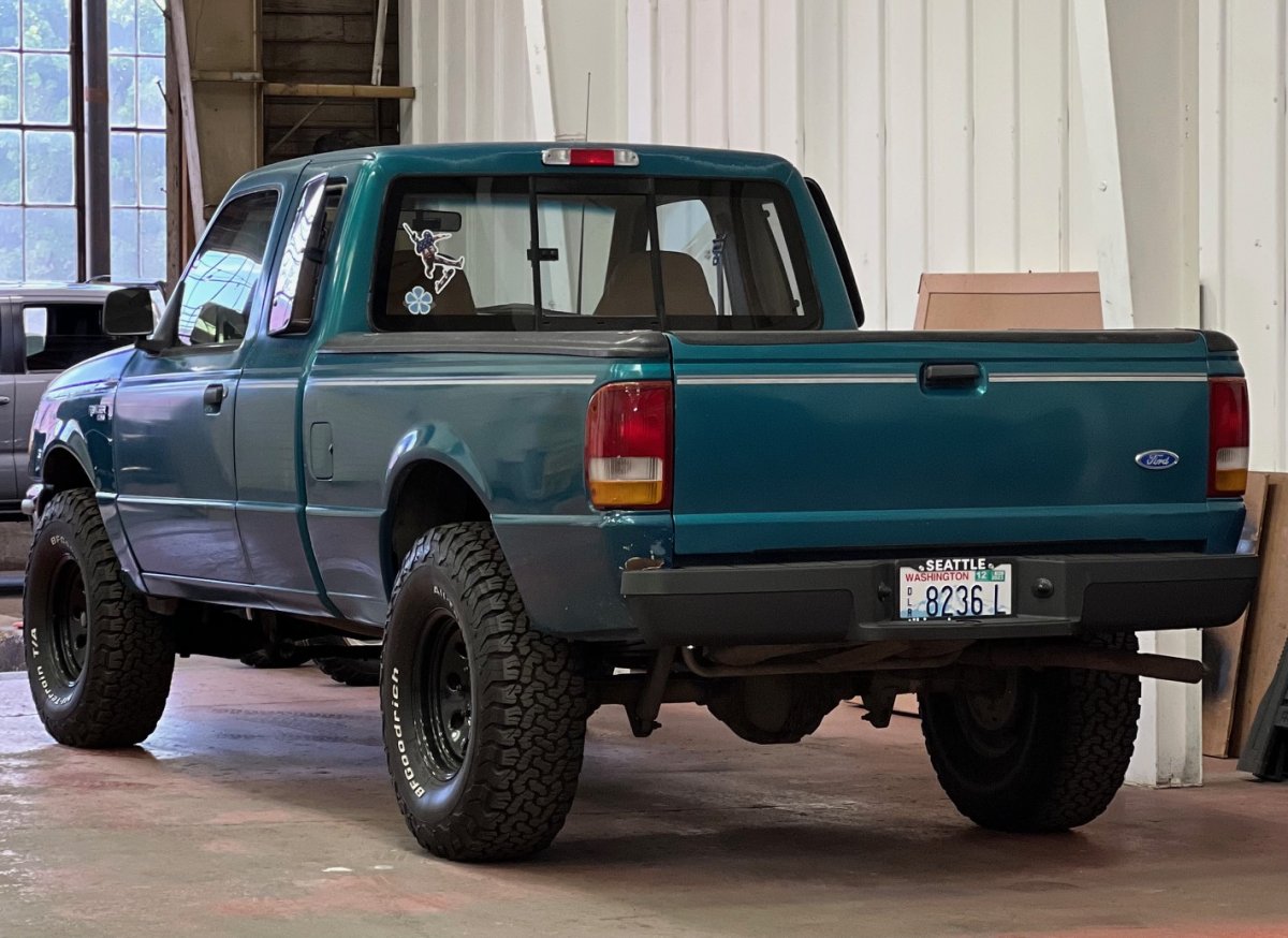

First post to any forum thread, so forgive any lack of protocol, but I could really use some good advice.
My 1994 Ranger XLT ext cab 2WD 4.0ohv w/ 5-spd, which was my first car in high school/bought new by my dad, has 388k on original motor. Runs, drives , looks great, aside from the recent bearing and crankshaft friction noise that's started to creep up.
It's time to dig into the bottom end, which I know is rare in these. Kinda proud that we got it this far. Anyhow, I can fix it, but still have an otherwise tired motor awaiting valve issues, could play the lottery on a used long block, or put a reman OHV in it. Or, finally V8 swap it.
I know an Explorer motor is best for fit, I know a M50D-R2 (from '97-'01 F150 V6) will bolt up to it rather than my R1 (that's original and due for replacement anyhow); I believe a 2wd donor will be better for this, though a 4wd will work (can someone confirm what the difference would be?), and I believe my OBDI truck will be simple to drop an OBDII motor into (can someone confirm yes or no, and how this is done? Just utilize donor's harness and computer...?).
There's lots of info online, but it never seems to be exactly for a 1994 Ranger manual-trans sjob (OBDI to II, auto trans donor to manual truck). Any info on someone else's '94 being swapped or 2wd manual being swapped would be helpful. Looking to start clicking parts ASAP.
