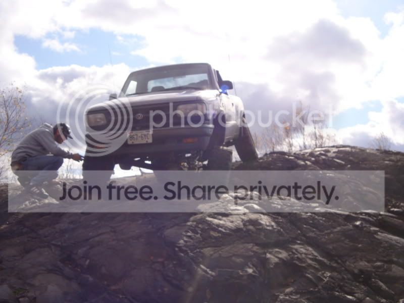

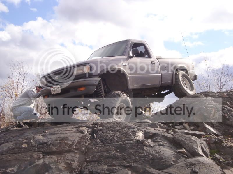

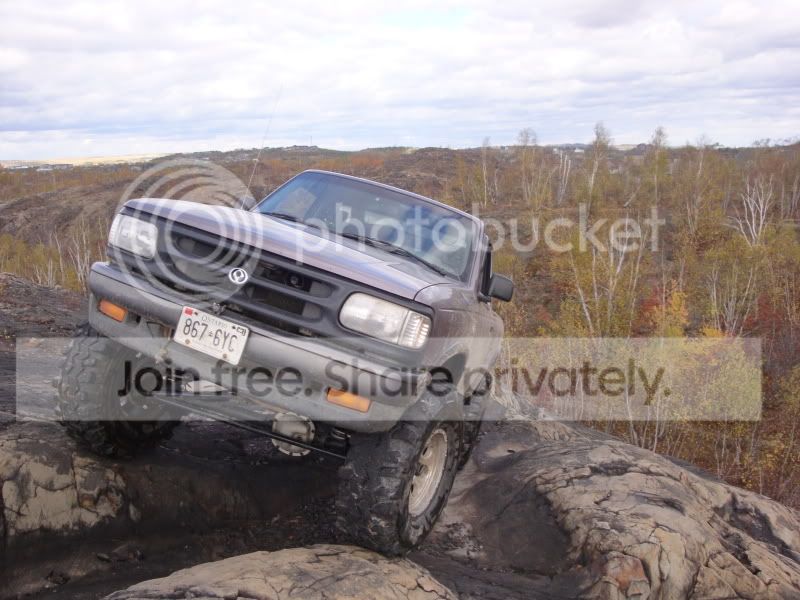

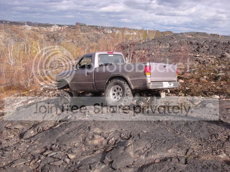

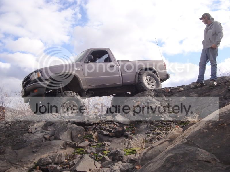

heres some flex pics of my 97 b4000 with a dana 30 sas,
parts list
-hp dana 30
-6.5 RC xj long arm
-4:56 gears and master rebuild kits front and rear
-Hp Dana 30 and new carrier
-USA alloy cromo axles with manual locking hub convection for the front
-31 spline ford 8.8 with rear disc
-tire Grover ..
- 36" tsls
- i just put some 315/75/r16 "35x12.5/" duratrcks no pics yet
-Rugged ridge Crossover steering

Thats a badass Mazda! You just dont see alot of the 93-97 Mazdas with a SAS.

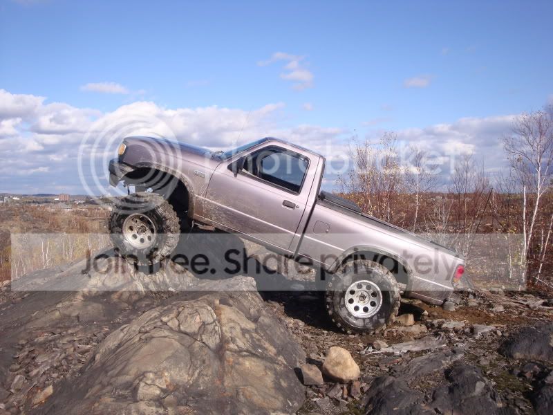

ya the sas was the best thing i ever did to the truck and with the new tires it rides soo nice, just i have bump steer ... i need a drop pitmin arm then it will drive like a new truck :yahoo:

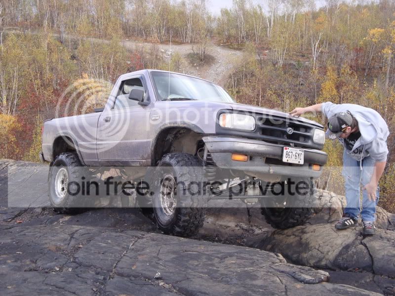

BTW, what did you do about the ABS stuff, and did you retain the stock master cylinder?
I'll be putting a narrowed HP 44 in mine late this year or early next.

bad ass where did u get the cross member your arms mount too
It's the rough country xj cross member just modded to fit ... Cut room for cats and cut old tranny cross member and welded to the new jeep one for my tranny mount and it works good
