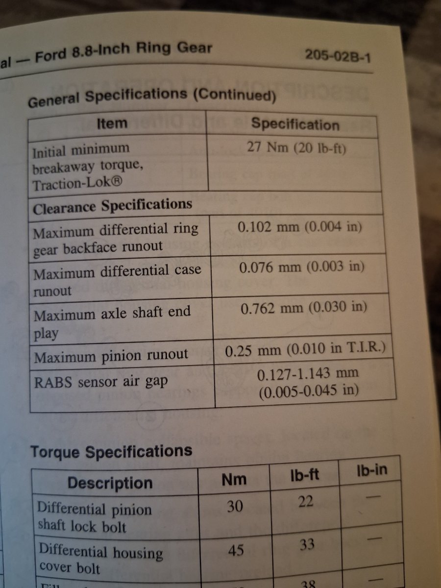

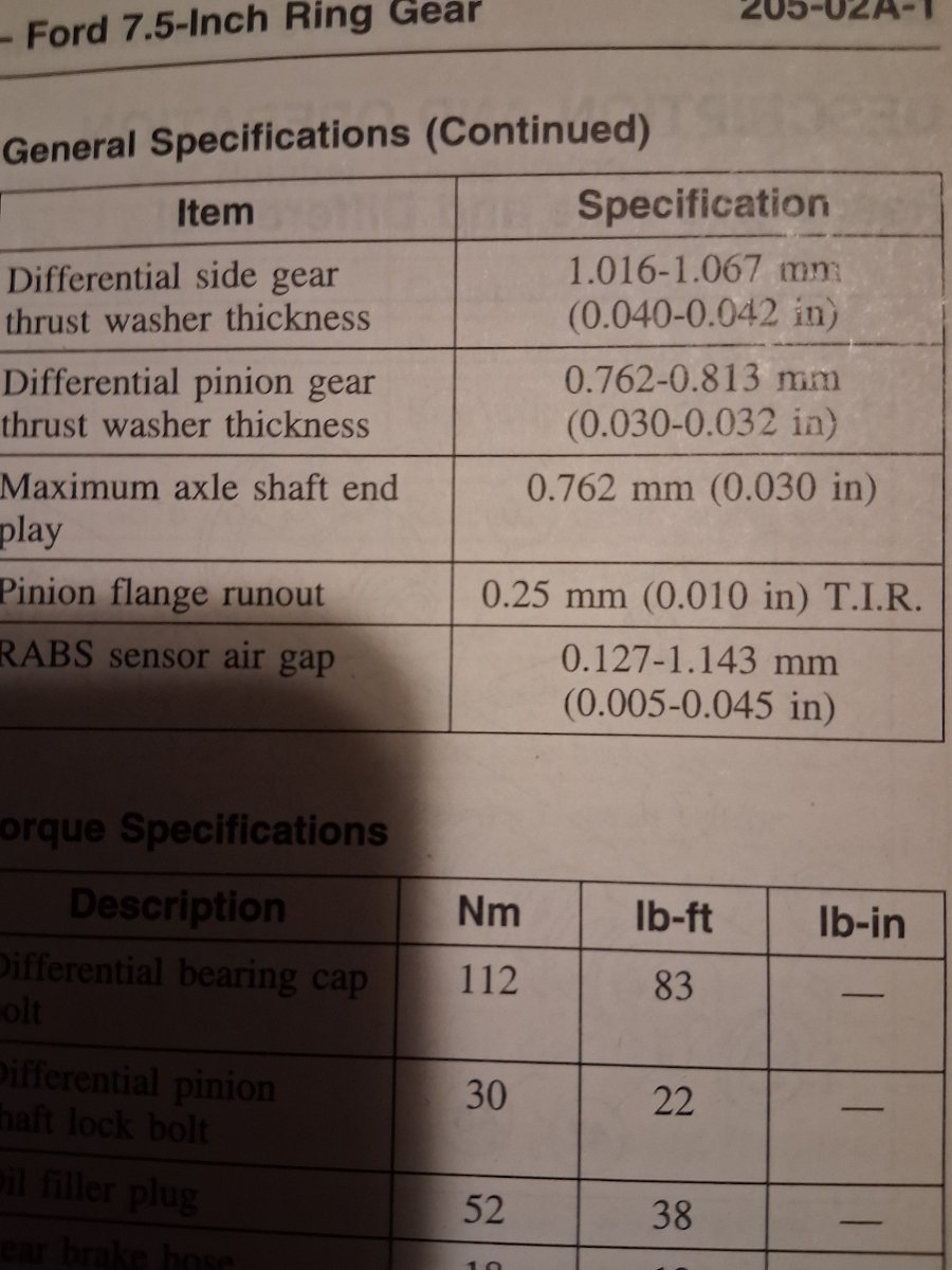

Greetings members,
Where can I find rear axle free play specs? How much is acceptable? I found some threads where the post said the axle moved 1/4" in and out and a comment saying that is normal. 1/4" cant be normal!
What would cause excessive play, Worn "C" clips? Really wanting some factory specs to know for sure. I have a 16th" on both sides and a rotating scrapping sound on turns. Not a typical wheel bearing sound.
Thanks
Thanks
