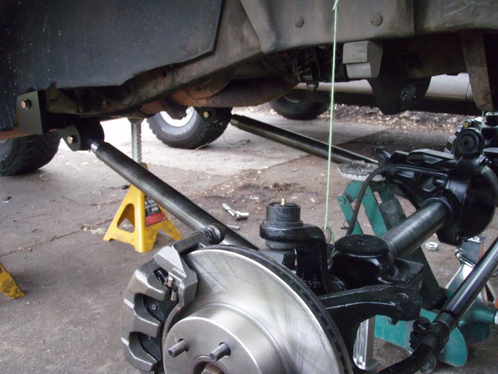

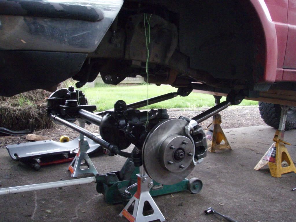

got the link mounts burned into the tranny crossmember and got it mounted in the truck for the last time. been working graveyard all week with school so its been kicking my ass trying to get time to work on the truck. ill be making the lower links this afternoon when i wake up. if all goes well ill get both lowers and the upper link done before work tonight. the plan is to get the coils in and the trackbar done monday and bleed the brakes monday when the banjo bolts come in. hopefully have her on the axle tuesday and measure for my front shocks.

well had a productive day after i got off work this morning :/ haha got my lower links built and under the truck. also got the EB coil springs in and got them to fit pretty well. im happy with today. time for some much need sleep after 30 hours of no sleep.
finishing the upper thrid link tomorrow. ordering shocks, and making my panhard bar. trying to get it rollin tomorrow night. i wante dto get it completed in a week...but i might miss it by one day.

got the upper link made and tacked in. fits real nice. got the coils to fit real well in the buckets and made retainers for them. need to make the lower retainers tomorrow and build the panhard and bleed my brakes and she'll be on her feet!! ordered RS9000xls they should be here friday. pictures tomorrow

all done :)) just need to do some alignment and shes on the road!! pictures later tonight once this damn monsoon of a rain storm slows down. i was blessed with almost a full day of sun though to get it finished.
