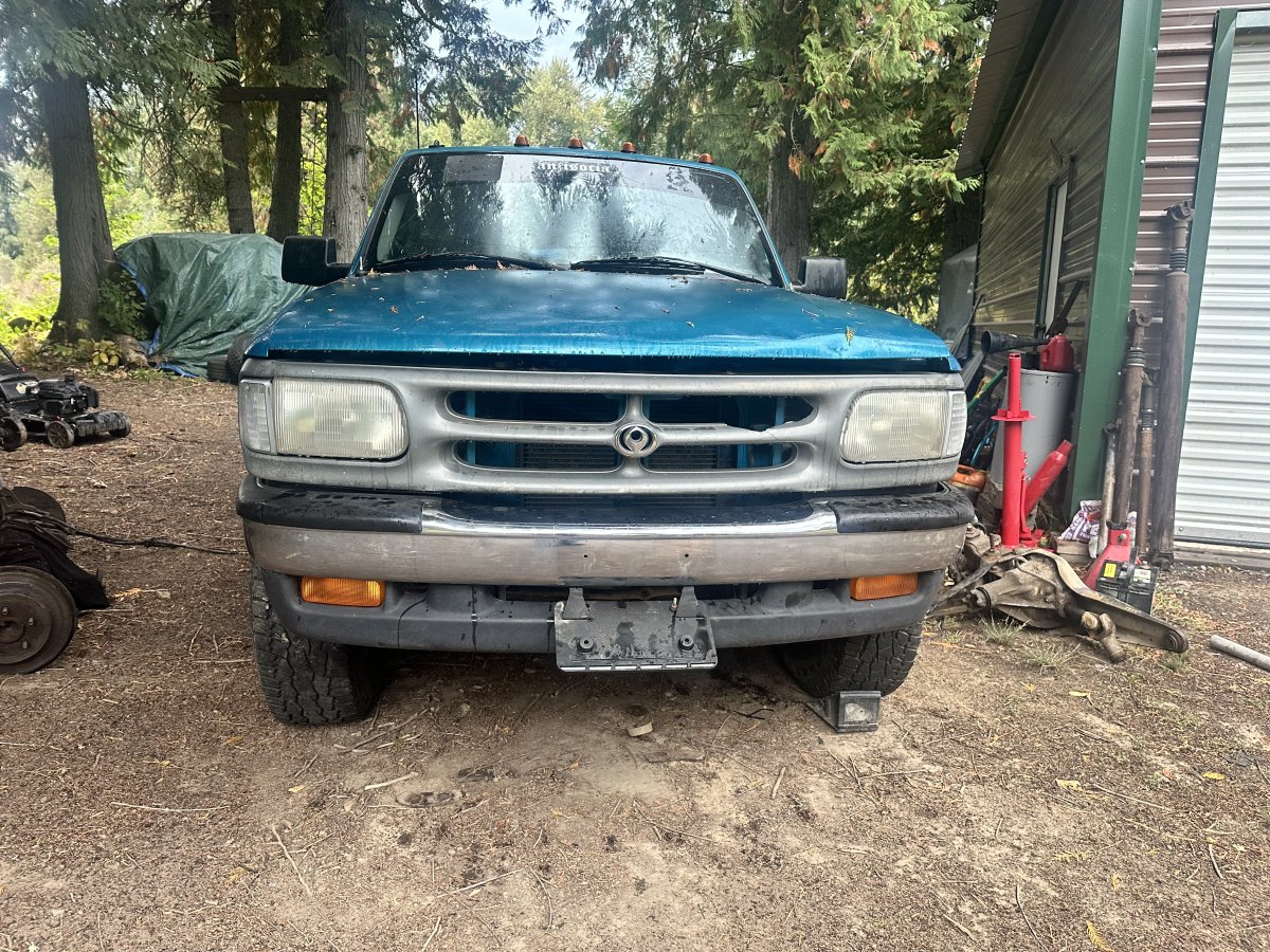

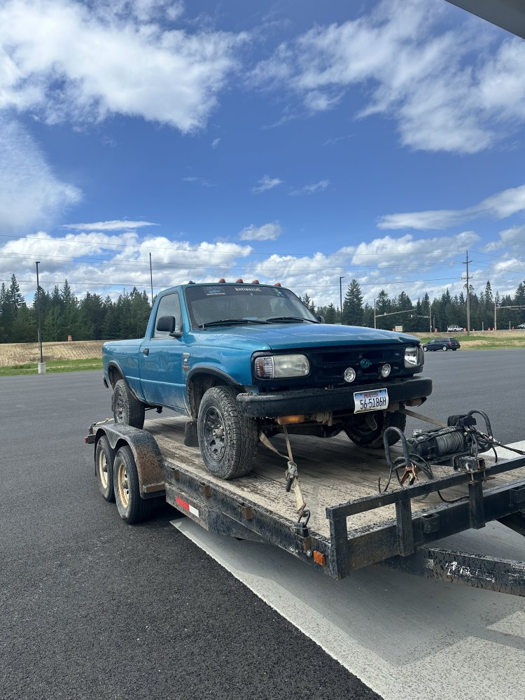

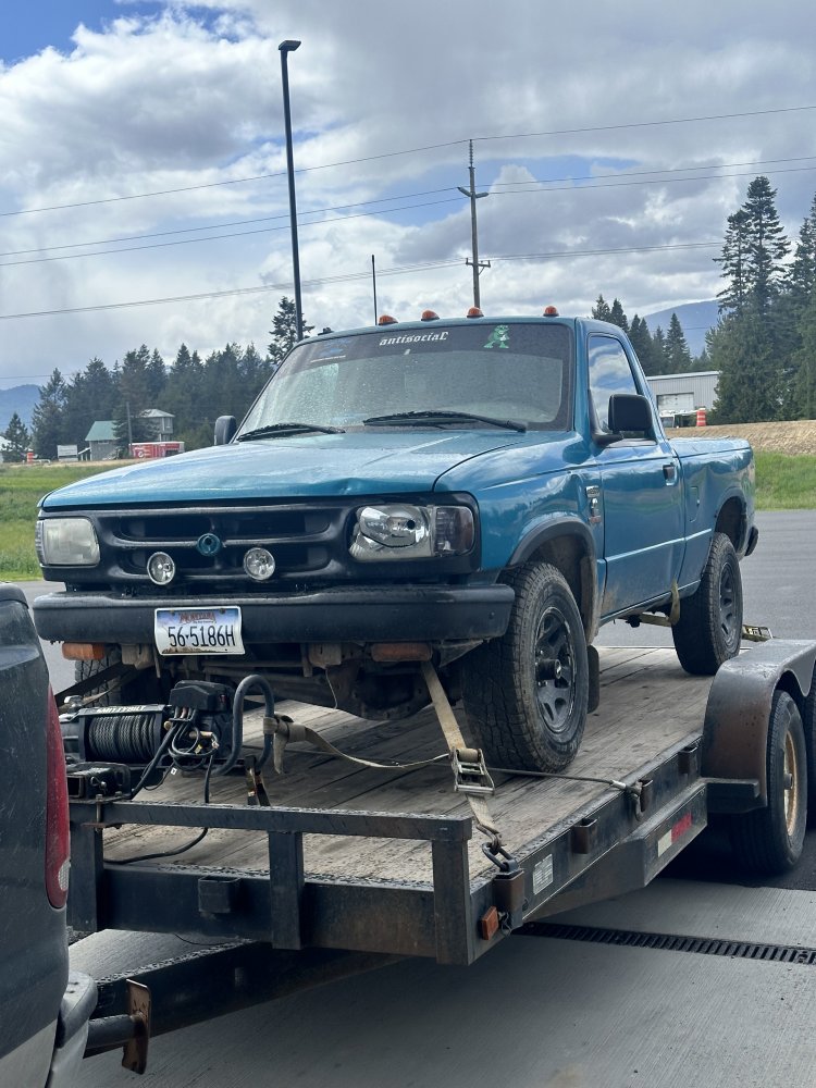

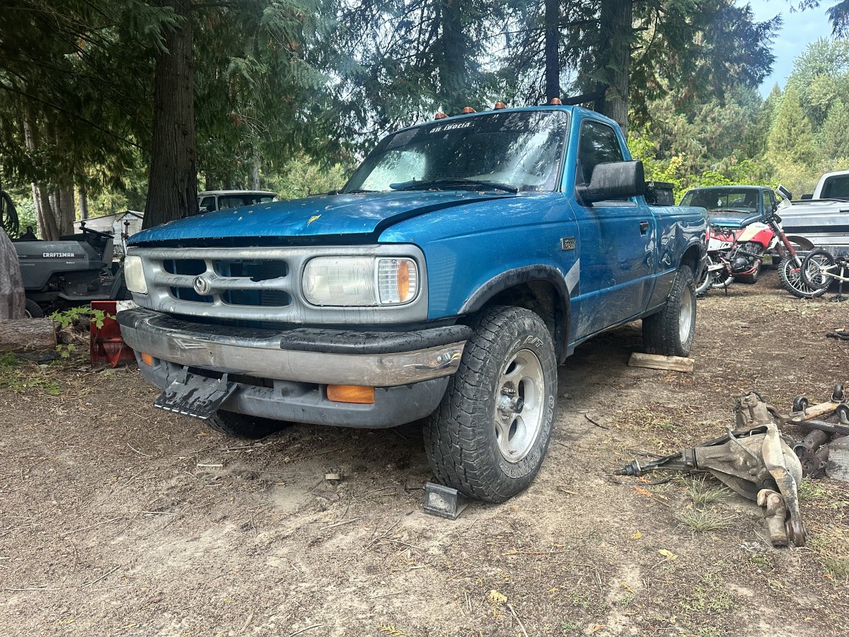

Can’t believe I didn’t post pics of the little beast! Here she is in all her glory! Lol
  • 95 b2300 no start ?

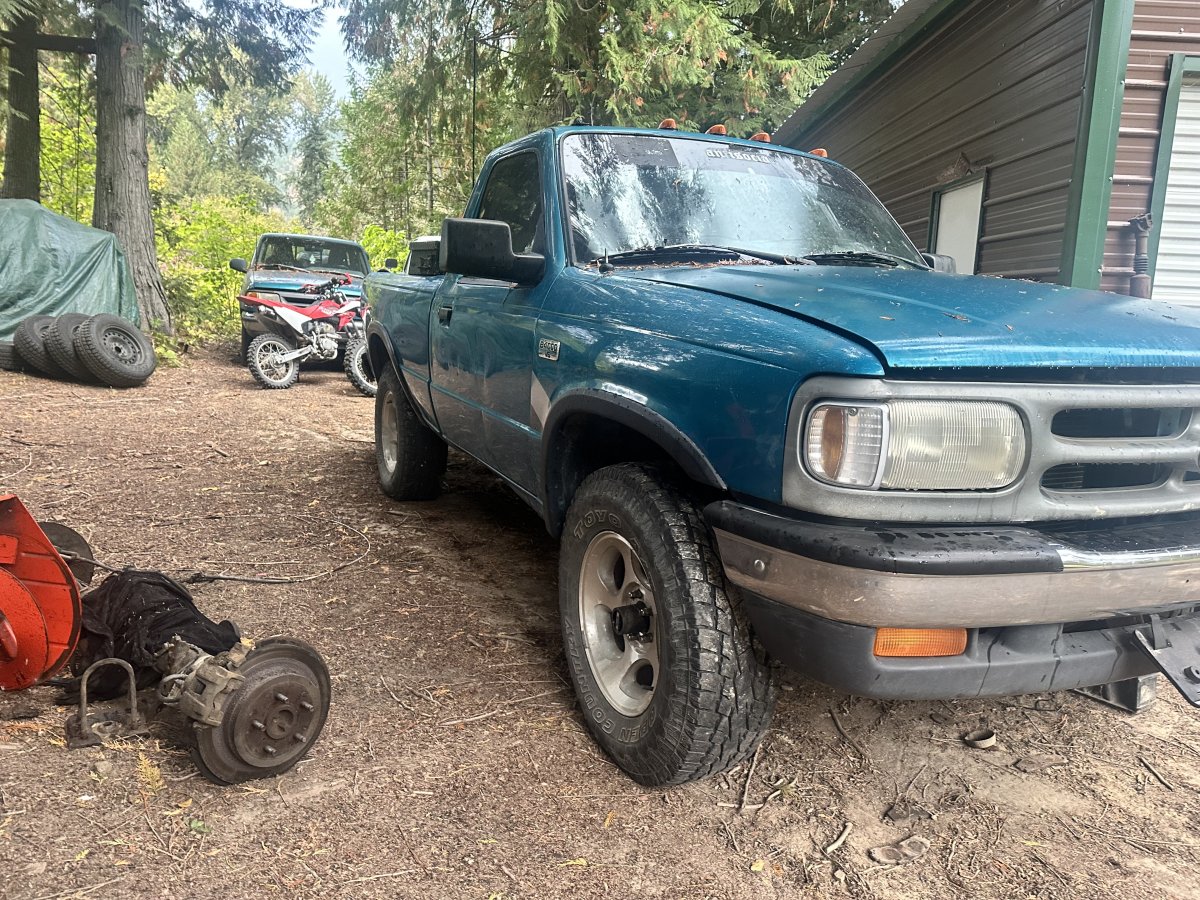

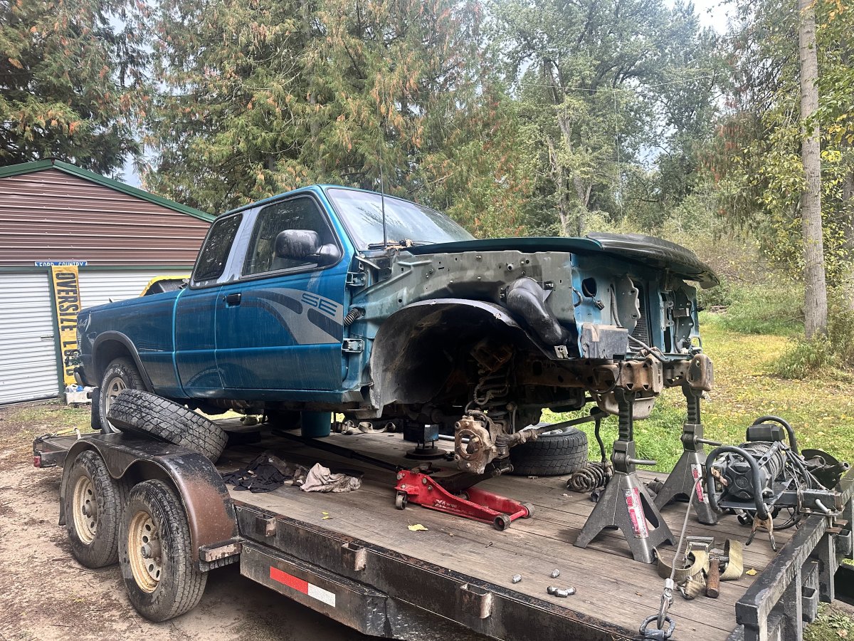

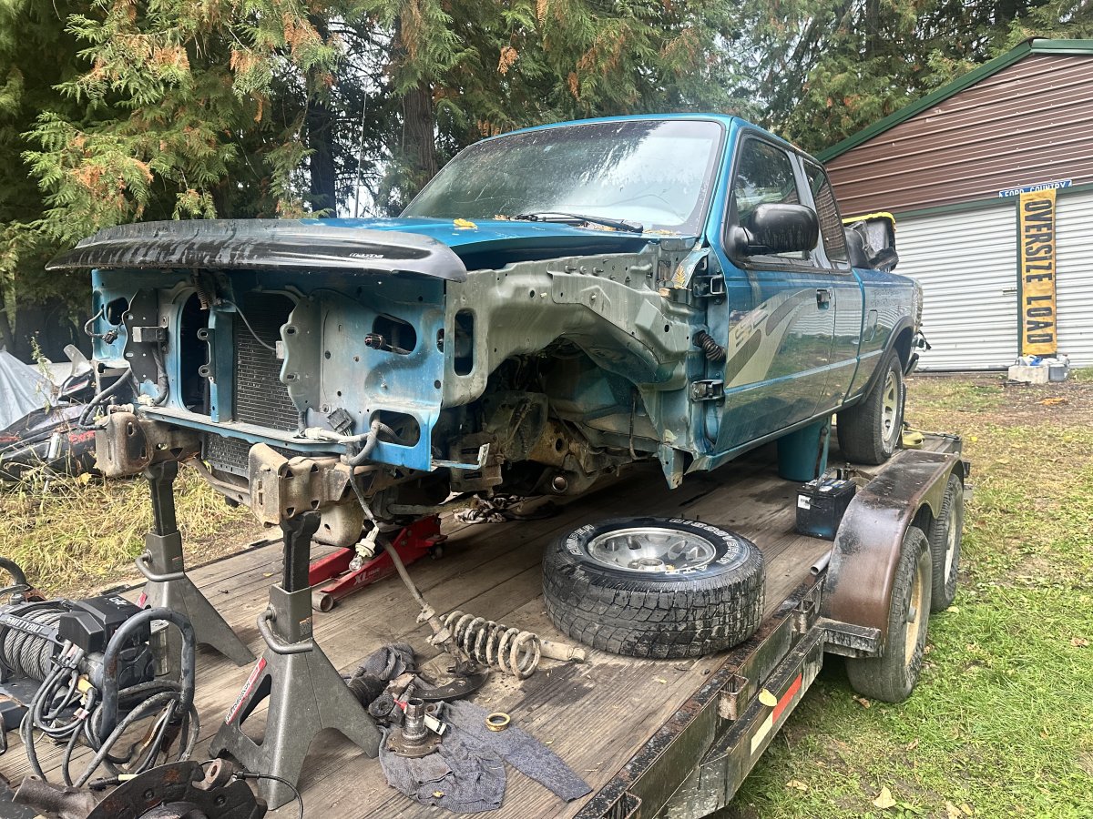

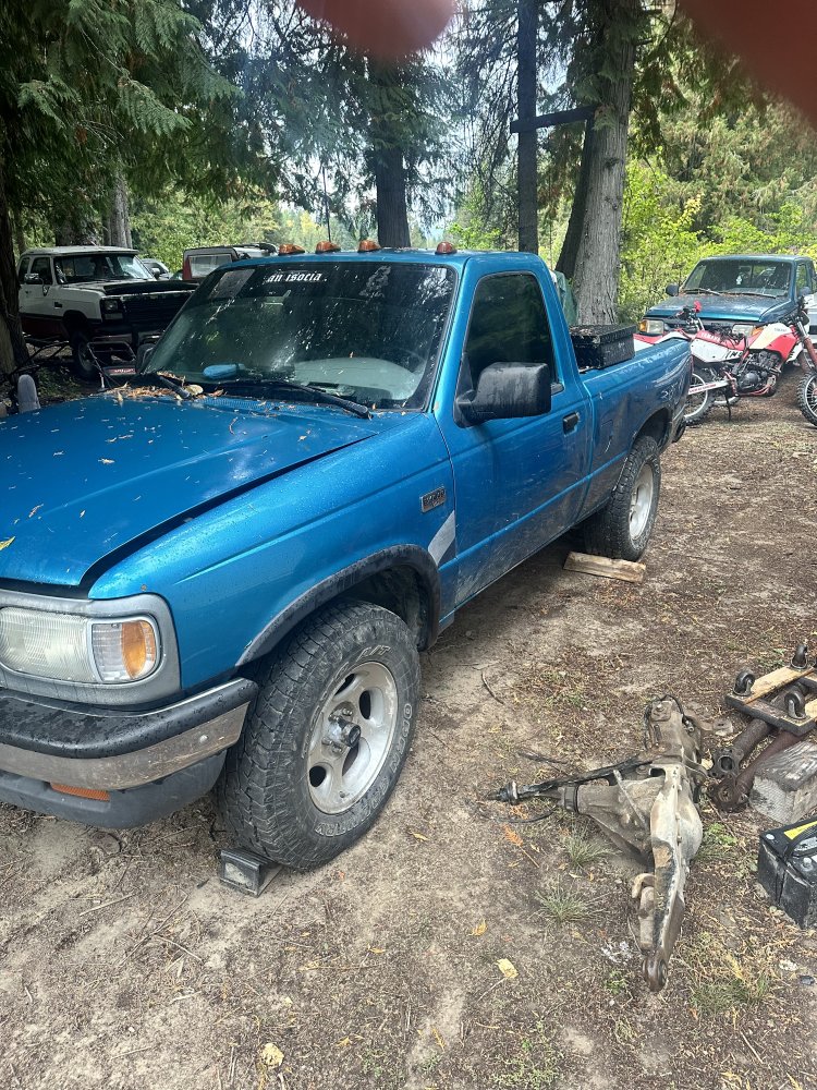

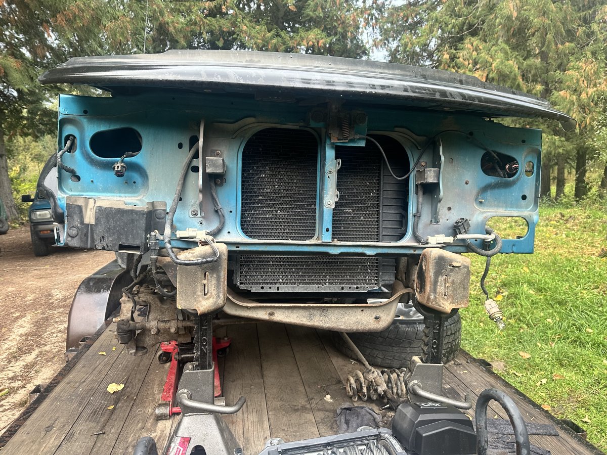

So I casually started looking at the front end on this truck and let’s just say I’m glad I did.
The front driveshaft is about to fall apart, the ball joints have a ton of play, I snapped the shock stud off the radius arm, the u-joints in all the axle shafts are completely thrashed, the radius arm bushings are thrashed, the bearings were loose and howling, the rear u-bolts were barely hanging on, all 4 shocks were leaking and bad, picked up a nail in 2 tires, front diff has definitely seen batter days… and the list goes on.
I happened to have a 1997 Mazda b4000 parts donor so my day consisted of swapping out the whole TTB with new radius arm bushings, wheel bearings, mile marker hubs and hardware, new (to me) tires, new/used spring plates and u-bolts for the rear, new shocks, and on Friday I’m doing a dual core radiator, and the timing belt, water pump and seals etc….
Also completely re did the front clip as well and painted the radiator support….
This truck has kicked my butt for the last few days but it’s coming along.
