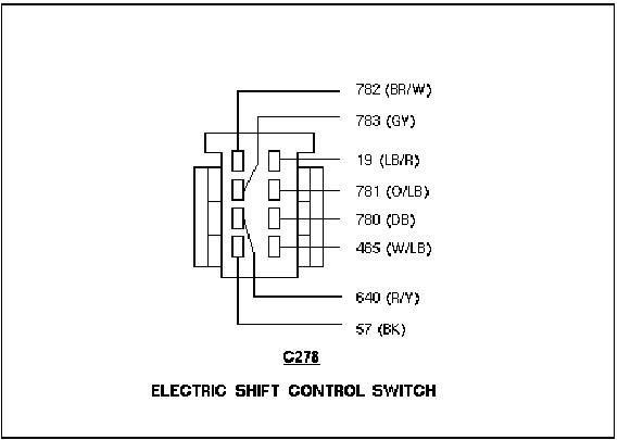

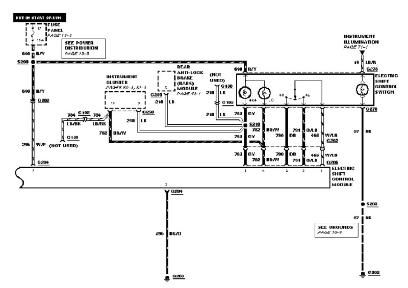

I posted this in another section but think this might be a better area. I am looking for a picture or wiring diagram for a 1994 4.0 4wd switch. Someone ripped the dash out and some of the wires pulled out I need to be able to place them back in the harness
I only have one for a 92 but it may be the same.
  • 94 ranger 4wd switch diagram
That doesnt look like it. I think it has eight wires going to it. Even a photo world help of the clip and harness if anyone has one
This one has 8 wires to it.
Here's how the connector is wired.
