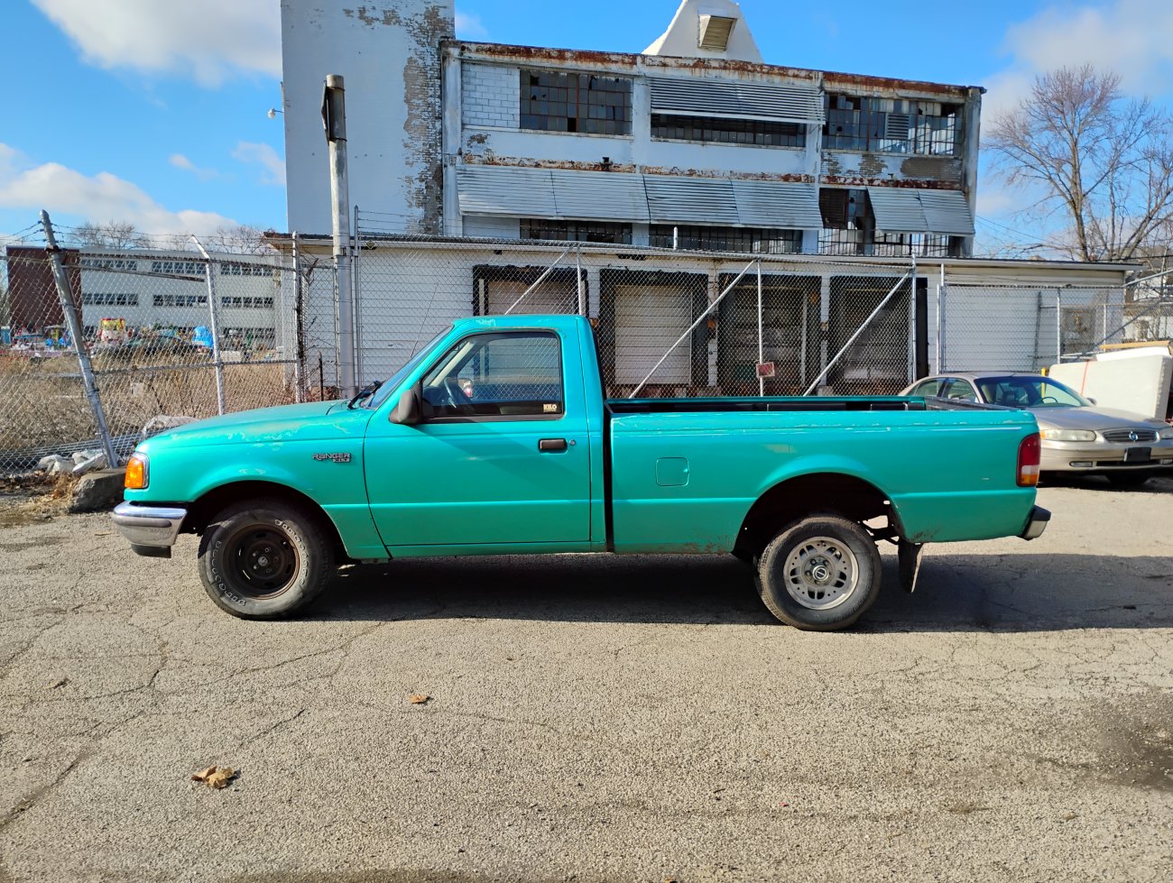

I live in Dayton Ohio I do know that for some people it's late. And I too have a 1994 4.0L automatic regular cab 2wd long bed.
