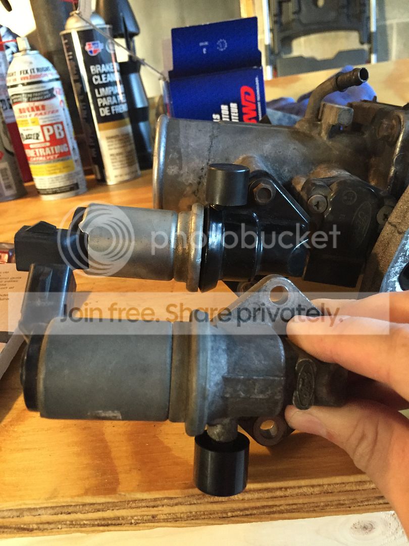

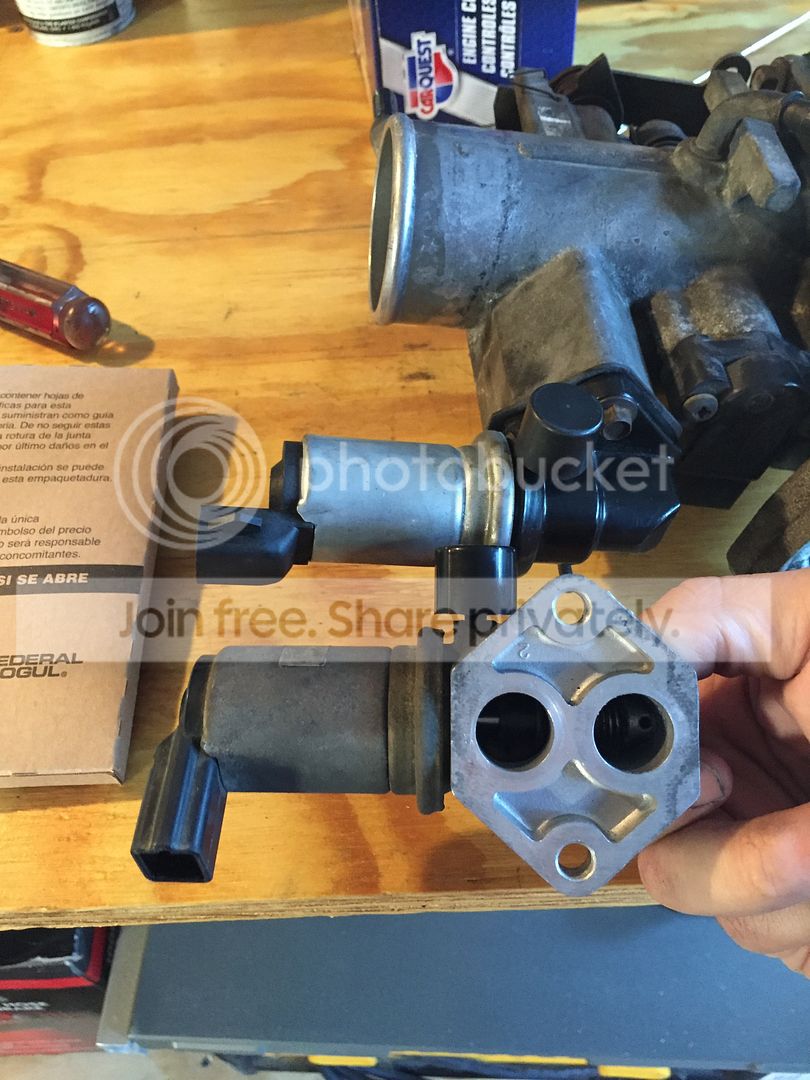

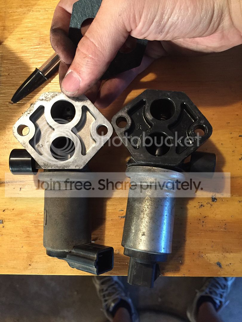

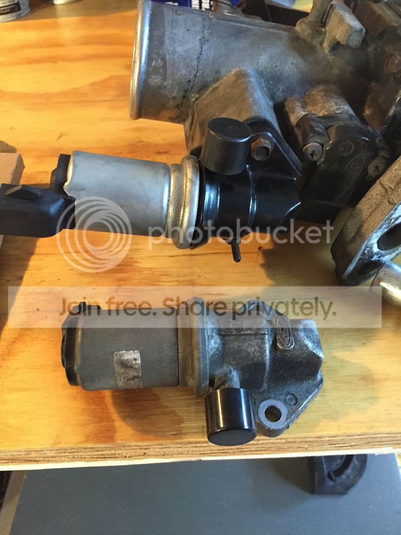

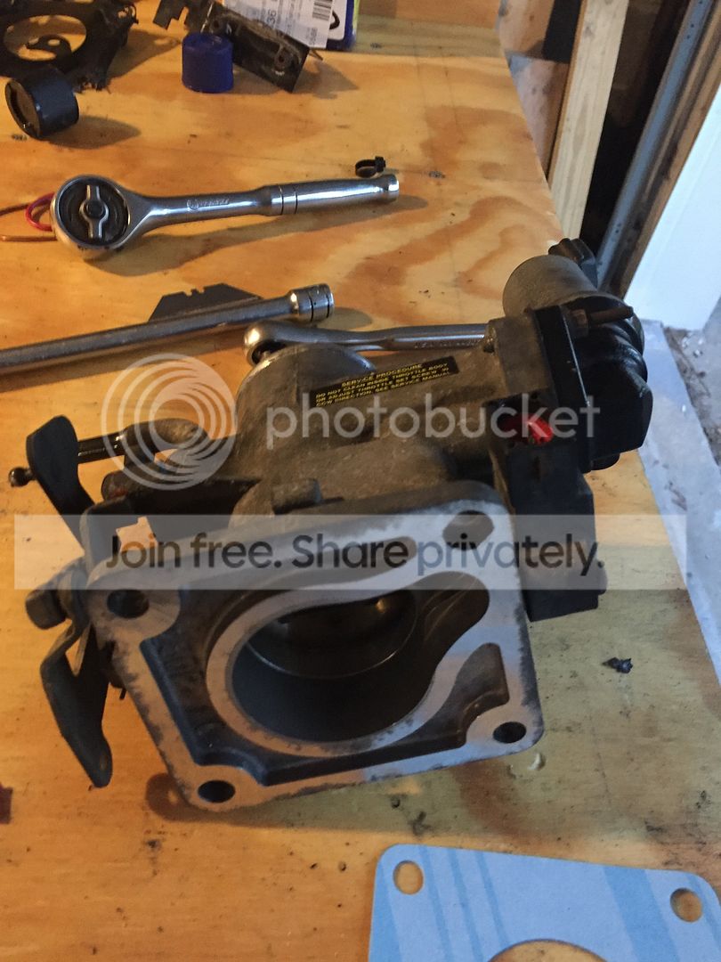

I did notice something...the IAC you have in those images has that vent thingy on it that I can't remember seeing on the one I had...they must have made a change in the design for something along the way...I had mine off investigating the misfire and wonky ilde and I cleaned it up and reinstalled it to no avail...but that vent thingy...where at first I saw you had a plug on it and then the vent...
Did it make any difference with the plug or did you try doing that when it was installed?
Excellent point Mark. I did not try that on the running engine. The plug was for the hold on the carb cleaner. I have the little filter back on there. My old IACV did have the little filter. I actually looked at it last night. I'll post pictures tonight.

Mark, here are the IACV photos.
94 2.3L w/ 17# injectors - Intermittent Rough Idle

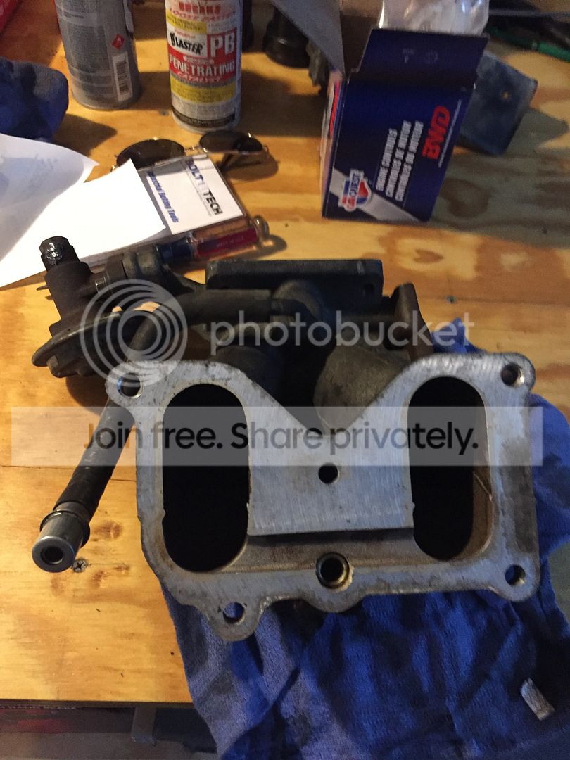

So while I had everything apart, I swapped the old EGR back in. If it runs fine tomorrow, the new EGR is going back. I did notice when I was cleaning out the upper intake manifold that there was a TON of carbon buildup in the EGR channel. I used the tube brushes to ream it back out.
Before:
In the dead center of this photo is were the channel enters the manifold. It was almost completely plugged.
After:

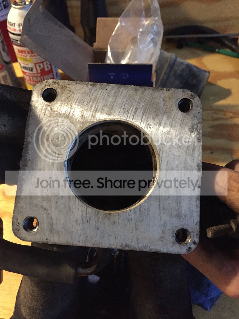

I took a photo of the surfaces to make sure I did not miss any gasket pieces.

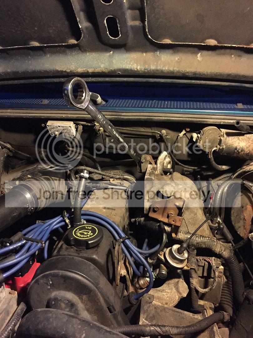

And finally a shot of the EGR. I used a 1 1/8" wrench. I'd guess the actual size is 1 1/16" or unknown metric size (I don't have a wrench that big) if anyone ever needs it.
