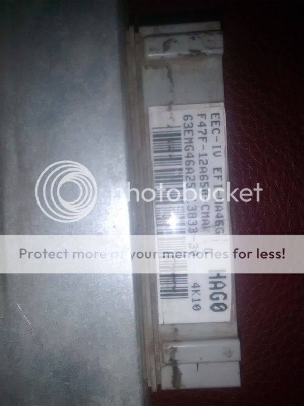

For posterity here are pics of the ecu tag;

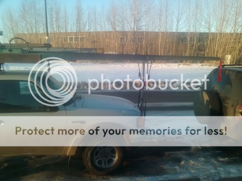

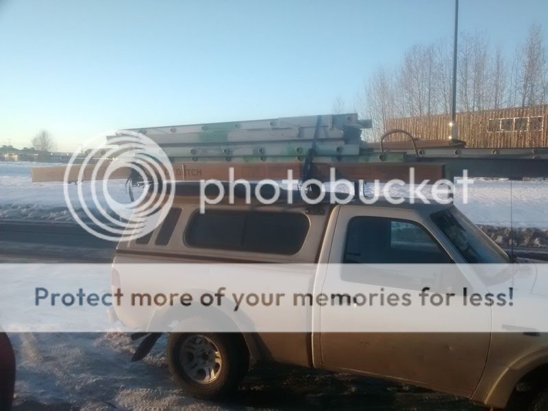

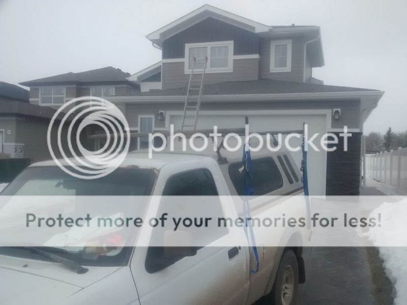

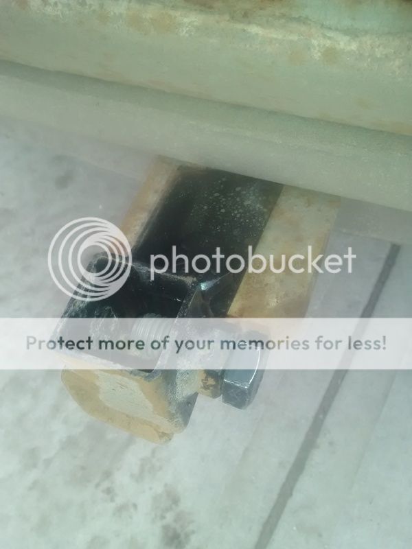

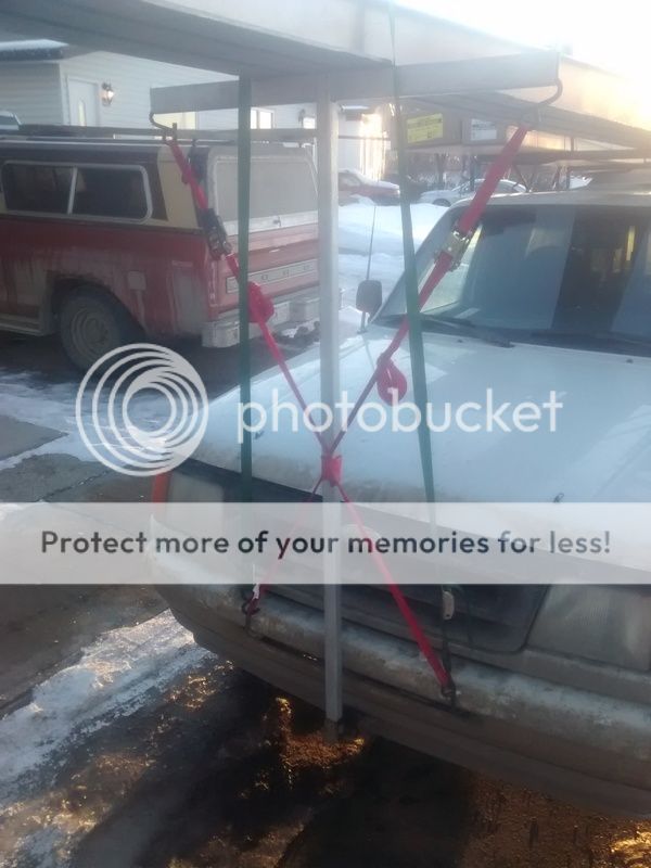

And some pics of my topper with home made roof racks;
Loaded up;

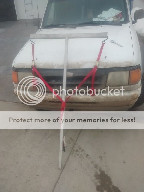

And a socket and brace for the front for long loads;
