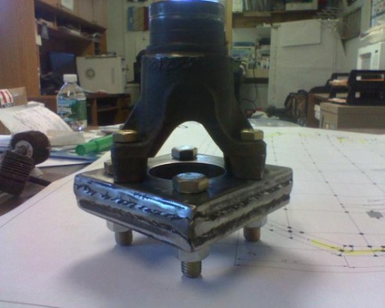

my driveshaft was to short so i made a spacer/adapter, looks a little sketchy but my truck never goes on the road and so far i have had no issue with it. drilled and tapped a 1" thick block, mating the stock driveshaft yolk to the ford 9" yolk. i have also seen people use the end of the driveshaft that was originally with the 9" and sleeve and weld it over the ranger driveshaft, also a little sketchy.
