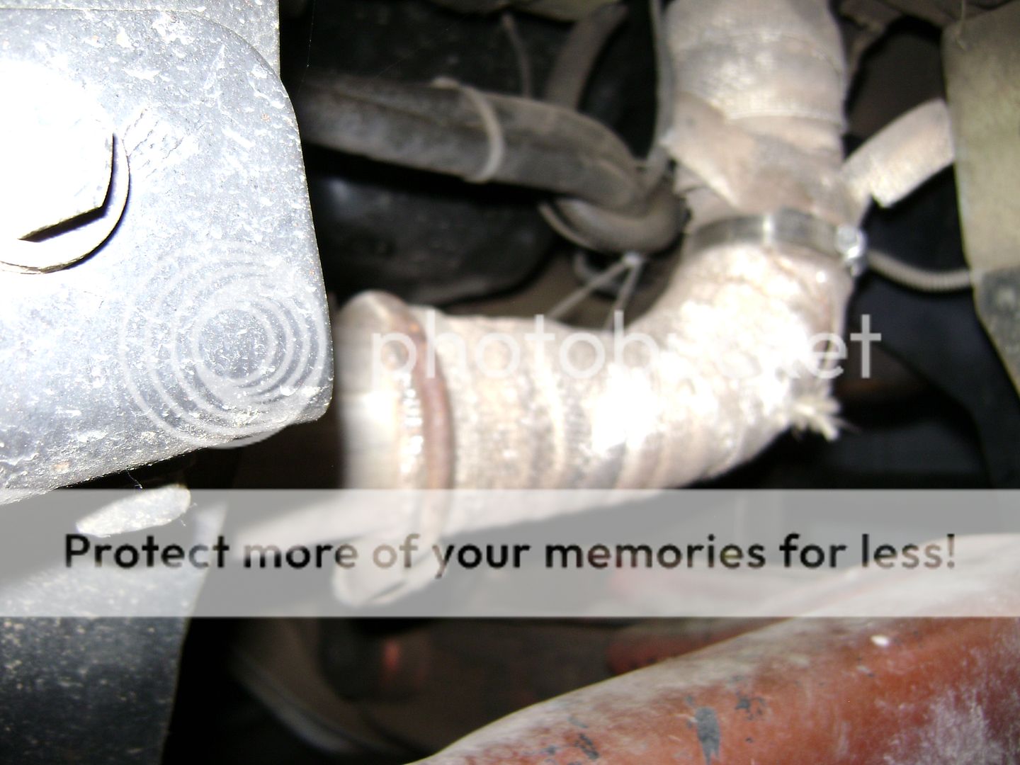

Been watching this for a bit and thought I would chime in. I used the 89500 and the only time I ever had any fits was when the engine wasn't quite square in there. Here are a couple of pics(sorry it was dark when I snapped them, if you want more let me know and I'll get some during the day time).
I have wheeled this truck hard enough to break the front lift brackets and I haven't gotten close to the exhaust pipe. The starter falls out on the ground when you take out the two bolts.
Not disputing anyone, just letting you know of my experience with these headers.:icon_welder:

Yours is a 4WD, that's the difference here. We've been arguing here on 2WD's. Big difference in front suspensions. :icon_welder:
