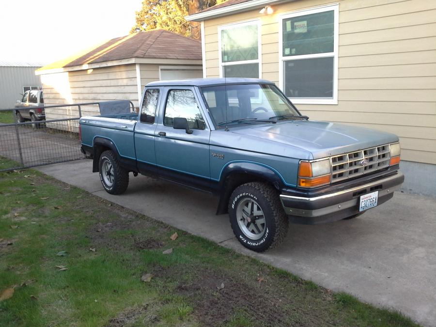

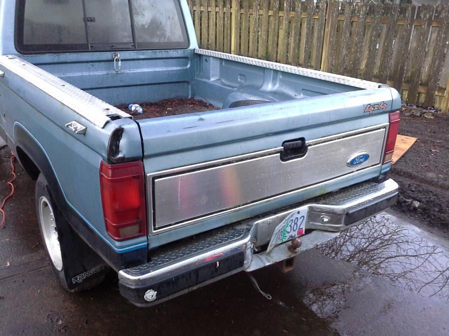

Not bad for $150 you can see the only dent on back corner
as far as i know, theres only the 1 fuel filter there on the drivers side framerail. looks really nice, very clean/straight truck. i would get as much of the old fuel out of it as possible, put fresh in, might have to do a 2nd fuel filter change after a couple of tanks of gas have been ran through, maybe have a bottle of fuel stabilizer ran through with the first tank to help clean any varnish from the old gas from the lines and injectors.

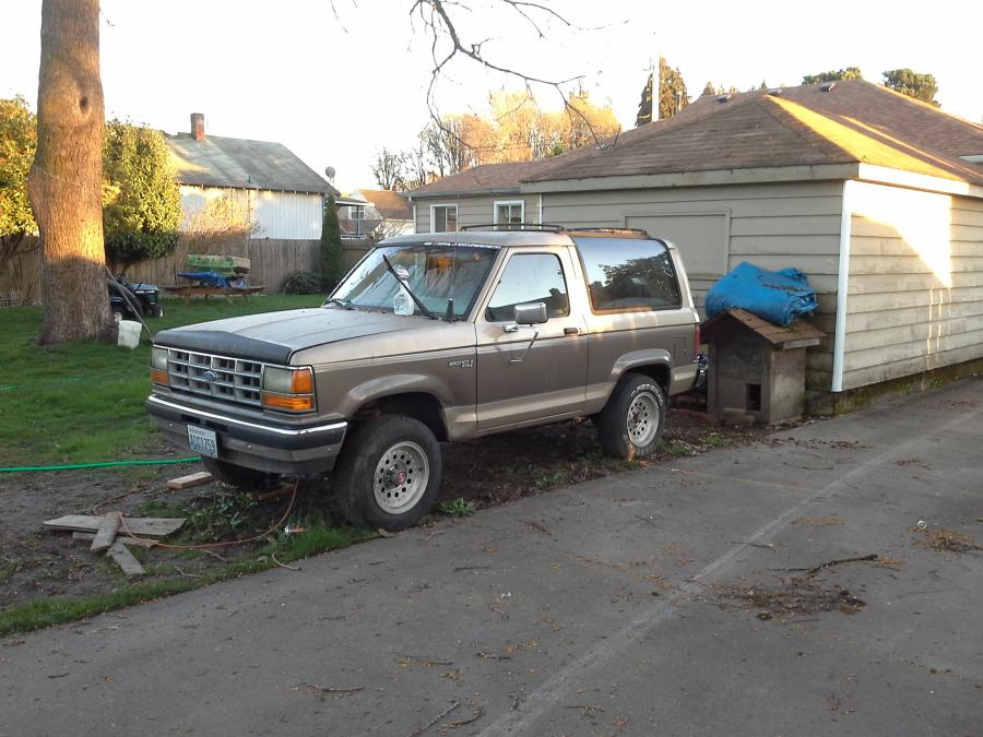

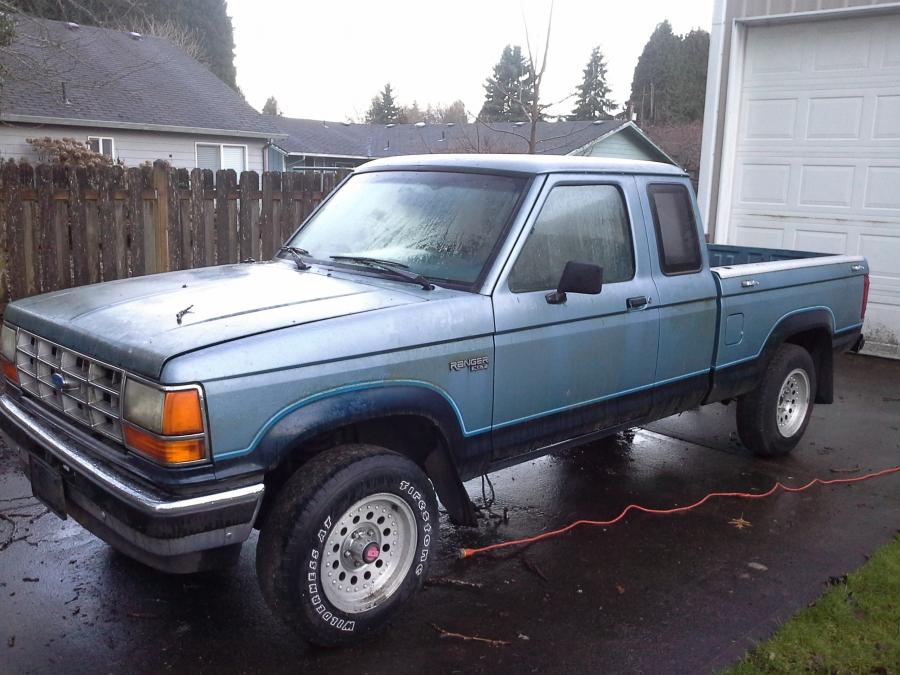

Well got everything put back together today, still have to bleed slave and brakes, and put new muffler on but then it should be road worthy. After tearing everything out of the truck to get to the slave cylinder found out the the retaining clip that holds the line in was put in backwards and all I would have really done was pull the little clip out and turn it around. Oh well found lots of other things wrong when I did it, like three of the tranny to block bolts were loose and there was one missing plus didnt use any lock tight. Put the rims and tires off my bronco 2 on it also the rear tire on the bent shaft side was bent so I plan on driving the truck, havent decided what I am going to do with the bronco yet. Always wanted to cut the roof off of one, only one project at a time. Also washed it, it looks better than I thought clean, will post picture tomorrow. Well have taken enough of your time.
Well here is a picture of it washed with the different rims and tires. On the slave that I couldnt get bled, I ended up taking the resivor black rubber and loosely put the cap on and pumping it until all air was out of master, worked pretty good. Here is also a picture of my 89 bronco 2
