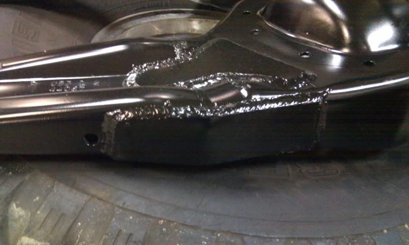

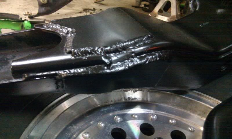

and why are some people saying the cut and turned beams are a bad idea??? 4x4 prerunners do it all the time. dave at threat motorsports sells dana 35 beams that have been cut and turned. its done to get rid of the lift brackets so you dont put a hole in the top of the diff. Thank you for the pics of the jig you built, im building my jig on thursday so i can get mine done..great build!!!

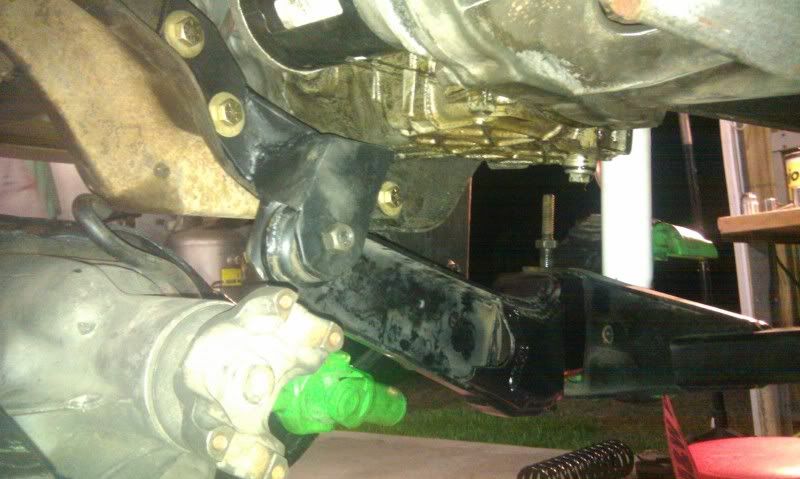

Since my radius arms ended up in the same place as my trans mount I changed things up a little bit

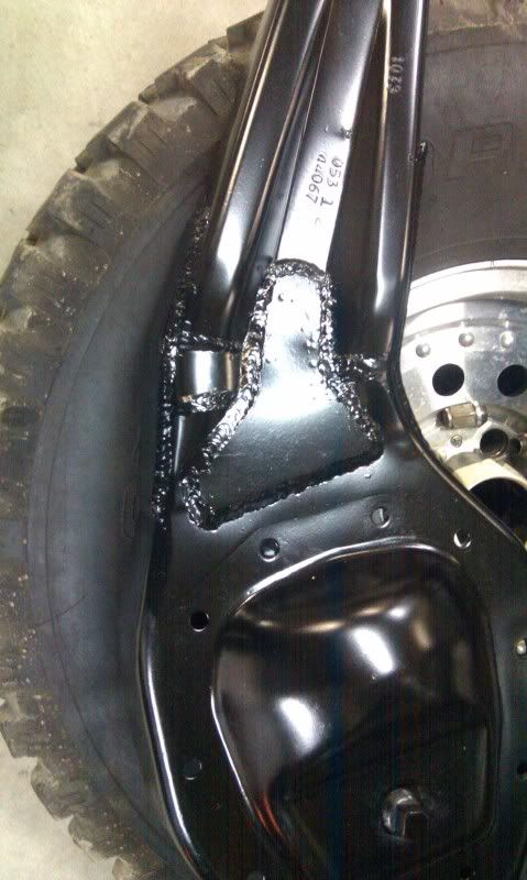

Got my BDS xj coils friday and thought I was ready to swap my cut beams in at the same time. The drivers side will be easy just have to drill a new hole in the drop bracket. The passenger side not so much. I just have the plate that drops the factory mount. I turned my beams 4inches, not knowing what my lift was. After some measurements. The drop brackets holes are 5inches. So if I have my figures right I need a 1inch drop bracket. If I remember the "hi-rider" was 1 or 1.5 inch over a base 4x4 right ?
Ended up just making a new bracket. Really it was kinda simple !
I also got my beams finished, plated over the cut and turn then a nice coat of black.
Man I got excited lastnight about the springs and turned beams then FAIL. Im not sure what but I must have measured something wrong my axle is in the bind AKA the beams might be to close together. At ride height the passenger side axle is sticking out by the center u-joint. But anyway here it is halfway back together
