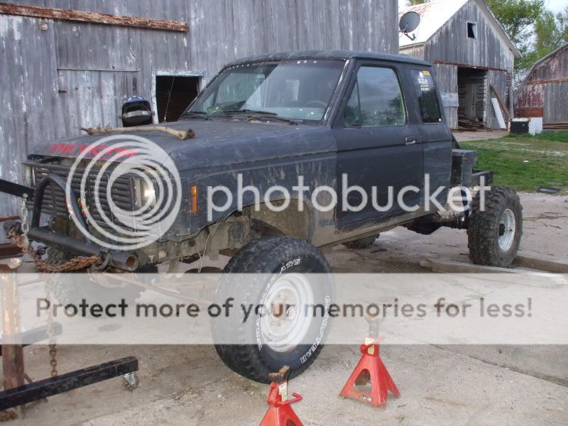

This is what it looks like now almost finished with the SAS its hard to make time to work on it when Im working alot of overtime.
This was before the SAS on the trailer behind my Xterra. Sooner or later Im going to finish the Exo Cage so I can pull the doors off and maybe cut the roof off lol.
wow thats a crazy lookin truck. looks definitly like a trail only rig haha. its cool. so i was wondering, you said you wanted to finish the exo so you can take the doors off, is it legal to take your doors off and drive down the road if you have an exocage? cuz here in washington any vehicle that did not come from the factory with removeable doors cannot have the doors off and drive down the road... sucks cuz i made mine removeable just for that reason....
